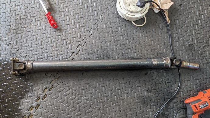

I’ve attached some pics of the new prop (I painted it to match my red differential).
Glad to say that the noises have now disappeared, so well worth doing if anyone has similar symptoms.
