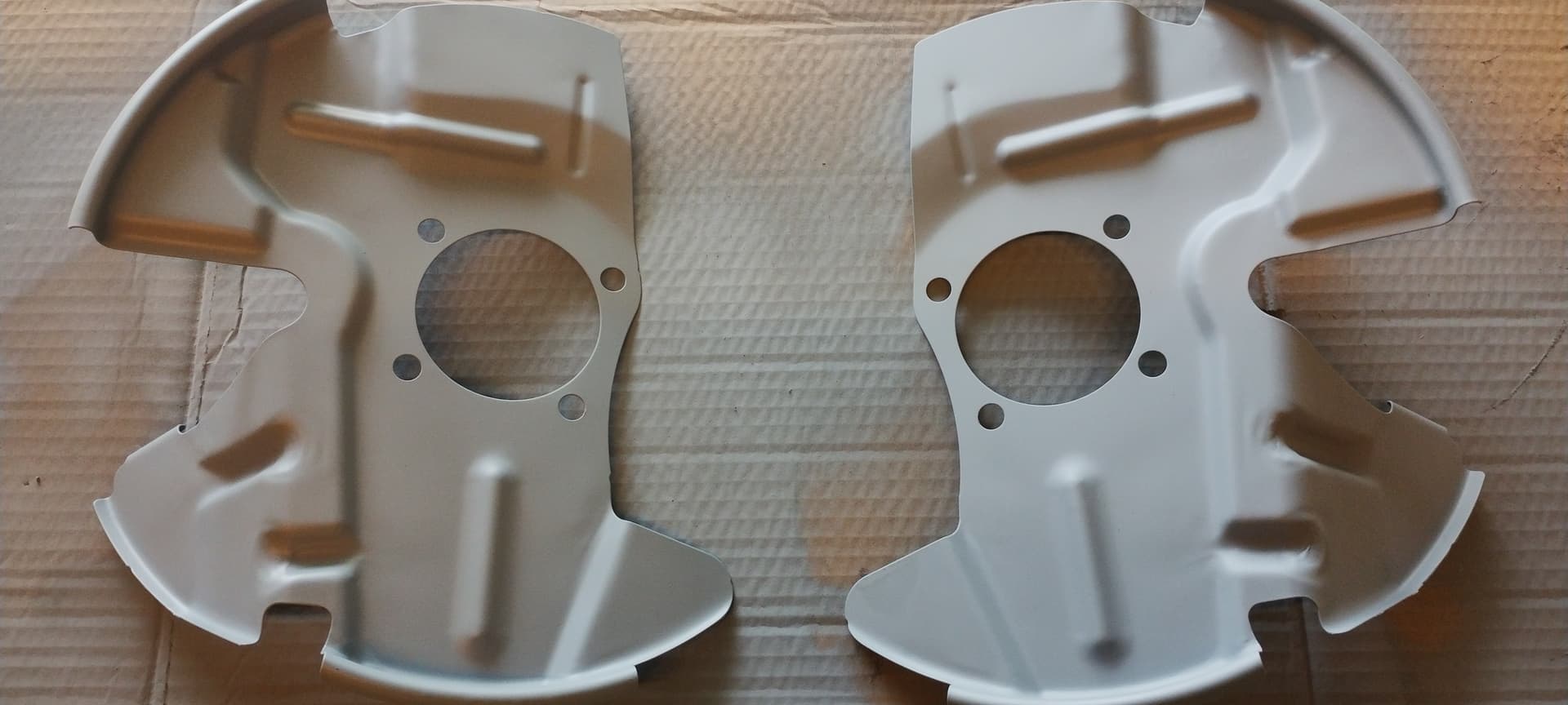

I’ve just received new front disc backing plates and before I fit them I want to see what I can do to protect them somewhat, since the originals are absolutely disgusting after 11 years.

What would you do or use to give them the best chance at longevity and staying in good condition? Was wondering what the best way to key the metal for any of the paints to bond since the plates are quite thin?

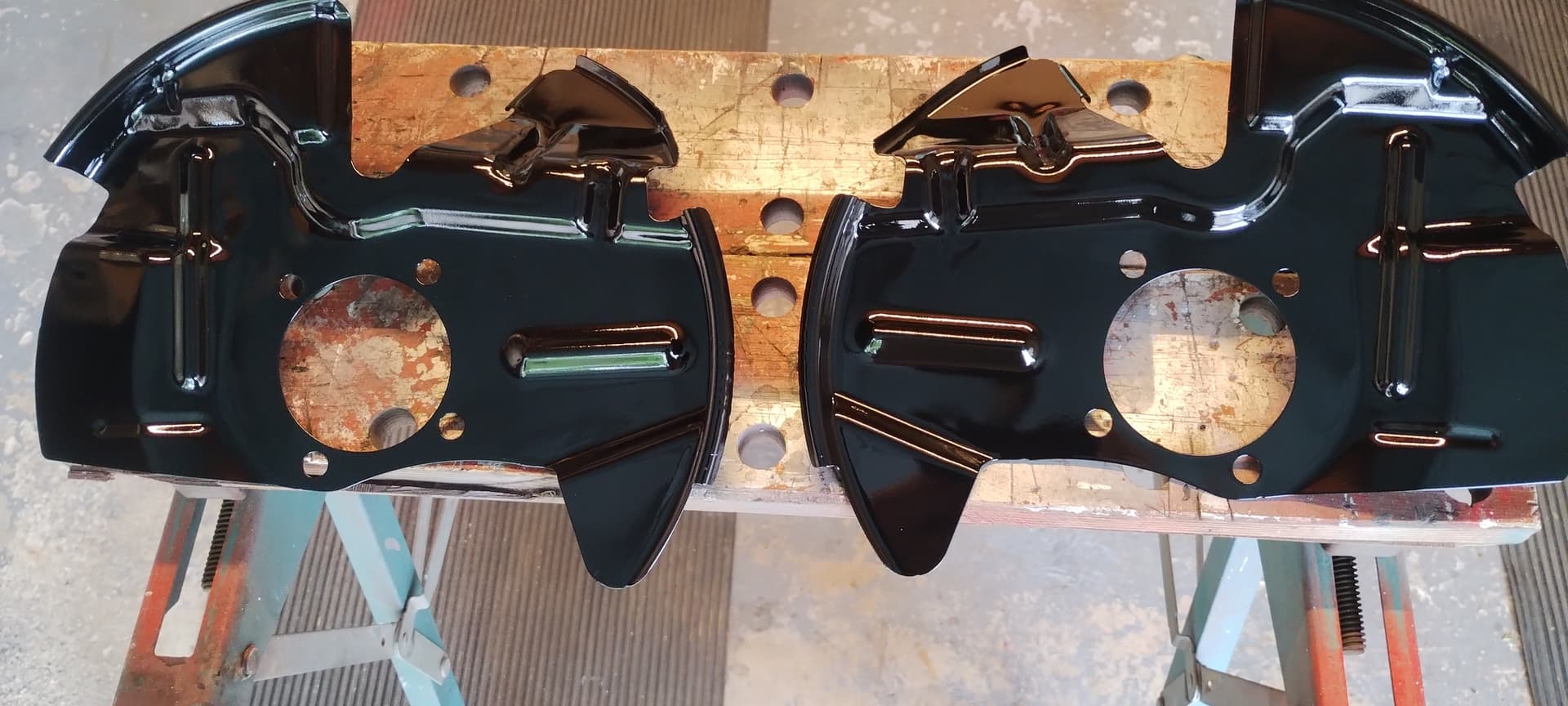

I’ve gone with the engine enamel spray, 3 coats in and looking good. Will do another couple of coats then bake them in the oven for a bit. Will spray down the backs with a bit of Dynax UC when fitting. I should/could probably have gone down the POR-15 route but the heavy rain and dropping temperatures would affect proper curing.
Forecast for the next week is rotten so I’ll ambitiously be fitting them whenever I see a couple of hours break between downpours.
