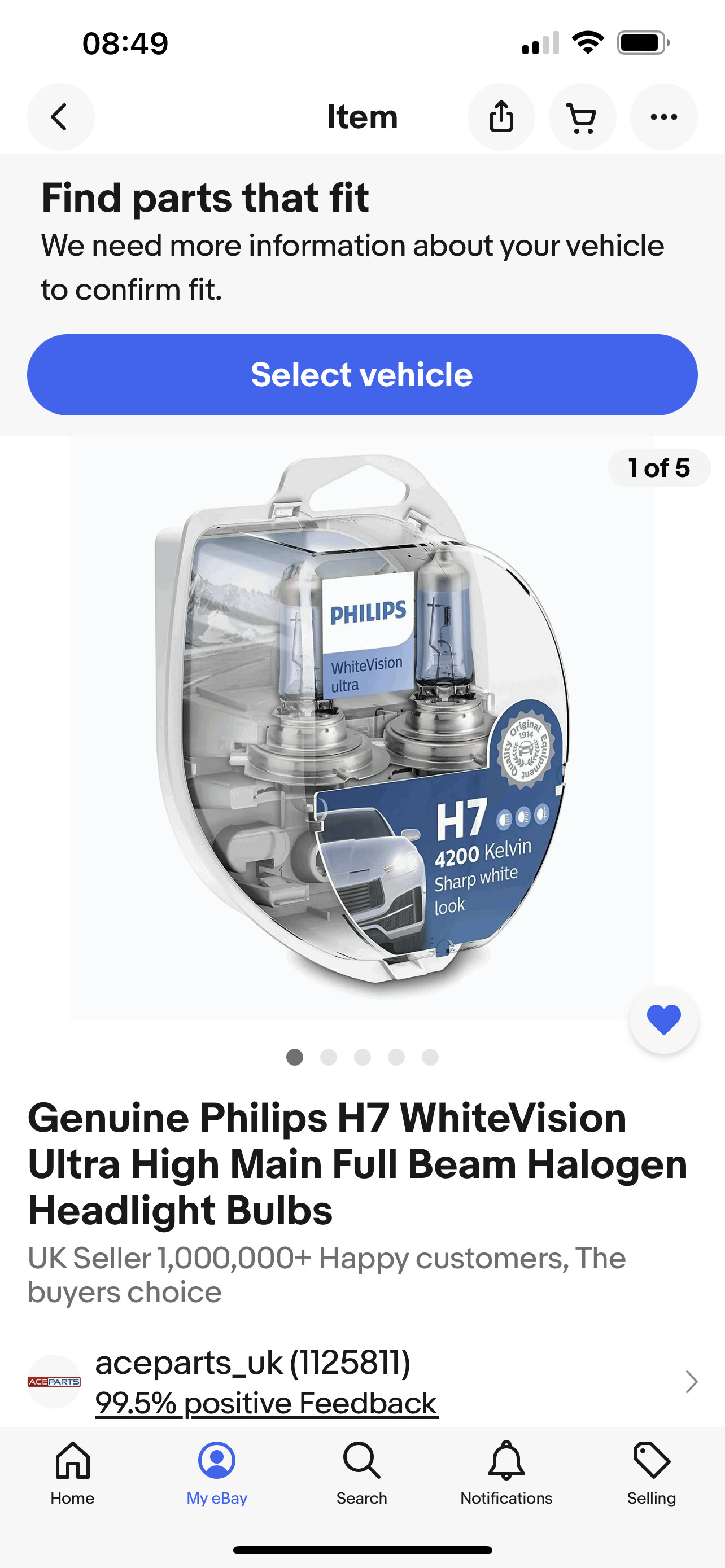

I have Osram Night Breakers in my NC for the last 2 years, its a daily driver and had no problems. I my ford fiesta, on the other hand, they only lasted a year. Ive changed the fiesta ones for the Philips whitevision which have been in for 2 years. They are much brighter than original equipment So in theory the philips will last a lot longer and be brighter.
I can also recommend the Philips White Vision which have been in the car for over 2 years.
