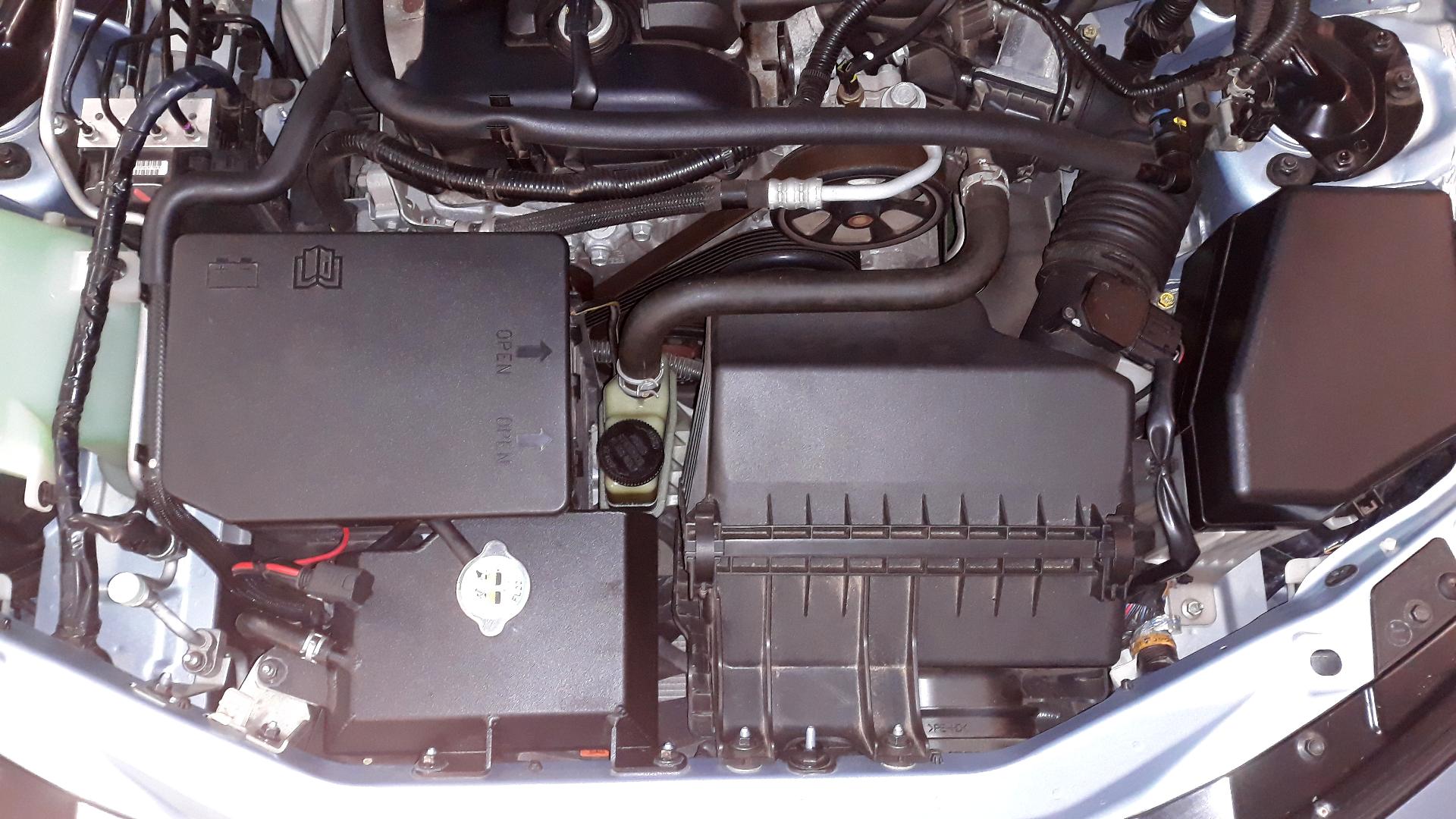

Here is a phone-pic taken just now, still with evidence of sahara dust!
