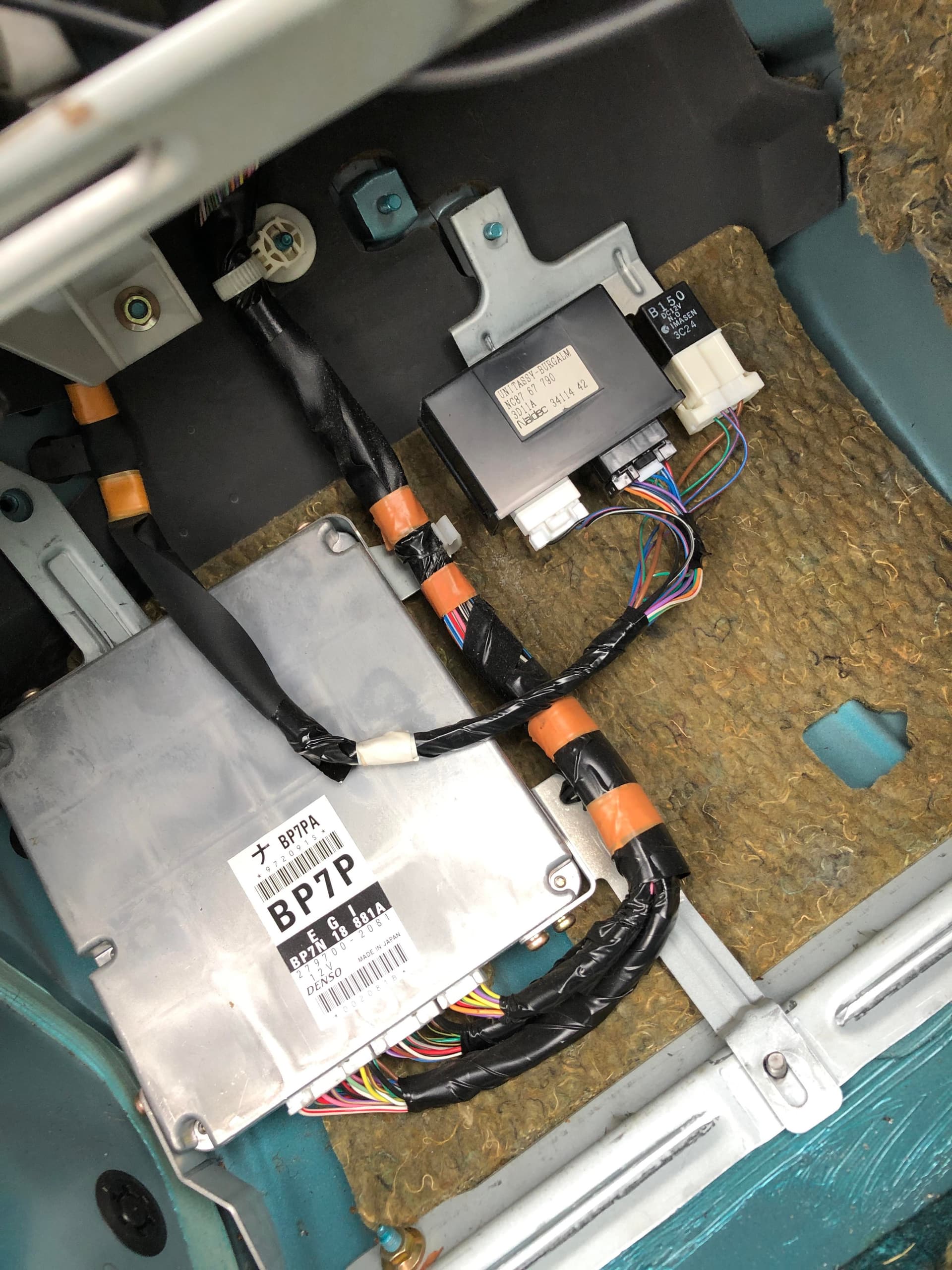

The anti-theft module was indeed right behind the kickplate in the passenger footwell. Had to drill out a couple of sheer bolts to get to it.

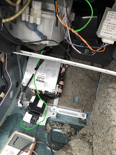

The red/white signal wire was already present in the connector, however a continuity test with a multimeter showed it wasn’t connected to the rest of loom as I had assumed.
I twisted the wires together for a quick test (green is the new wire running from the signal wire to the anti-theft, orange is the signal wire running from the keyless unit to the boot latch relay).

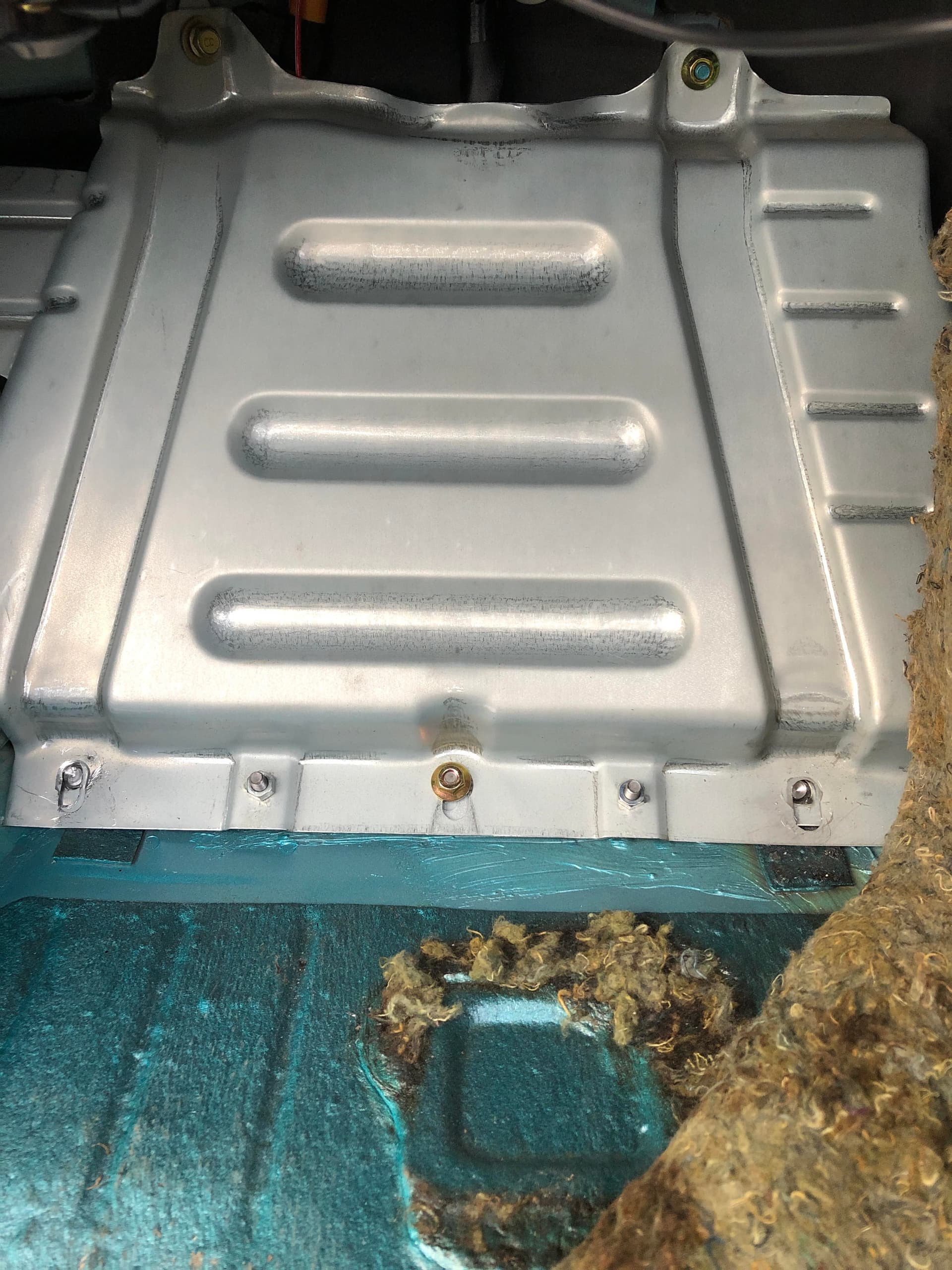

Fortunately, there are 2 threaded studs inboard from the drilled sheer bolts, so I just threw 2 10mm nuts on there and the plate is just as solid as ever.
