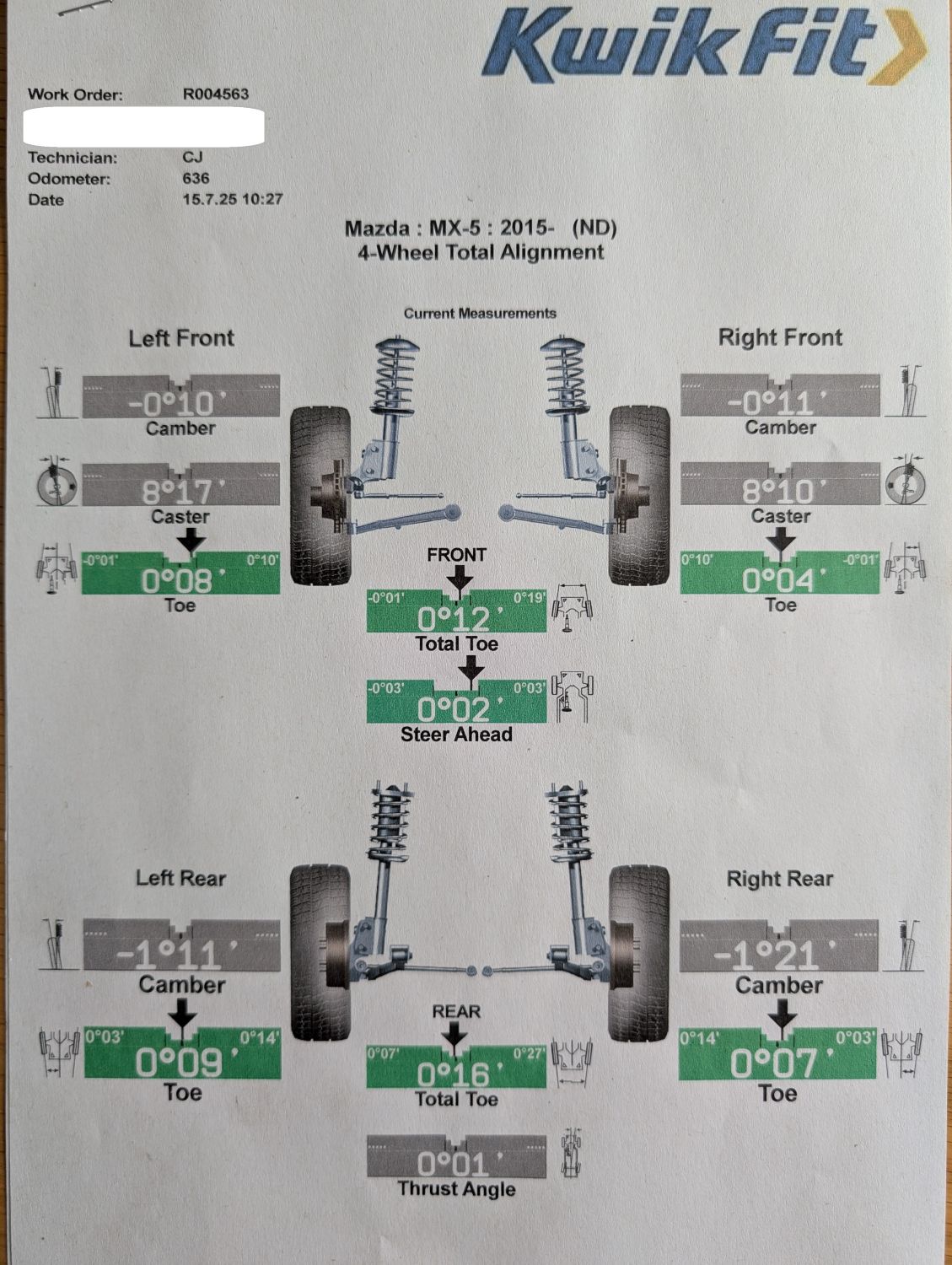

Armed with Flyin Miata figures I booked a “Reglage geometrie” at a quite well respected chain Tyre place.
I explained that I didn’t want the manufacturers figures and showed them the Flyin Miata ones.
When it was done I looked at the before and after charts and they were almost identical. I queried this and they told me that their machine would only work with manufacturers settings.
A long conversation followed with quite a lot of gallic shrugging. At first they offered me 10% discount which I didn’t think much of as they hadn’t done what I asked for but then they handed me the keys and said “don’t pay”.
So I have an appointment for next week with another outfit who assure me they will use whatever settings I want.
We’ll see.
FYI Roger

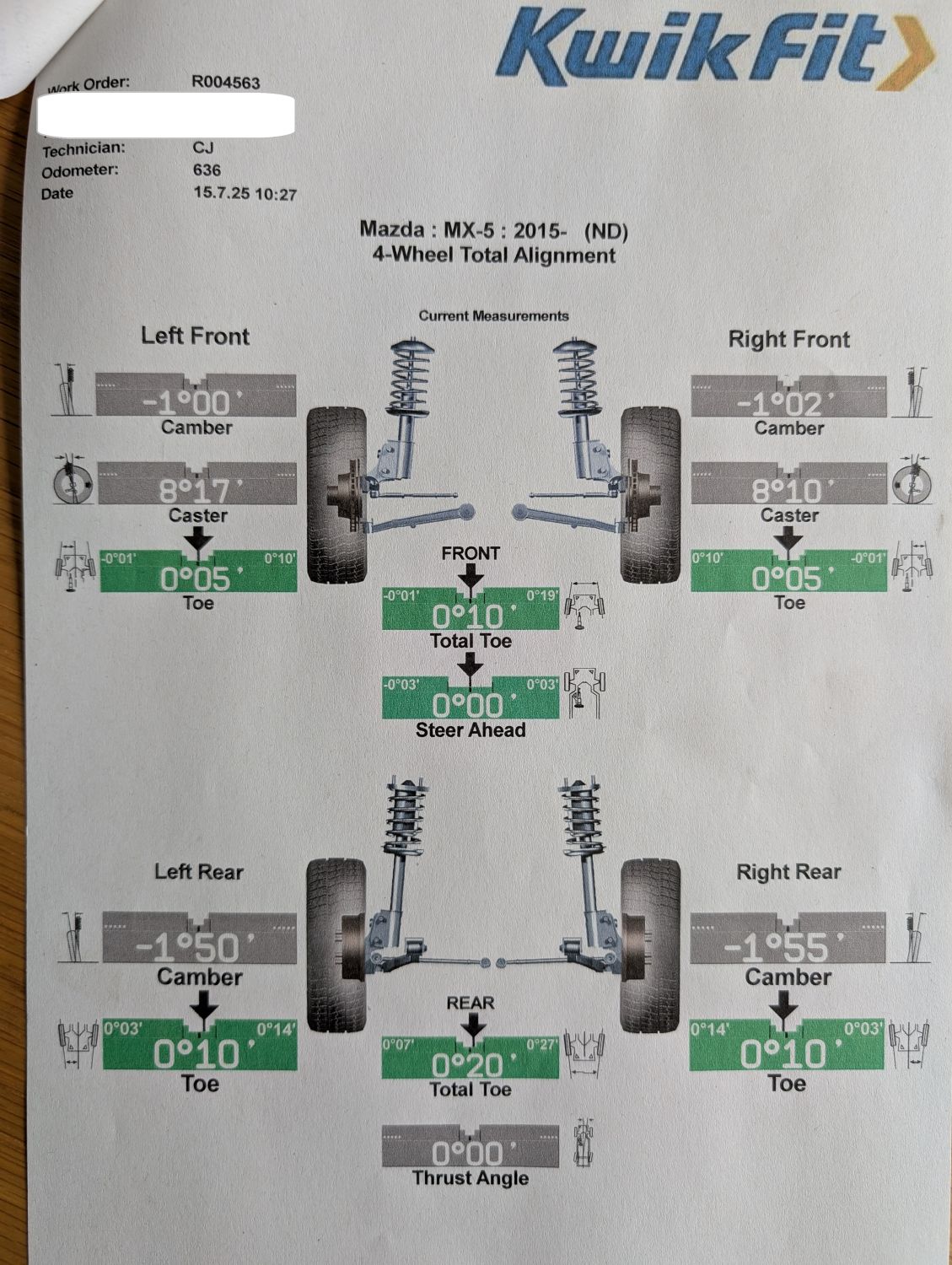

I used some settings on here from a forum member Snelly in this topic ND Alignment Spec slightly less than the flyin miata but I want a simple base line first
Filled the car with fuel and had my alignment done today at Kwik Fit. They have a Hunter alignment and happy to do as I’ve asked on other cars, so ideal for me.
Interestingly the caster was already on 8 degrees, I asked for as close evenly as possible on everything, as anything better than the before setting was a bonus, and happy to leave it like that at the moment.
Car feels slightly more pointy, which is good, and straight ahead on dual carriageway has improved too, with less wandering so happy enough, also feels a little better at dead centre, might be placebo though ![]()
