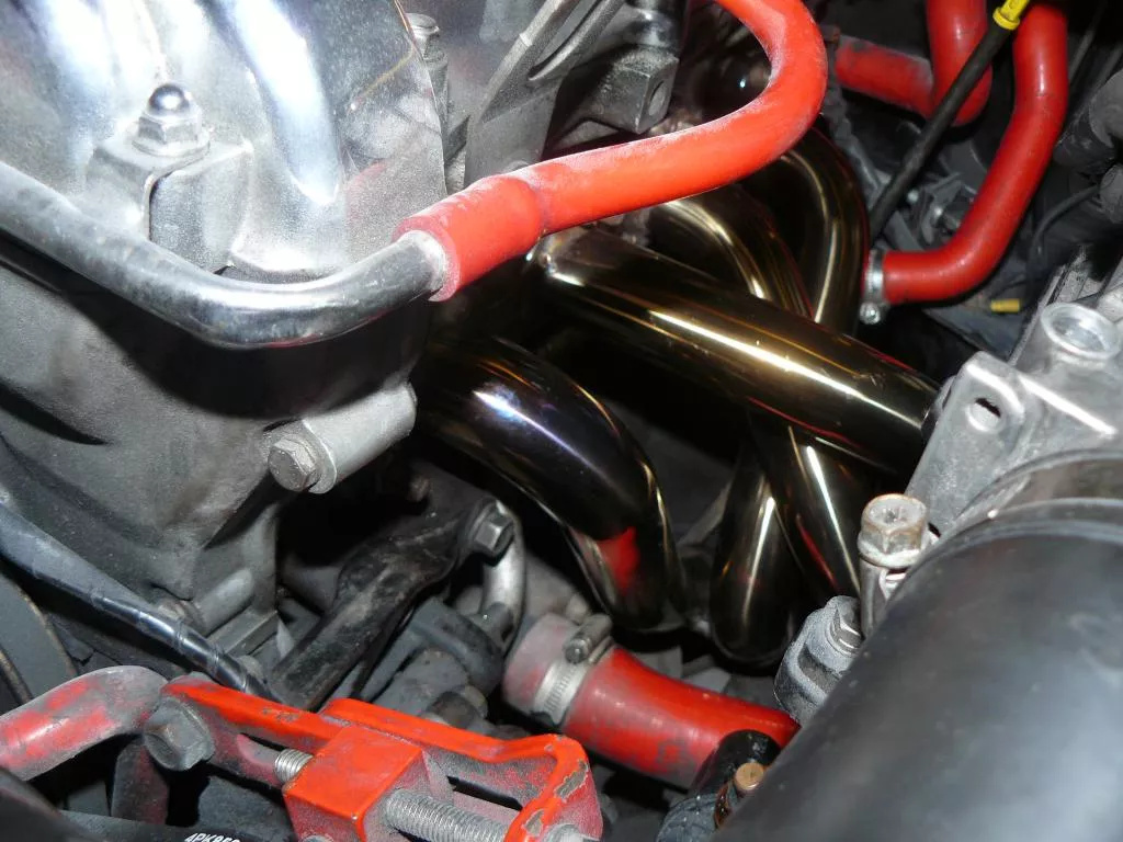

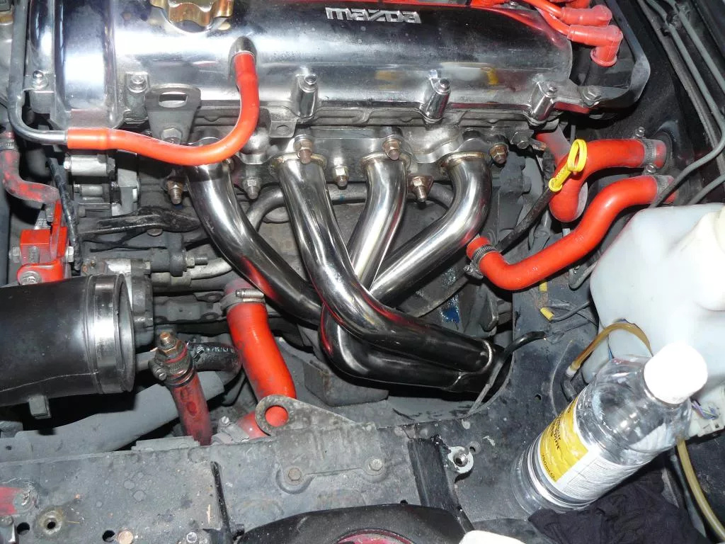

A £120 header I fitted to a 1993 1.6 Roadster.
Alcohol wash prior to fiting up lead to nice coloration that was maintained for the years I had this car.
It was from a firm in Sheffield who had an Amazon ad, but the exhaust was from China. All the Chinese headers seem to be the same.
