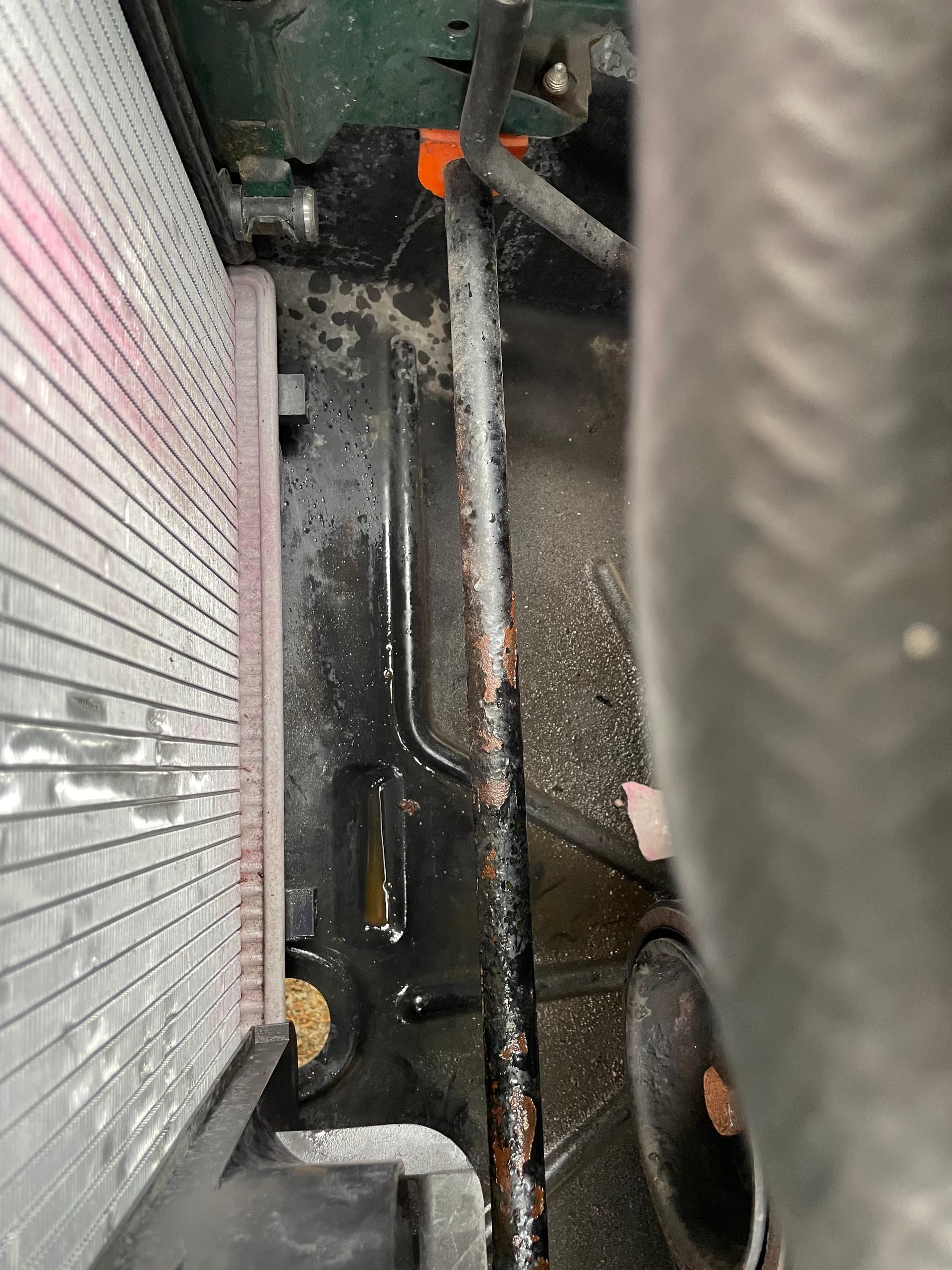

Can you get a photo of the pooling?
Robbie, this is the situation re coolant after a ten minute drive. Thanks for your help. Roger
It could be coming from the water pump weep hole. If the bearing is on its last legs, coolent will drip down the front of the engine block usually dripping from the ‘U’ shaped aluminium part behind the dampener pulley. Is it a long time since the water pump was changed?

The Water Pump is original from 1997, I have had a closer look and I think your theory is correct.
