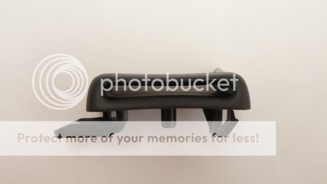

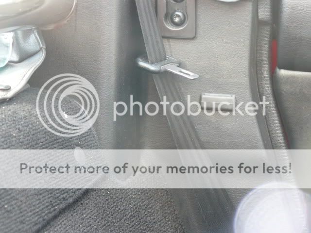

Could this be anything to do with the passengers safety belt rattling against the side of the door pillar? It was one of the rattles on my car caused by this, so I bought and fitted the belt tidy that are fitted to the Mk2 version.

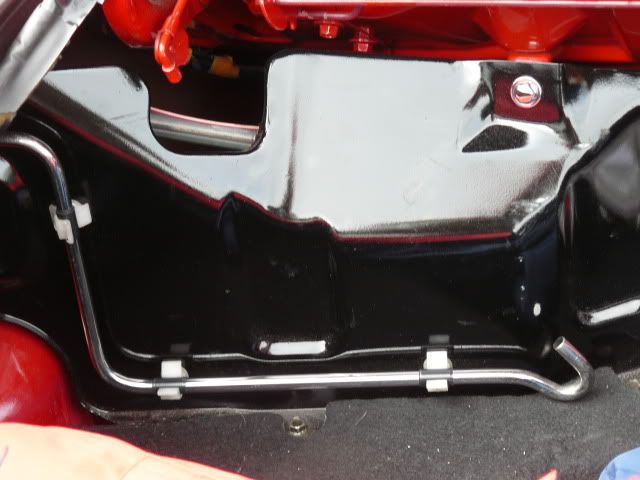

I thought it was the safety belt hanging loose as it hadn’t been put back into it’s little tidy thing. On the way home it started to rattle again so I stopped to check inside the boot. Although the lifting jack handle was in it’s place in the three clips it wasn’t tight in the clips and neither were the clips in the panel. I took them out of the panel and while driving home I didn’t hear the rattle at all. Can you try the same on yours and let me know if it works for you?

This has stopped the rattle behind the passengers seat. Wrap insulation tape around the jack handle at the point where it contacts the three nylon clips in the boot.

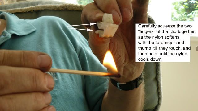

Further to the above reply written by me, I have found probably are neater way to fix the rattle of the jack handle in the boot. If you remove the three nylon clips and warm up the nylon clip at the point shown in the picture just enough to soften the nylon you can then squeeze the two "fingers " together until they are touching. Hold the clip in this position until the clip has cooled down then replace them on the steel shield. You should find that the handle is now held in place and doesn’t rattle.
