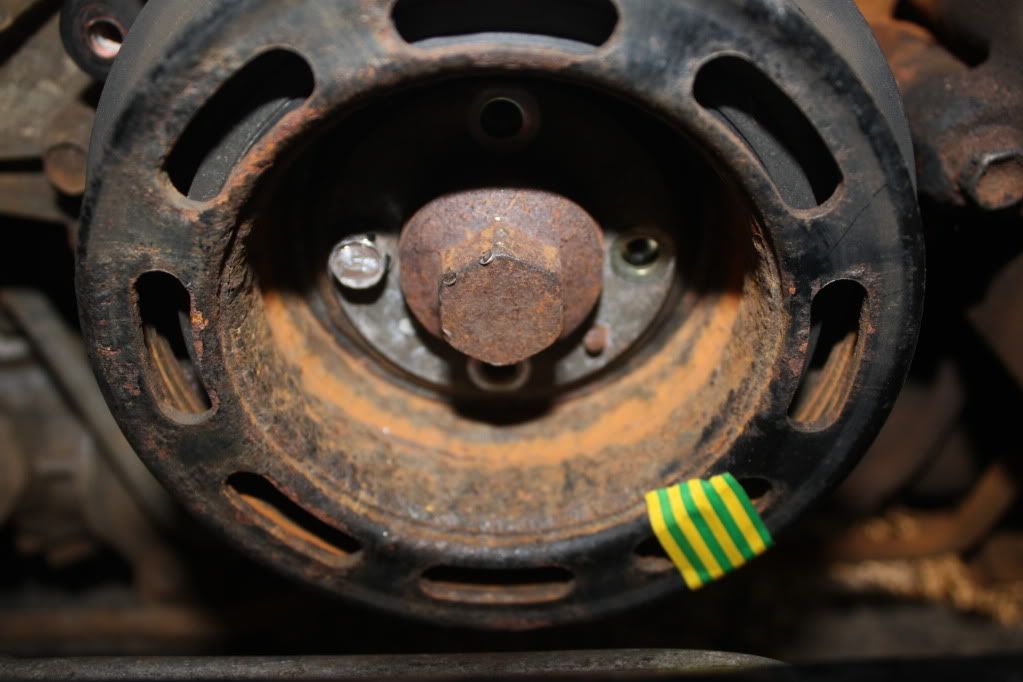

One of the four bolts, fixing the crank pulley is rounded off, and I cant budge it… bloody idiots who touched ot last. No room for a spanner, a stud remover, or a drill to make a hole for a stud extracting screw…
Cant even get a grinder in to grind it off…
Sorted, a knock on the socket, gave it just enough grip to turn…

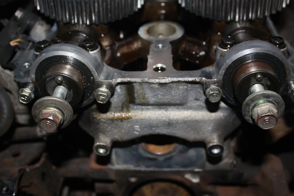

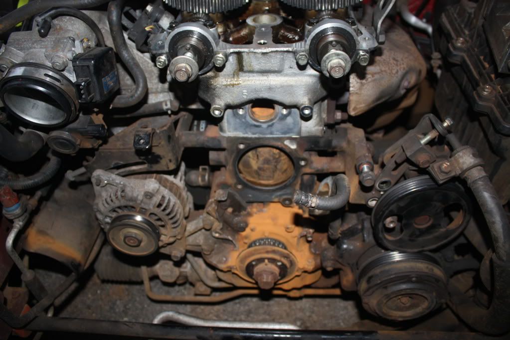

Thermostat housing, water pump and pulleys removed. New camshaft seals fitted…

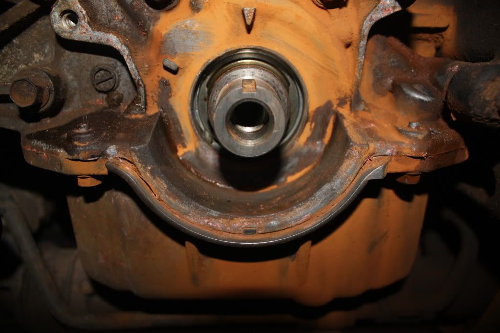

Crankshaft seal removed…

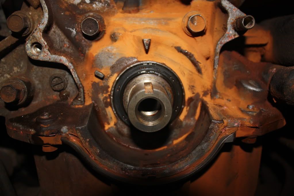

New crankshaft seals fitted…

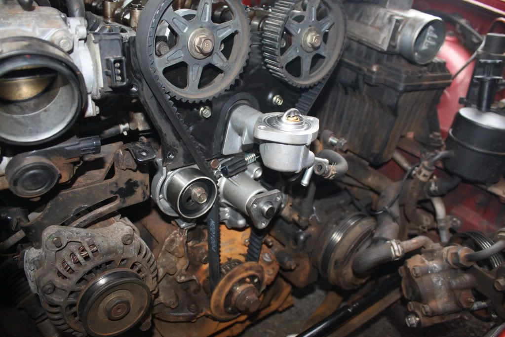

The job continues… waterpump and thermostat housing fitted. Cambelt temporarily fitted to keep it out of the way…
More work tonight if it doesnt rain !!
