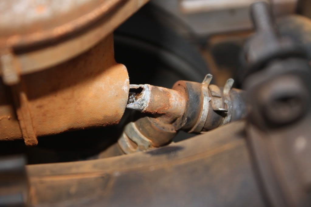

Well, my slight leak has now escalated into a full blown loss of coolant…   My water pump has been growling for a few months now, and as I dont do many miles in the old MX, I left it, and turned up the radio…Cool  I’ve been topping the system up as I drive, and had only noticed a few drops round the bottom of the timing belt cover…  I was hoping the water pump would hold out till June, so I could spend a whole weekend, with my spanners and several cups of tea, replacing the pump and timing belt…
Today, after picking my lad up, and after adding a pint of water to the system, I smelt steam from the front of the car…  Pulling onto the drive it was a full gusher…  Saw that the small metal pipe leading off the lower thermostat housing had corroded clean off…!!   Ordered cam belt,water pump, lower housing etc off mx5 parts last night…over £150 …

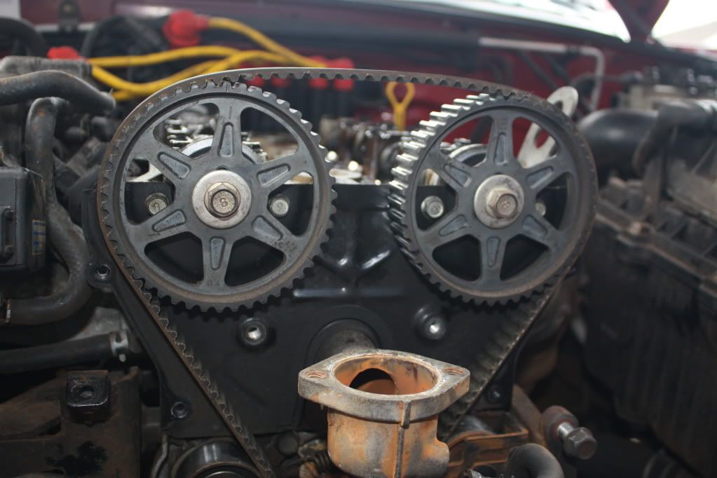

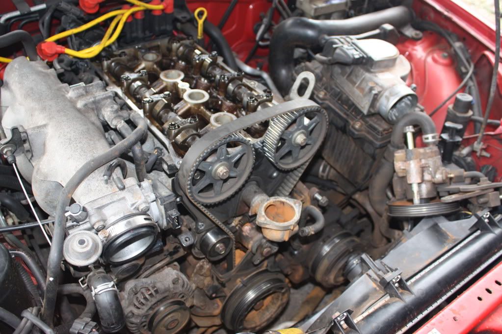

Well, jobs going well. Only problem is I cant find my half inch ratchet…  As you can see, the rust is because the coolant was sprayed out by a rusting pipe.
One worrying issue, is that the cambelt, although still under tension, appears to be very stretched, and loops out between the two cam pulleys. This will make the timings slightly out when running, as the belt stretches taught. Good job I bought the whole cam belt replacement kit. as well as the waterpump and thermostat housing. The waterpump bearings are shot as the shaft can be wiggled about. It was squeeking and leaking, so off it goes to the scrapyard.
