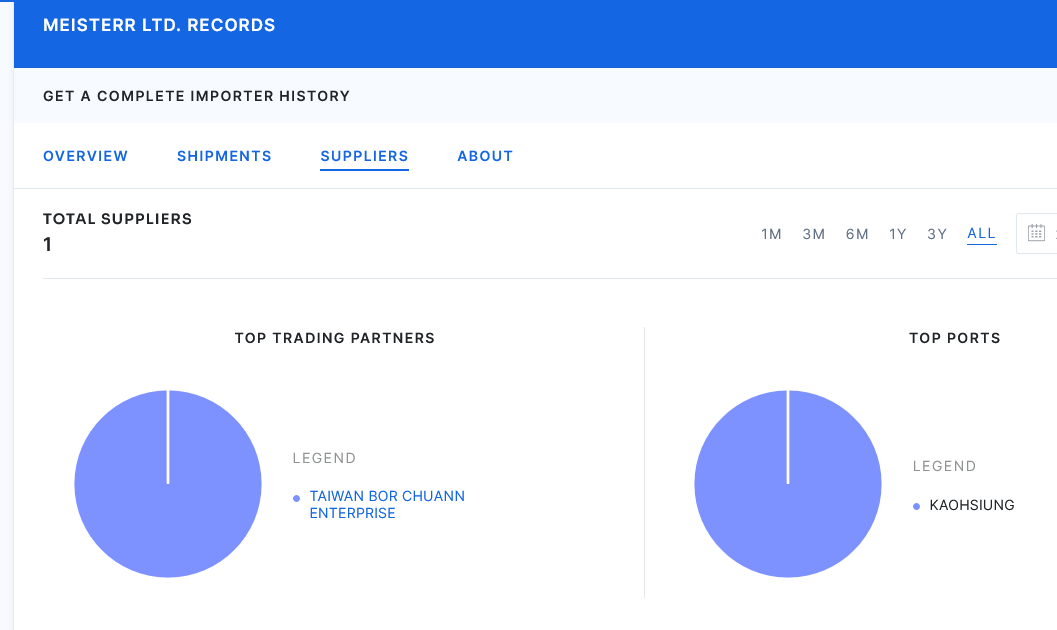

I think very similar
Interesting that they refer to origin as China Taiwan.
Most Taiwanese would probably beg to differ.
