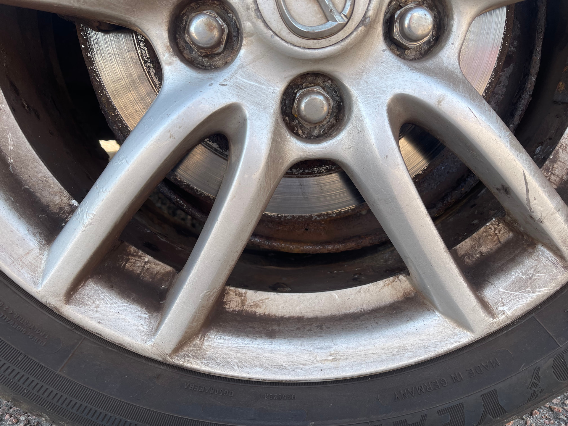

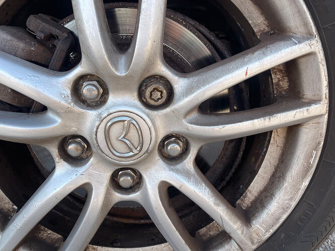

  3. I’m looking for technical help or recommendations on: __Does anyone know if the rear brake dust shields are really necessary? The car is a 2012 Sport Tech PRHT and I bought it a couple of years ago with 38k on the clock. As far as I know it had been well looked after and according to service records it hadn’t had any major work - just regular servicing - and no mention of rear hub replacements. This year I completely refurbished the brakes (calipers, discs, pads, braided hoses) and at the same time I did the usual thing of tidying up the tatty front shields. I then noticed that the rears didn’t have any at all! Is this normal for a 2012 Sport Tech?

Hi, sort of a related question, on my 15 year old NC with 90k miles, noticed cyclic sound from the passenger side. Looked closer and there’s a bit of something LOOSE behind the rear brake disc, can move it around by hand. Does this look like a rear disc dust cover that just rusted away at joints and now the outer rim part is simply hanging in there? Can I remove it without taking the wheel / hub off?
Looked on the forums and judging from servicing videos it might be costly labour-wise to properly replace them yeah? (needs hubs taken out + care around the wheel sensors)
