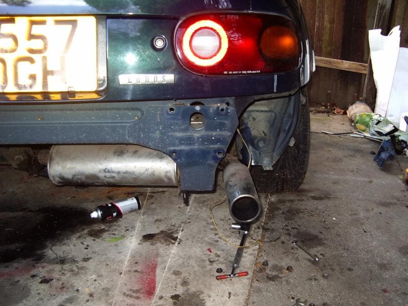

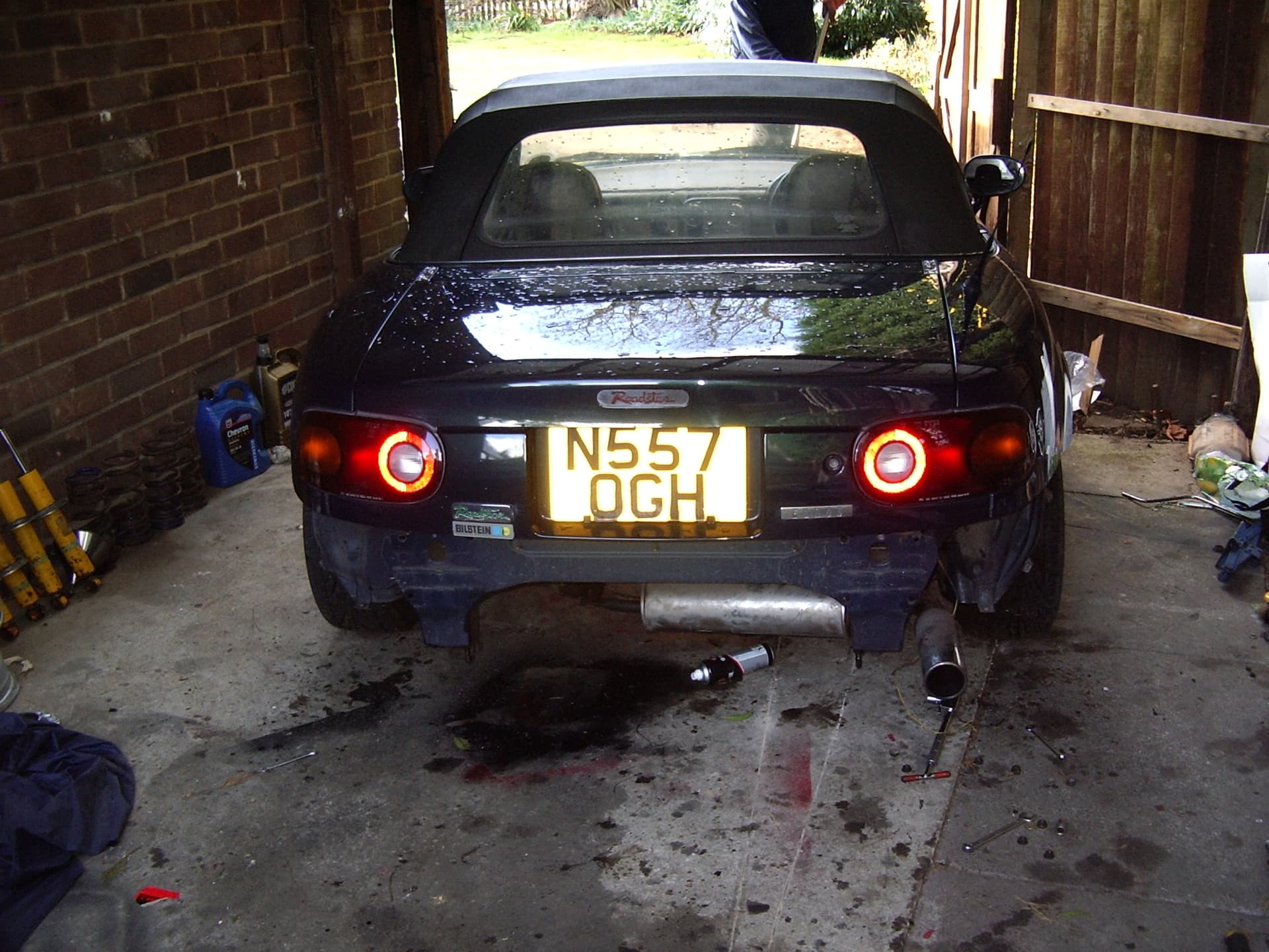

Its not mine Ste, its a 1.8 red badge S-spec in laguna blue that is here for re-build for Autolinkmx5, the full renovation is on menders forum to view if anyone is interested.
The condition of the underneath is the norm now and far far worse in many cases i deal with as these get older that we end up washing out of our hair , ears etc.
She was just conveniently sat outside on stands stripped down to nip out and take some pics for a quick guide for you.
I am sure it will help others in the future buddy.
