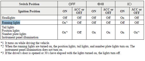

Here’s what the Mk4 manual says about DRLs.
DRL Mk4
To try and answer your questions
Are the rear DRL’ s on the mk4, a separate light fitting?
They appear in a circle in the same place as the tail lights.  They might be the tail lights! (see above table)
do they just utilise the existing rear lights?
Possibly.  I can’t tell without an assistant, especially as the car has to be moving before the DRLs come on!
OP, you say when side lights switch on, they go off, so no rear lights? Did you just mean the DRL’s go off?
The DRLs (at least the front ones do) go off when the lights are on - see table.  There is no circumstance where the vehicle is moving and there are no tail lights.
Are these rear DRL’s brighter than normal rear lights like the equivalent front DRL’s are?
Well they are certainly not as bright as the front DRLs.  Hard to say whether they are in fact just the tail lights and/or whether they vary at all in brightness from them, unless one could watch somebody driving the car and switching the lights on to see what happens.
Best I can do I’m afraid without driving up and down the road operating the light switch with somebody else looking at the lights.
