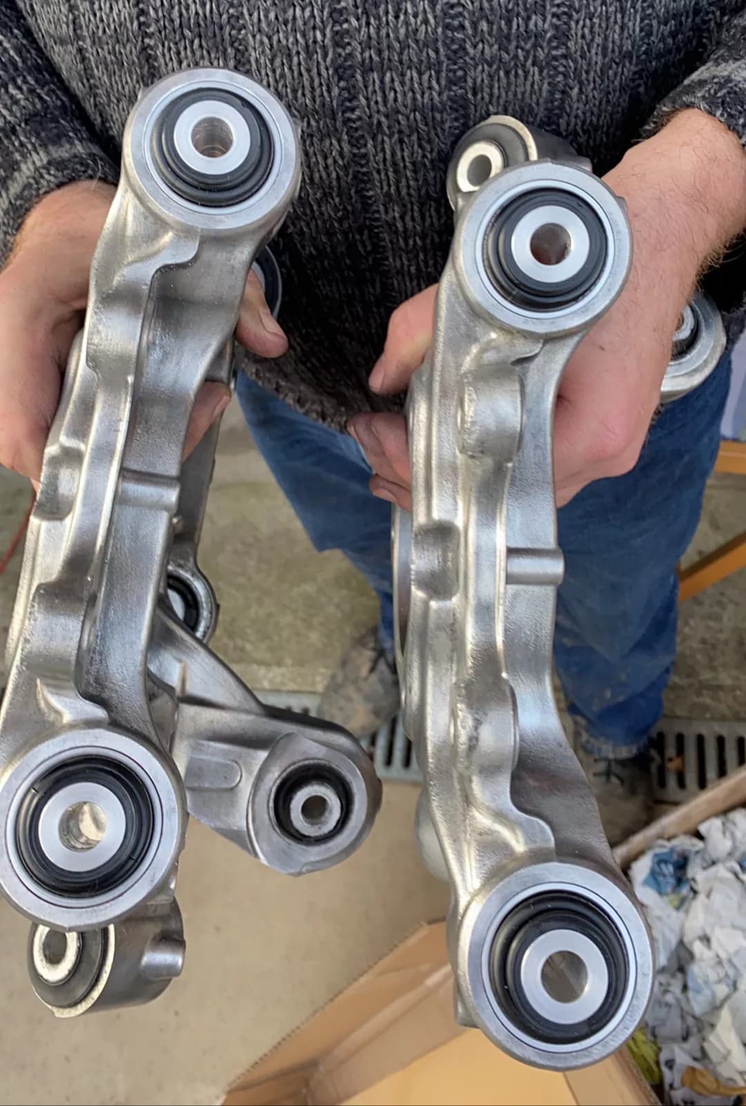

Are these your hubs?
That looks like say £850 with post for two.
I assume the hub would need to be completely removed from the car to change out the bearings?
I suppose that price for the bearings, etc is acceptable if it completely resolves a problem that new Mazda hubs would not.

With the tool Andy supplies the hub doesn’t need to be removed to replace the bearings, hence a good saving in labour costs or if like me you are quite handy it means you can do it yourself at home.
