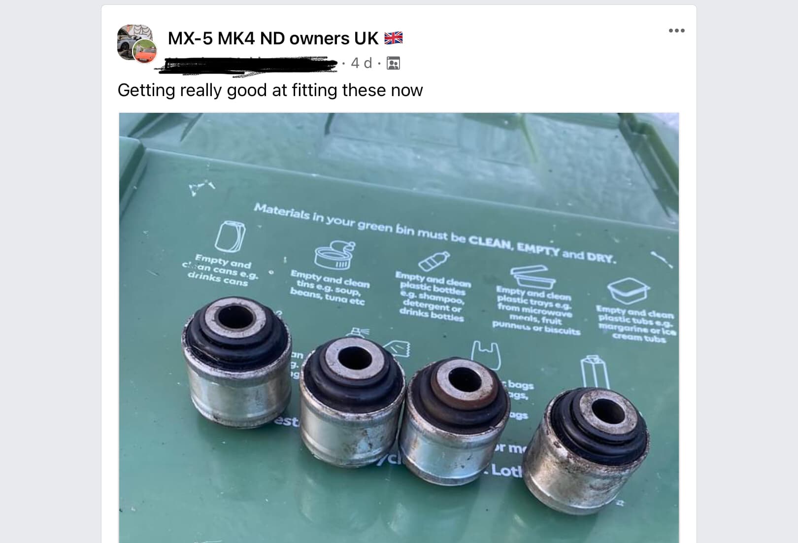

This post on Facebook is from someone in Central Scotland, not sure on what basis they do these, well worth a look though.
I could be wrong, but I know who that person is and i think they are fitting the Andy Leslie replacements (they are uprated bushings that he provides a removal tool with), but if the OP is under warranty he should 100% be expecting a replacement under warranty FoC.
