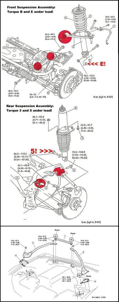

Just a thought - after the new suspension was fitted - did all the suspension pivot/adjuster bolts get undone - and then re-fastened with the car sitting on it’s wheels ?
If not - then you will have introduced twist in to the bushes that will be pushing the car up.
Thanks for the suggestions.
I’d disconnected two of the arms to install the shock, installed the shock and reinserted the arms and nipped up, but not tightened. Dropped the car back onto the ground.
When I realised the car was sitting too high, I raised the car, loosened the others off an dropped the car back onto the ground and sat like that for 2 days. I even disconnected the ARB drop links.
I heard back from MeisterR so will try that again, let it all reset, although access on the ground could be difficult, I don’t have ramps. Just jack and axle stands.
"Have a check with this bushes to make sure they have their bolt undone. Then re-tighten with the wheel on the ground. That is the biggest cause of the issue you see.
Also, check springs preload. They should only be loaded 2mm."
