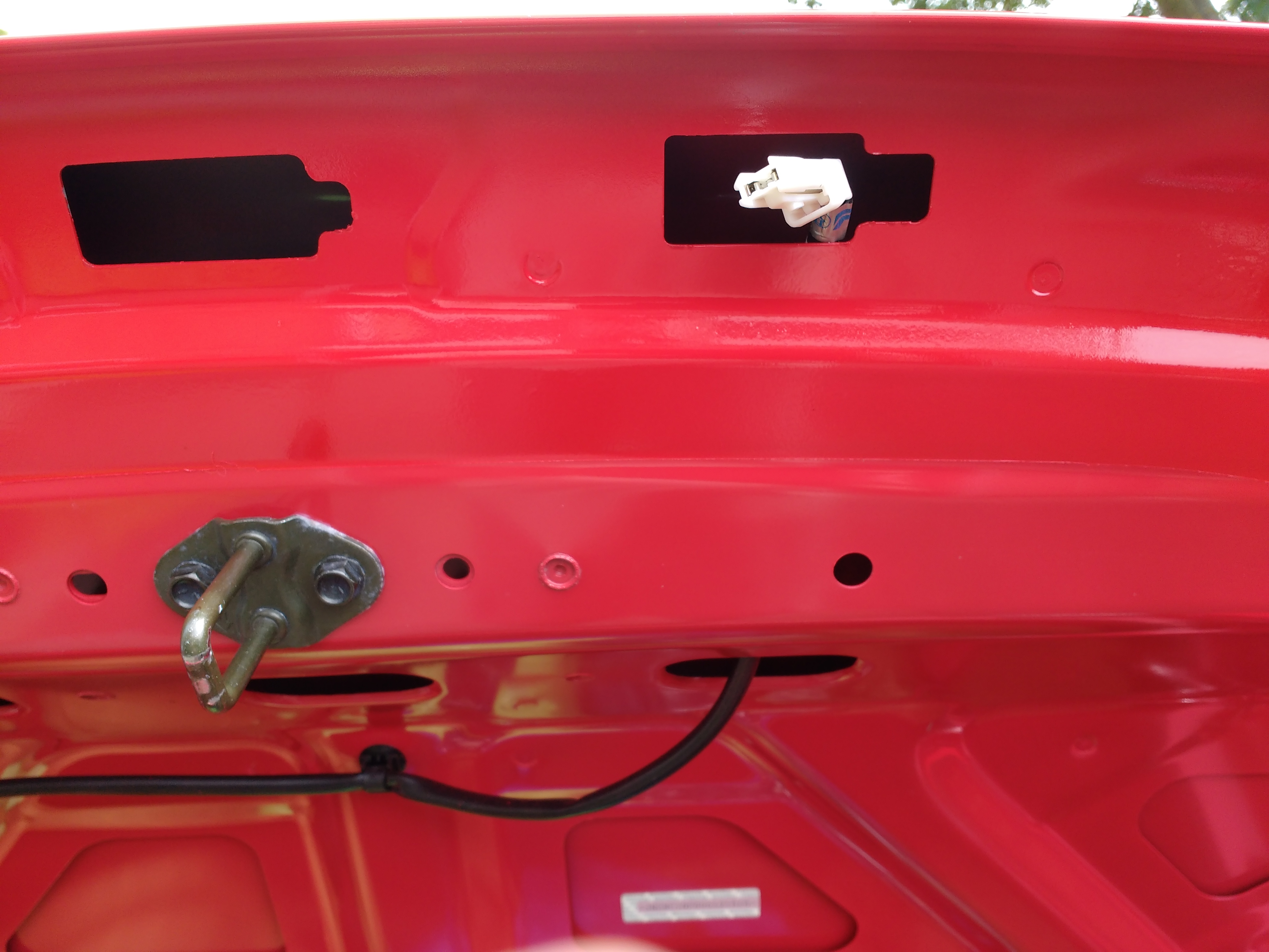

Basically as above poster has said you push the clip in from one side and it releases the unit, rather like the side repeaters. Get an old credit card or thin blade behind the unit to release the clip, go gently it’s all plastic.

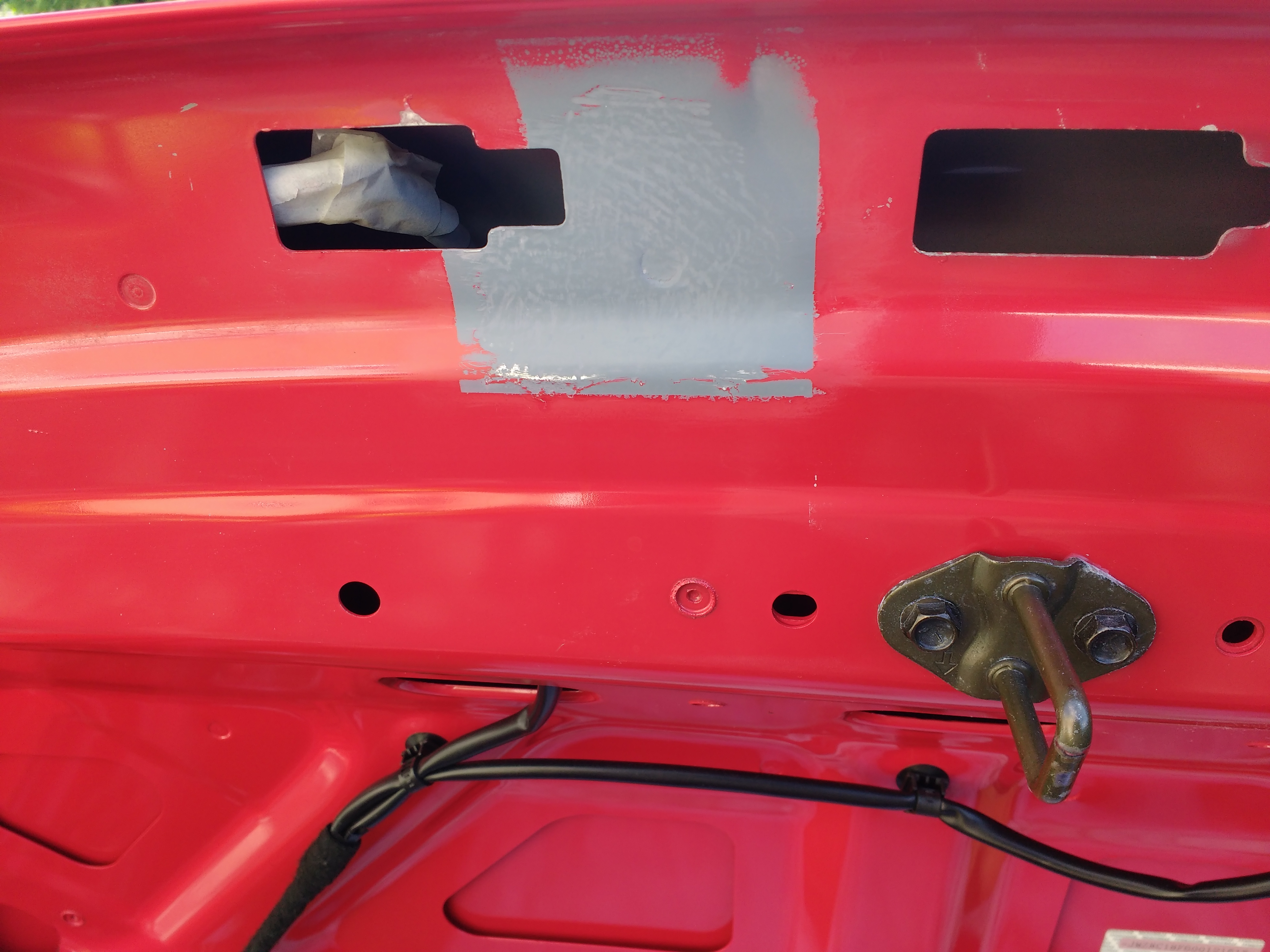

A couple of pics from when I did my boot lid. If you notice both left and right lights fit in the same orientation, so does the centre blank. If I remember correctly you push your thin tool/blade under from the left as I explained above and it should pop out.
And just to add, it won’t be rust if you have the soft top version, the boot lid is aluminium so just clean it up, prime and paint.
