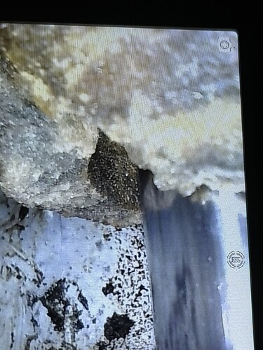

For a few weeks I have had the metallic knocking from the offside rear, which having looked up there with my inspection camera, discovered it is a worn and split Bump Stop.
There is also oil mist around the Bilstein Damper, which most likely means I will take the hit and replace all 4.

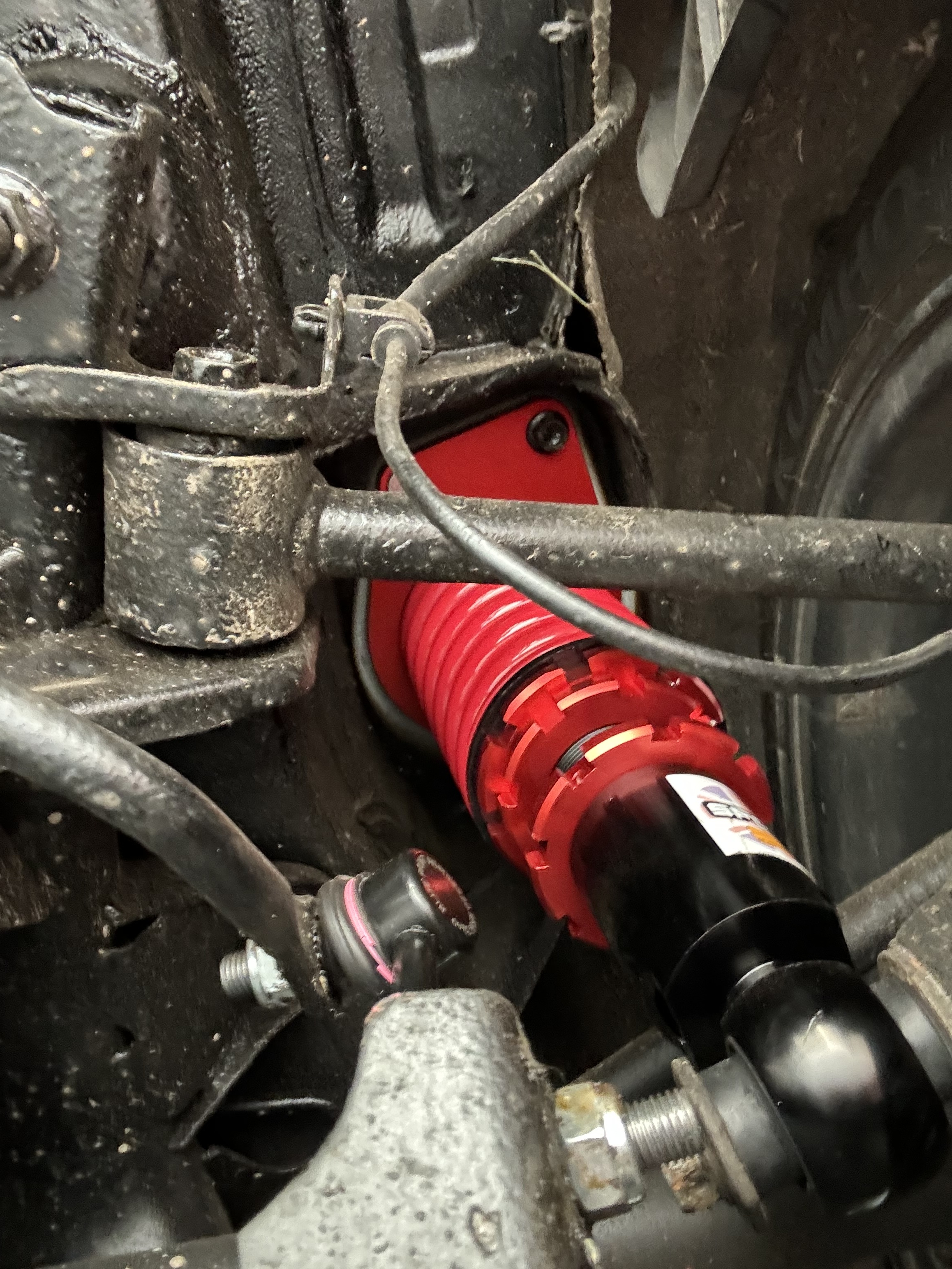

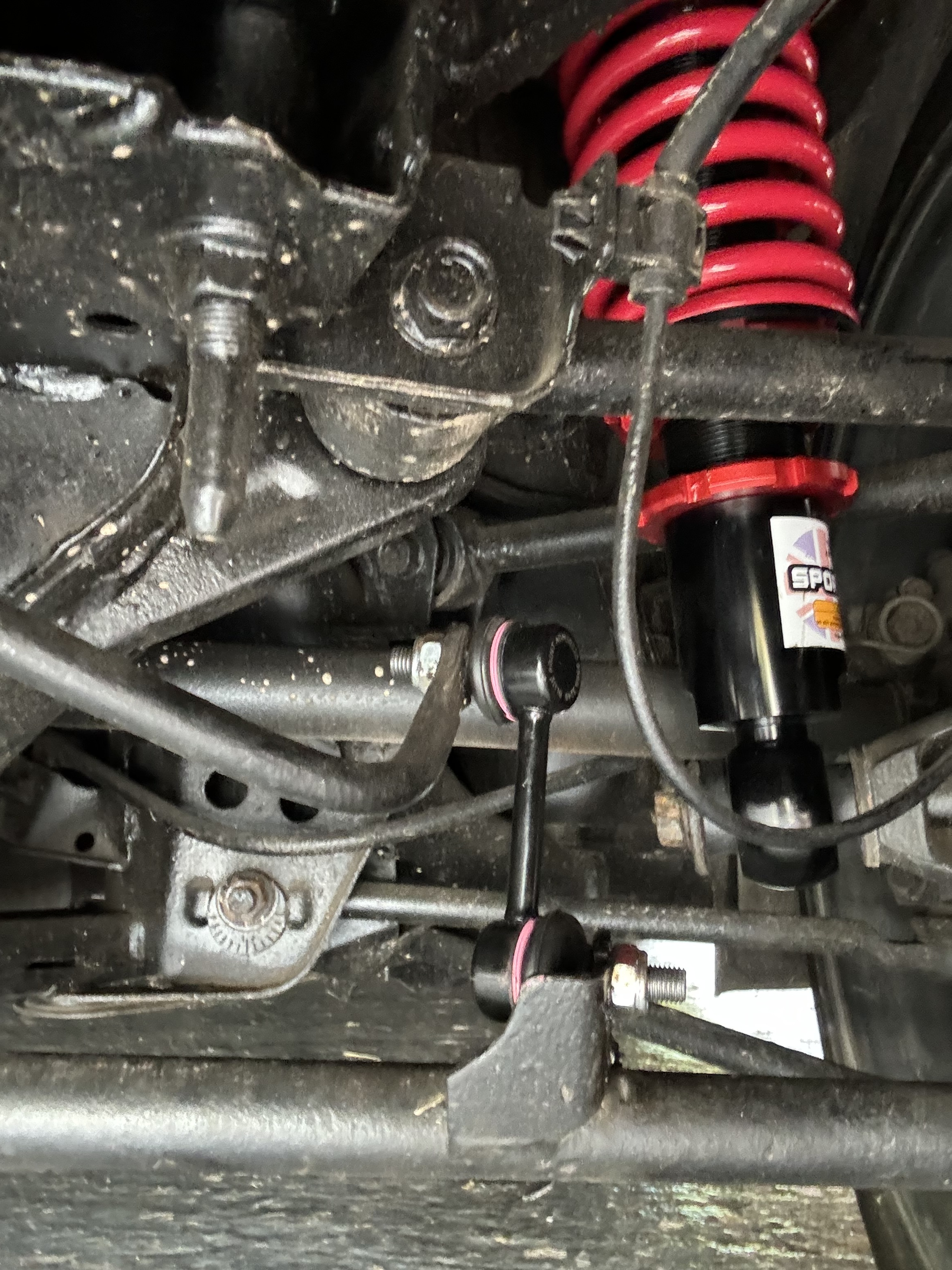

Sport Black in at Roddisons today for a full set of MeisterR Sportive’s, Tracking and a pair of rear Drop Links.
All completed by Paul and his companion within 6 1/2 hours. Great improvement on handling and so much more responsive.
Great recommendation from you all.
