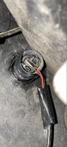

My Mk3 has just developed a fault on the rear parking sensors. Previously they worked fine, but in the last couple of days are emitting a constant tone when selecting reverse.
I’ve tried the WD40 clean, but to no avail. I’ve also looked behind the rear bumber for anything obvious, but all looks fine.
Can anyone help me with my next course of action? Can they be reset? Can I work out which, if any, are faulty?
Help…Thank you.

I disconnected my rear sensors this year, those look aftermarket ones on your car. Mine had covers over the rear to stop muck getting in (factory fitted) yours may have dirty connections.
That bit of tape looks wrong, a bit of a botch-job. There could be water, dirt, something affecting the sensor or the wiring.

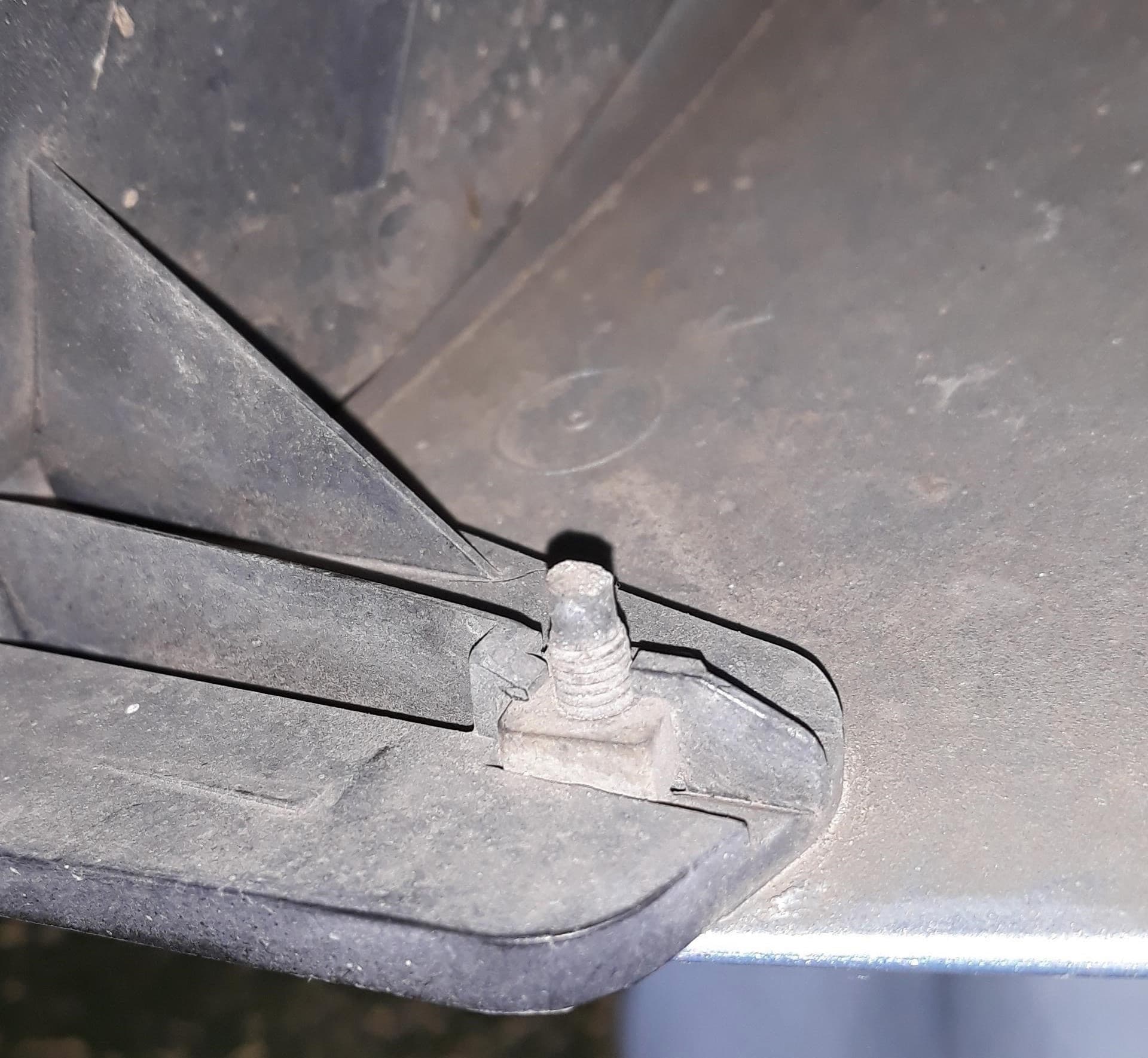

I found the ‘captive’ square nuts can be held in place by a Visegrip. Here’s a pic of the driver’s side nut and some surprisingly clean thread of the bolt. But this still needs Plus-gas and wire brushing.
