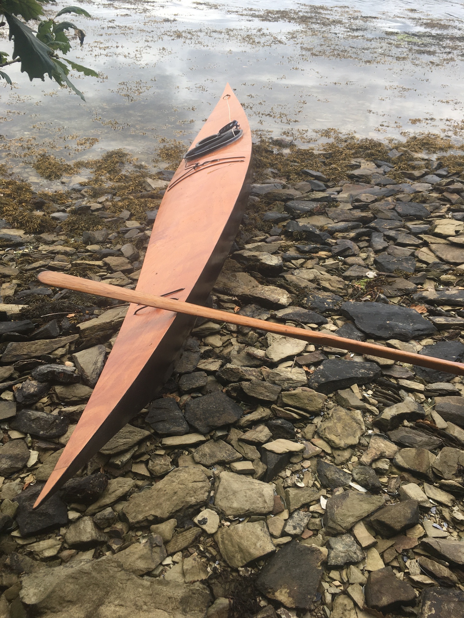

I know the feeling. I bought three sheets of marine ply and some epoxy and turned it into a a 13kg kayak at the start of Covid. I paddled it for two years then dipped out when I reckoned I couldn’t rescue myself if things went wrong.
It’s been sitting about for another two years as I can’t bring myself to sell it.
