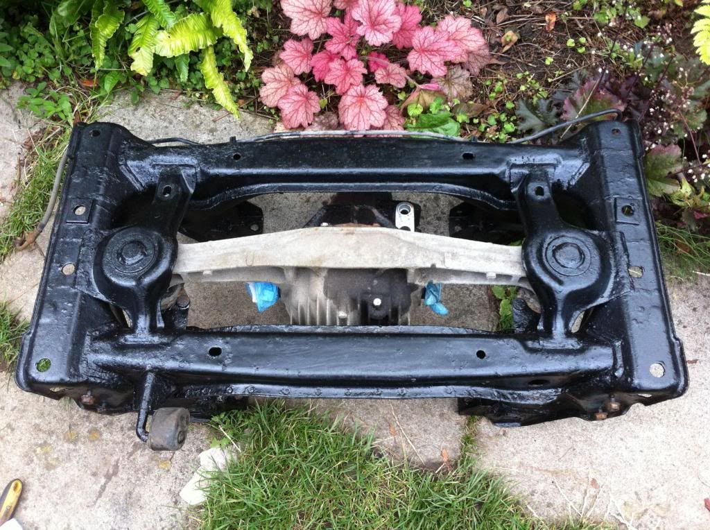

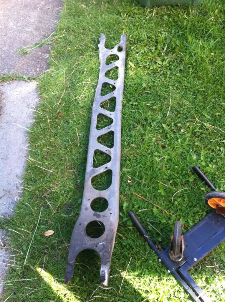

Found these while I was digging around! This was from the subframe swap I did on my Mk2, but it’s exactly the same as the Mk1.
