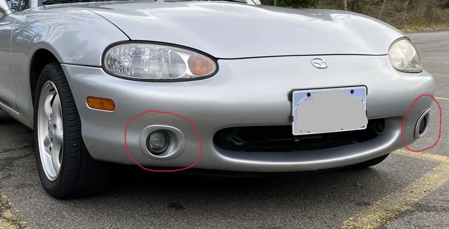

I’d guess that it’s the fog lamp recall.
My car was previously a main dealer demonstration car, and one of the very earliest Mk 2s made. Being pre “facelift” there was nowhere for front fog lamps to be fitted.
They were available as an accessory.
The Sport special editions had them fitted.
There was also a central door locking recall for accessory fitted alarm systems.
Cut bumper to fit
On the inside of the bumper, there will be cut marks moulded in as a guide.
Why would there be a recall on an accessory?
Technically, the pre-facelift cars were not subject to the recall, but Mazda’s systems picked them up as requiring it. The rework involved checking if fog lamps were fitted (fog lamps were standard fit on Sport NB facelift and available as an accessory on non-sport models) and if so, putting a wire clip on them to prevent the bulb from potentially falling out.
