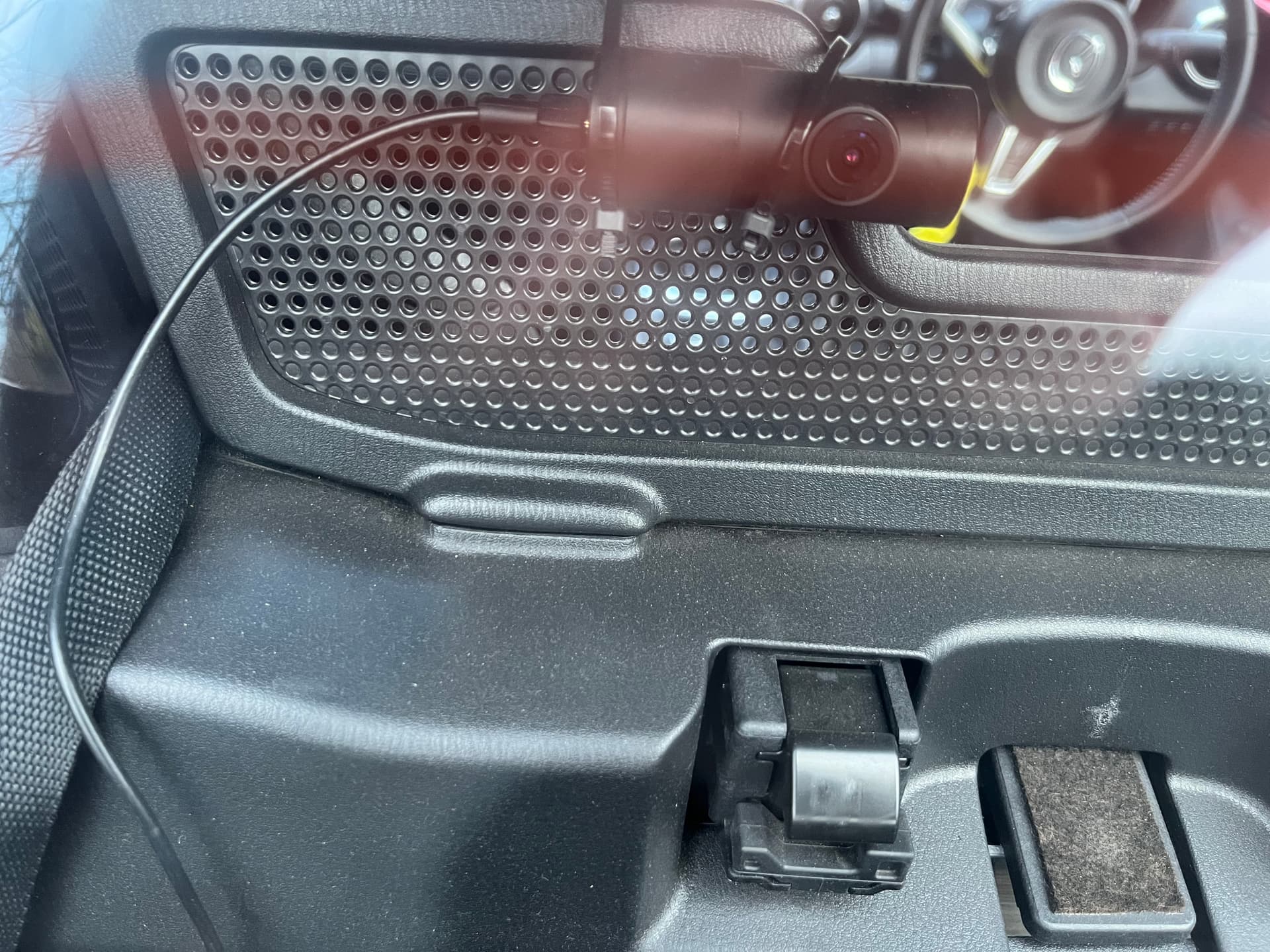

You’re best looking into a front and rear camera that can be hardwired (fuse tapped) into the passenger footwell fuse box, so it’s always running off the car battery, even when the car is off. The device will be smart enough to turn itself off when your battery gets to a certain level (so you never end up with a drained battery).
I’ve got a EUKI 4K one for Amazon. Currently on a Black Friday sale for £59.99 at the time of writing this. Well worth it. You have to ask them for the fuse tap kit, but they’ll send it for free - comes with fitting instructions too. Definitely doable by yourself if you’re able to get down into the footwell! Just takes time and patience making it neat and tidy.
The EUKI has a “parking monitor” mode which does a timelapse on the front and rear camera until that battery level is hit. Then it’ll turn itself off. I find it’ll last for roughly 2 days of timelapsing on my moderately new battery without the car being turned on (but yours may differ). If your car is bumped or knocked, it’ll turn on to full recording mode. Can connect to it via an app to see the live feed of how it’s positioned, or use it to download footage. Although it’s much quicker to just take the SD card out.
Wires can all be tucked away, and the front camera can be hidden in front of your rear view mirror (so it’s out of your line of sight). Rear camera can be zip tied to the wind deflector (but you’ll have to keep this upright always).

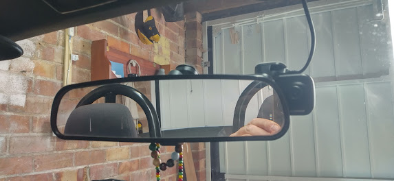

Very discreet and easy to hardwire this front/rear Nextbase Nextbase 222x Front and Rear Dash Cam Full 1080p/30fps HD Recording in Car DVR Cam - 140° 6 lane Wide Viewing– Intelligent Parking Mode- Polarising Filter Compatible- G-Sensor Motion Detection- Hidden: Amazon.co.uk: Electronics & Photo

This is my dash cam fitted in front of the rear view mirror.
There are no screens or buttons on it, to set it up and view the footage it connects to my phone by WiFi.
You can’t see it when driving.
The cable runs in the screen headlining, down behind the ‘A’ pillar trim and under the dashboard. It then connects into the 12v accessory socket under the dashboard. No cables visible at all :+1:.
Granted when the ignition is off the camera is off too.
Very easy install. You could probably get away with not having to remove any trim pieces, although they are very easy to clip on and off too and would make the install even simpler.
I haven’t installed a rear view one :face_with_peeking_eye:.

The forward cam is positioned in front of the rear view mirror on the right hand side so as to not obscure Mazda’s built-in camera, similar to that shown by MX51MJR. The rear cam is mounted on the windbreak similar to MX5MATTY. The cams are hardwired and a Power Magic Pro protects the battery from drainage. I shall probably bite another bullet and invest further in a hefty battery to provided extended parking mode capability.

The rear cam is mounted on the windbreak as per photo. Both cameras are supplied via a Blackvue Power Magic Pro that was included in the package and is hard-wired via the fusebox. The arrangement has worked perfectly. I am considering adding an additional battery to extend coverage during parking mode.
