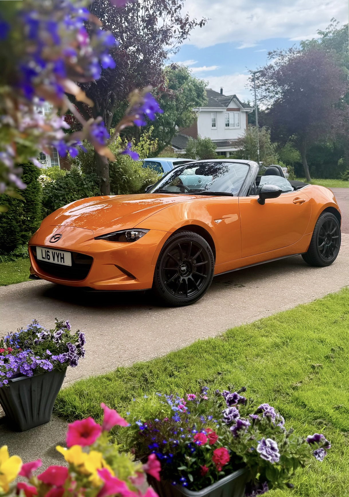

My New Wheels On Order :wink:
tyres 215/35 17s
They look spectacular, good call (and colour) :star_struck: Are they coming from outside the UK ?
I went for 225’s & they’re 8”, did a calculator before buying on willtheyfit & the difference was -1.7%
Nice! I put 225’s on mine, slight noise on front when on full wheel lock so next time will get 215’s on front. They were a bargain though at just over £80 each plus del from black circles though for PS5’s.
Looking at your photo, it appears that you have 225/40 R17. It’s actually +1.7% increase in diameter compared to 195/50 R16. Such difference will be unlikely to be noticeable.
It’s not recommended to run staggered tyre fitment on MX-5s. I would recommend reducing caster or adding negative camber or even both to address your issue.
