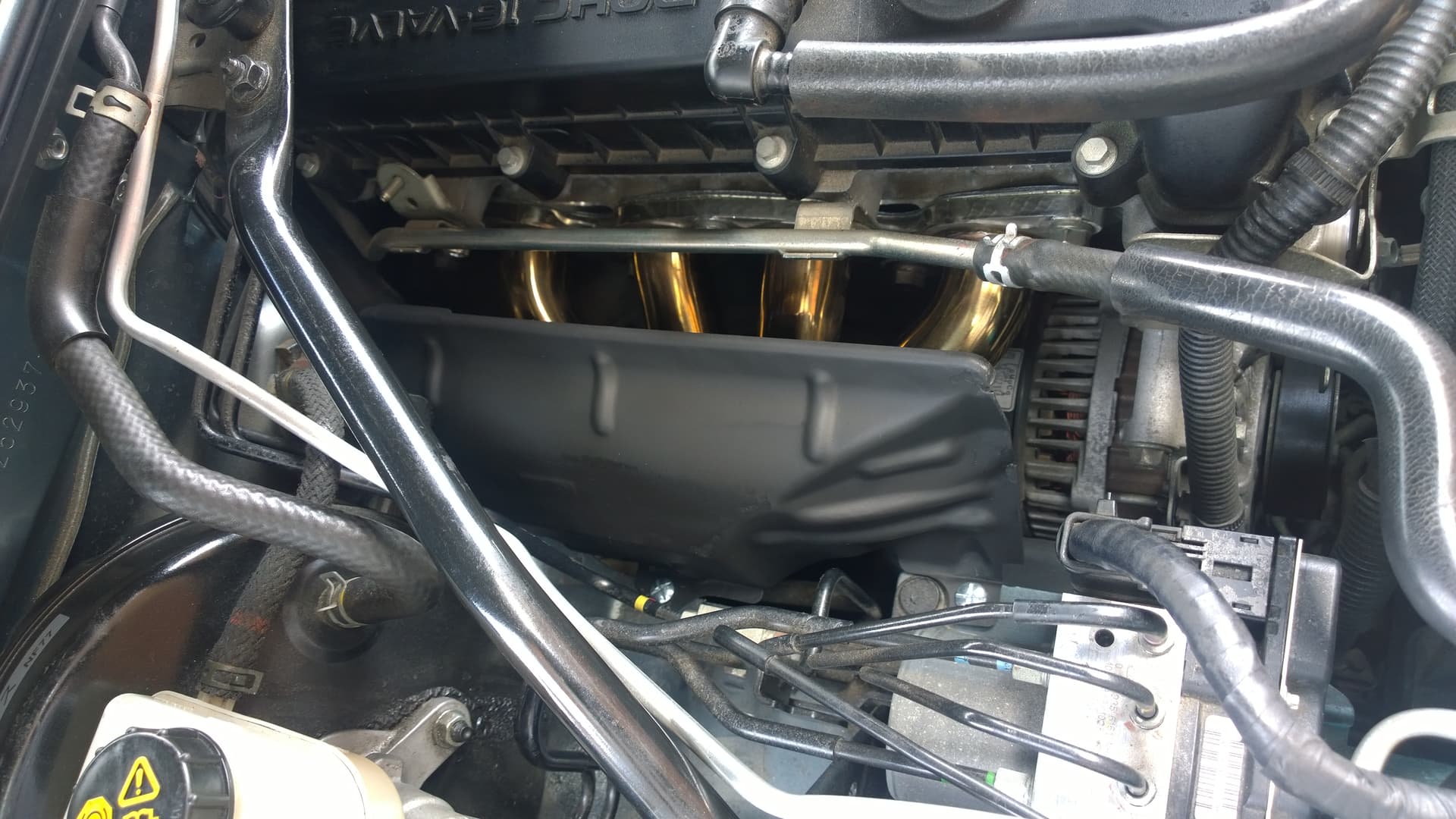

Here’s a second vote for the stove paint. I used it on the exhaust manifold heat shield under the bonnet, to hide that horrible rough aluminium look.
