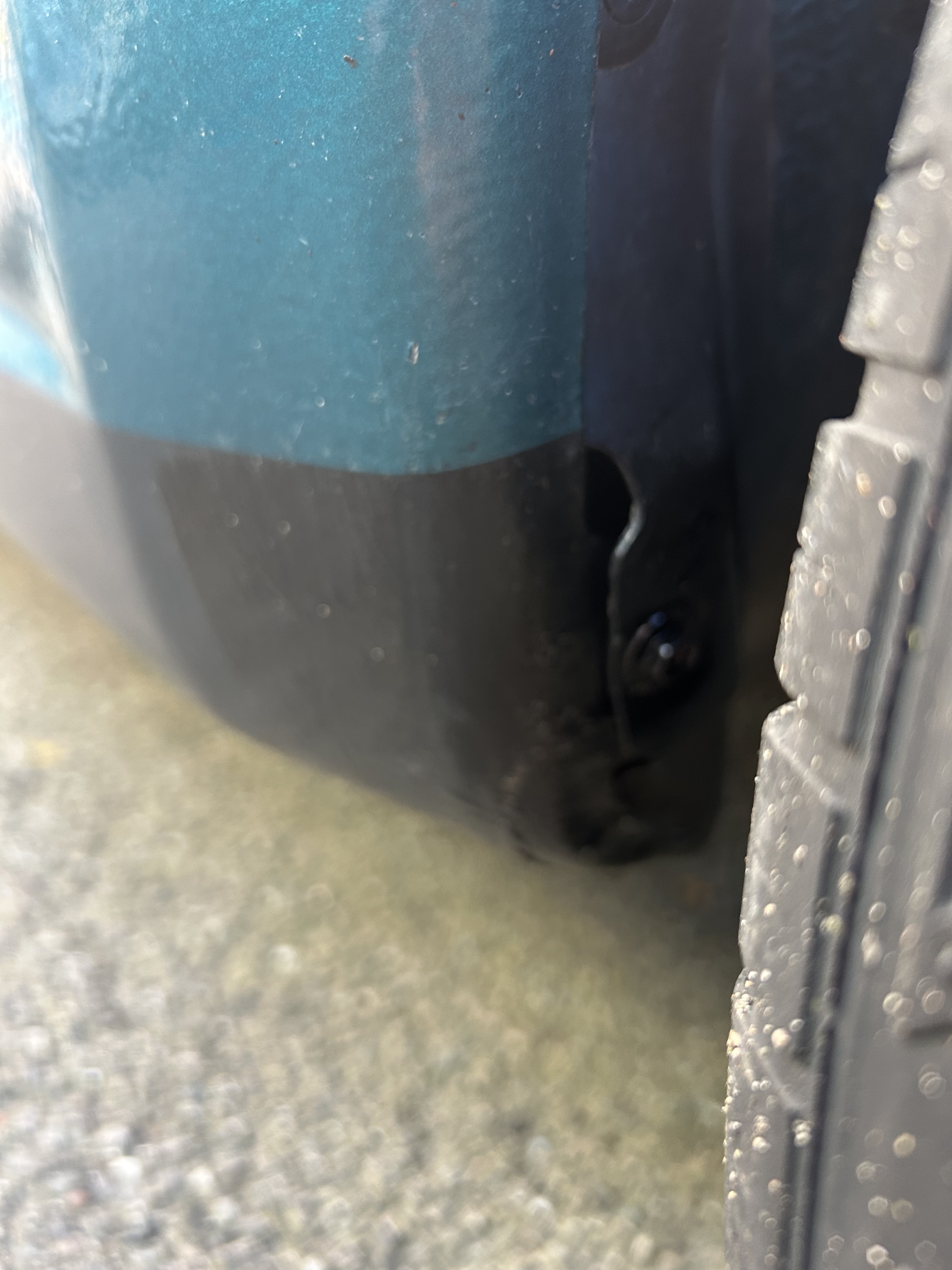

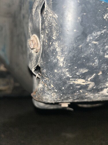

These are what I’m working with at the moment, I’d like to think it’s early stages and will do the trick with some sanding/anti-rust and a coat of paint- or at least I hope🤣
na’s been out and about today, so I can always provide cleaner pictures later to see what’s dirt and what’s rust!!
Your kind of wasting your time sadly but normally you would go at it with a flap wheel to get all the loose off, treat it and paint it.
Bilt hamber make some of the best products, i find the converters a bit hit and miss to be honest but theirs is well recommended.
At least you can mask and paint to a line, id probably buy a black paint suitable for painting over previously rusted surfaces rather then car spray type paint.
