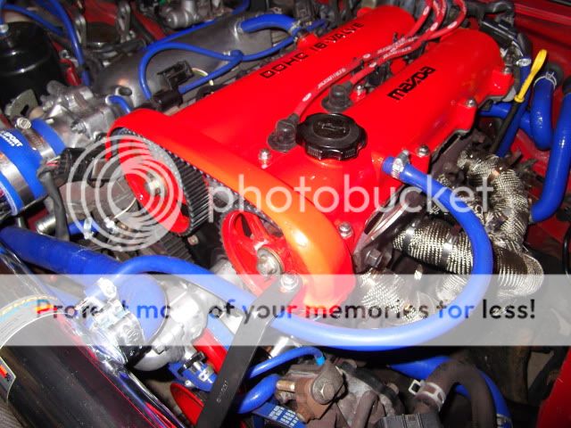

I recommend DPHSPORT on eBay, they sell T-bolts that I’ve replaced every clamp and clip with as they’re so good.
They’re cheap(ish), look good, quality and don’t pinch. Better than jubulee clips as they have a bolt to tighten rather than a screwdriver slot that just gets chewed up.

I did fit the OE spring clips on after first changing all the hoses, then opted for the T-bolts afterwards.
I bought a box of 10 of the (I think) 32-35mm bolts that fit the majority of the hoses - it was cheaper to buy bulk than singularly. I’ll check when I go outside.

They look very similar to ones I have seen on aircraft and …helicopters
