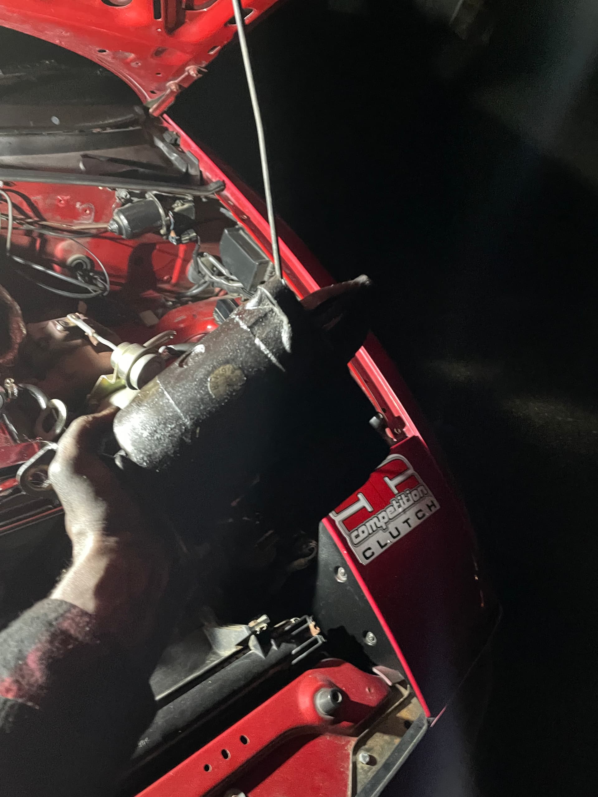

So I got stranded on the weekend because my starter motor died. At least I think it is the starter. Once or twice I have had to bump the solenoid to start it and the tuner who sorted out the misfire mentioned he thought it was on the way out. Had to bump start the car twice to get home.
Has anyone changed the starter motor here? It took me and a mate two hours to get the old one out last night, access seems to be a huge issue. I am not sure I am capable of removing an engine but was on the point where if I had owned a hoist I would have considered it when I was 3 out of 4 bolts deep with no certainty on the last!
As an aside, universal joints on ratchets really aren’t as good as I would like. This is the first time I’ve really had reason to use one and I didn’t love the experience.
I ordered a replacement from mx5 heaven last night but I’m genuinely nervous about getting it back in as I won’t have long. Part due on Thursday and I am intending to take the car to Japfest on the Sunday! I have tickets for the owners club stand and really don’t want to miss it, especially as ‘Phil’ will be there. Absolutely bricking it.

Starter motor arrived today. Upon initial inspection seems to look rougher than the starter motor I took out. Concerning.
Anyone know how best to test a starter motor before I go through the heartache and misery of putting the newly received one back in?
I’ve tested one before exactly has they do here: How to test your starter motor & solenoid - Starter troubleshooting - YouTube
jump leads to the main body of motor for earth, other to the live terminal on the solenoid. Then a jumper from live to the signal terminal. It’s a good idea to get someone to put their foot on the starter when you do this or it jumps all over the place! (ask me how I know :roll_eyes: ) You should see the solenoid push the cog out and spin then retract back in when off.
Simples…
Great success!
Starter motor went in on Saturday afternoon, car starts on the button again(albeit with some throttle feathering still) and since then the car has been a trooper.
