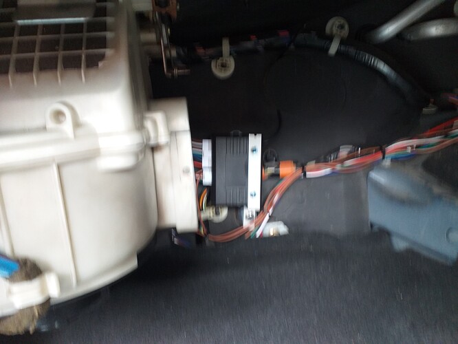

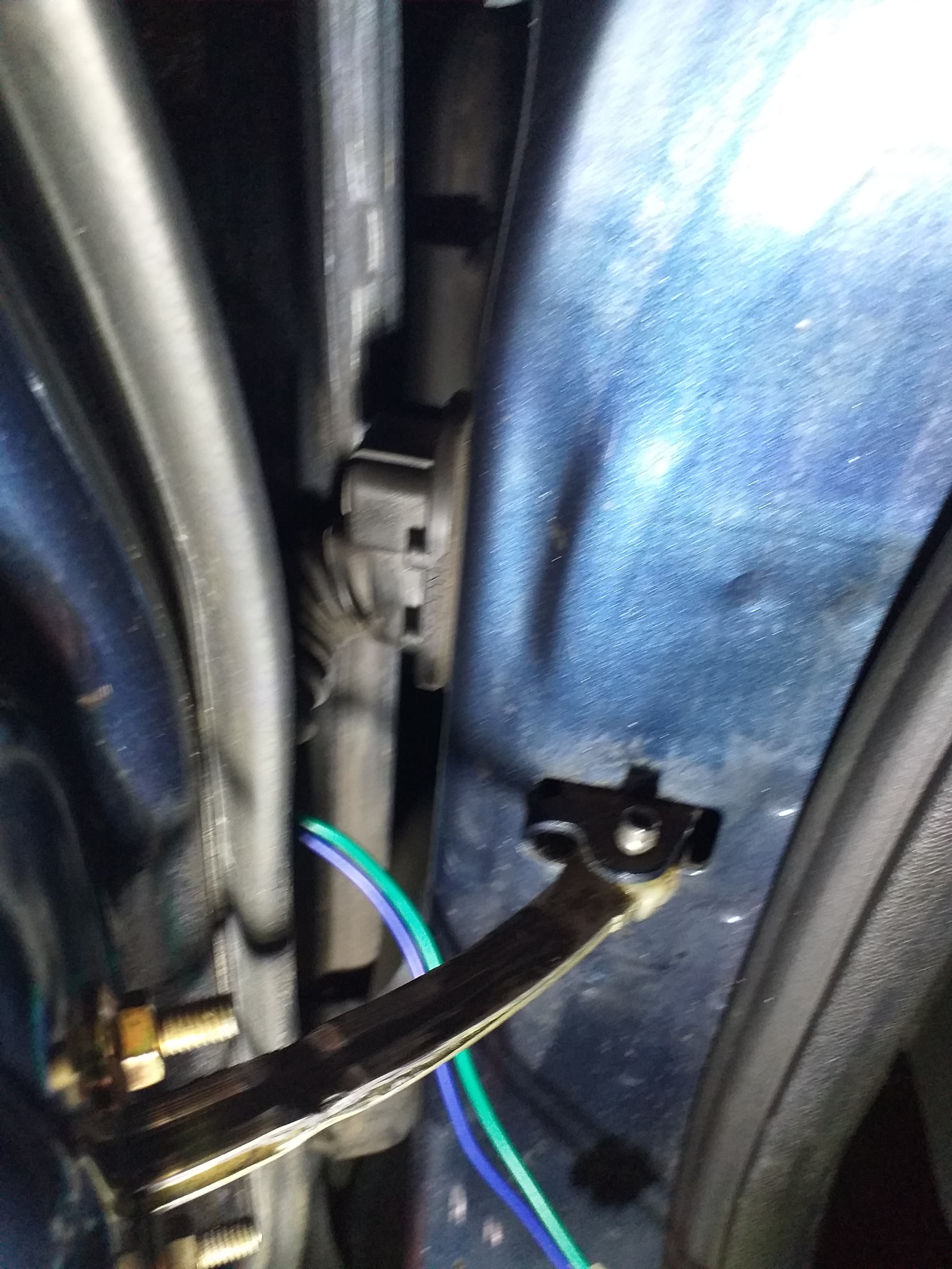

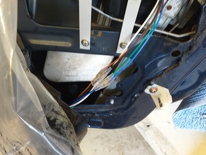

Good Evening All,
After much consideration and technical planning I decided to go ahead with the IL Motorsport remote central locking it.
Time consuming but worthwhile in the end doing a pucker install.
I adopted the 3 phase approach;
Install actuators with custom made brackets in the doors- Then test.
Run cables through front side of door and A post without butchering existing connector- Then test.
Position controller behind glovebox on bulkhead. Then test.
Finally run and cable tie all associated cables neatly.
See attched photos for reference.
Regards
Nic
