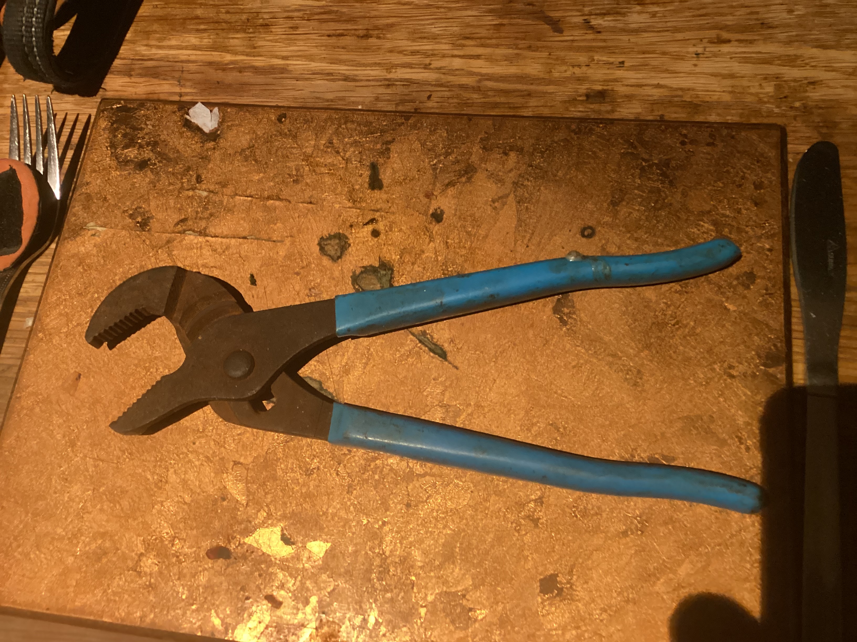

Exhaust Hanger Removal Pliers or even Water pump pliers, with your lube of choice, can help to keep your knuckles intact. :grinning:
Haha. Thanks for that; until now I didn’t realise these tools existed!
I think these, a tool with no specific purpose, covers an amazing amount of ‘odd-jobs’…
