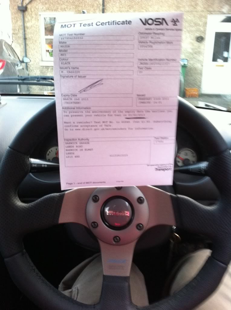

 Just got MOT on my MK3. No airbags at all and no lights on dash board as they were removed.  Passed at Maza garage to boot.
even had to put the horn on a switch as the new steering wheel was not up to it.
A Mk 3, there would be no doubt at all they were produced with the steering air bag, Did they mention it at all?
 Checked with them before I went. Told them I had removed all the airbags and they said it was not a problem. If its there it has to work.

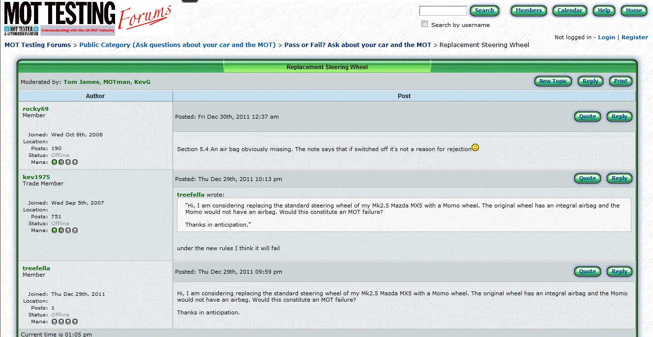

As said in an old post airbag light on/malfunction is a fail at the mo. As from April/may 2012 airbag missing is a fail. Allan

Feel a bit guilty here as it was I that first queired whether the change may fall foul of the new MoT and poor Geoff gets the stick. I’m pleased your car passed and I have to say the steering wheel looks great.
Just fitted a Moto Lita wheel to my mk 2.5 using these excellent instructions.  My MOT is due in June; checked with my MOT man and he says he doesn’t see it as a problem if the original wheel, with bag, is in the boot (so not missing!).  I used a Works Bell boss and made sure everything can be put back to standard just in case.
