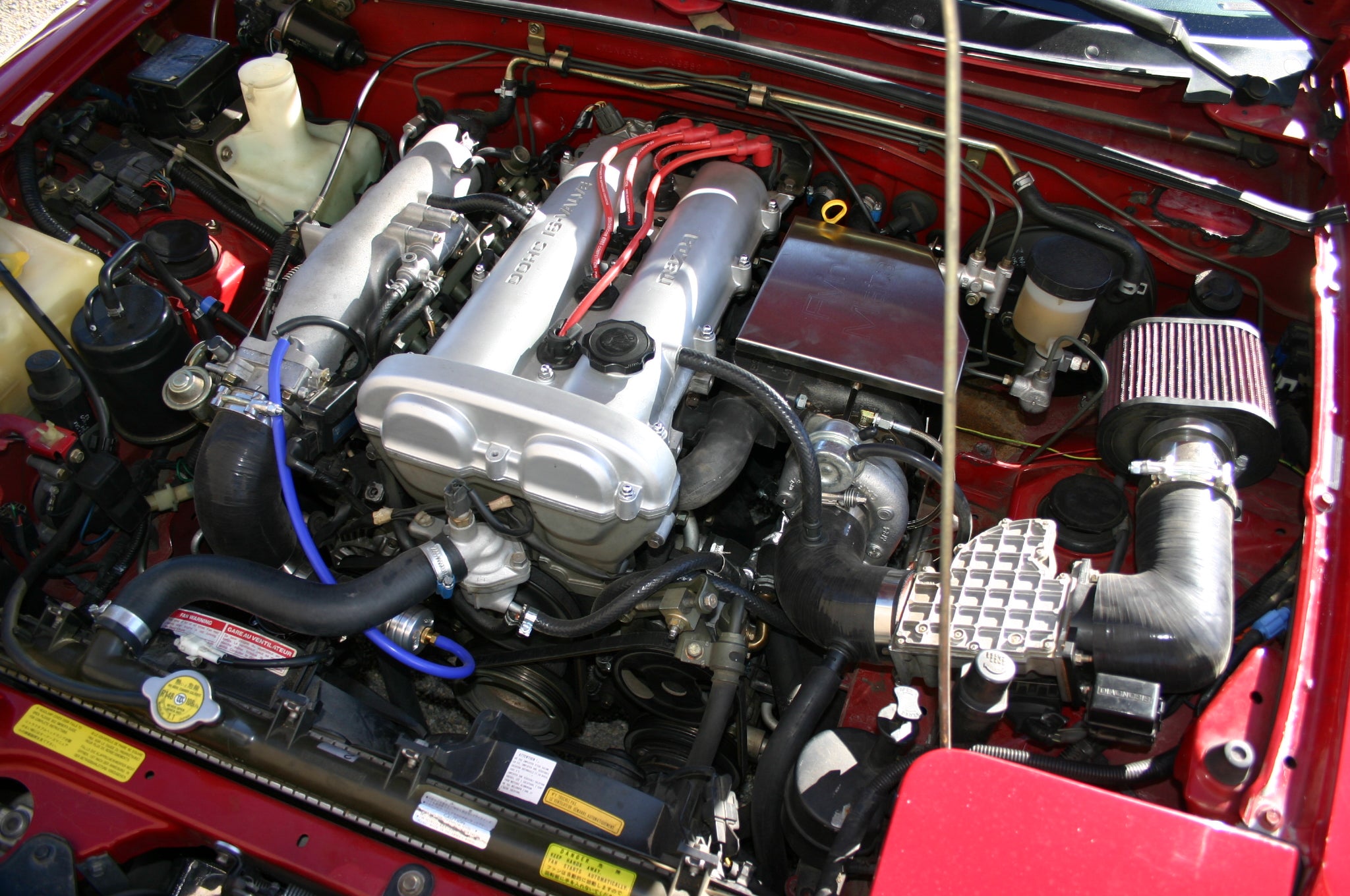

Has anyone any experience of doing this I can advise me on the pitfalls. My immediate thoughts are about changing the injectors and the ECU and how that will need to be reprogrammed. I have noticed in the current deflated classic car market a big variation in prices of these car and I have been offered this car for £2500 with no MOT. It was tested 15 months ago and unused. Here are a few photos of the car.

I’ve just looked at the photo of your car on a bigger screen. It looks like it’s actually been fitted with a turbocharger, rather than a belt driven supercharger.
Same advice applies though, although the fitting of a new ECU has almost certainly been done! :grinning:

Yeah, that’s a turbo, not a supercharger.

Whether a turbo improves the car depends on the quality of the installation and kit. On an old car like this, it won’t improve reliability for sure. Even 15 years ago, owners of such cars were forever fettling/keeping them running. This turbo is basically a FM Voodoo II kit (Flyin’ Miata). It its from 15 years ago, it would likely have been supplied byPhil Dixon at Performance-5. He’s no longer on the scene. Many of these were supplied and fitted by P5. Others were supplied as DIY kits. A few might have been imported direct from FM in the US, but I think P5 might have had exclusivity at one point.

Highly unlikely this has a programmable ecu with the air flow meter still installed, it will likely be fitted with the voodo box (piggy back)
With no boost it should run perfectly well on the stock ecu, but a quick look at the pic I would suspect possible air leaks post air flow meter.
I cant see any reason why this could not be reverted back to stock easily or equally left as FI and made to run perfectly well, Flyin Miata kits were never budget kits.
