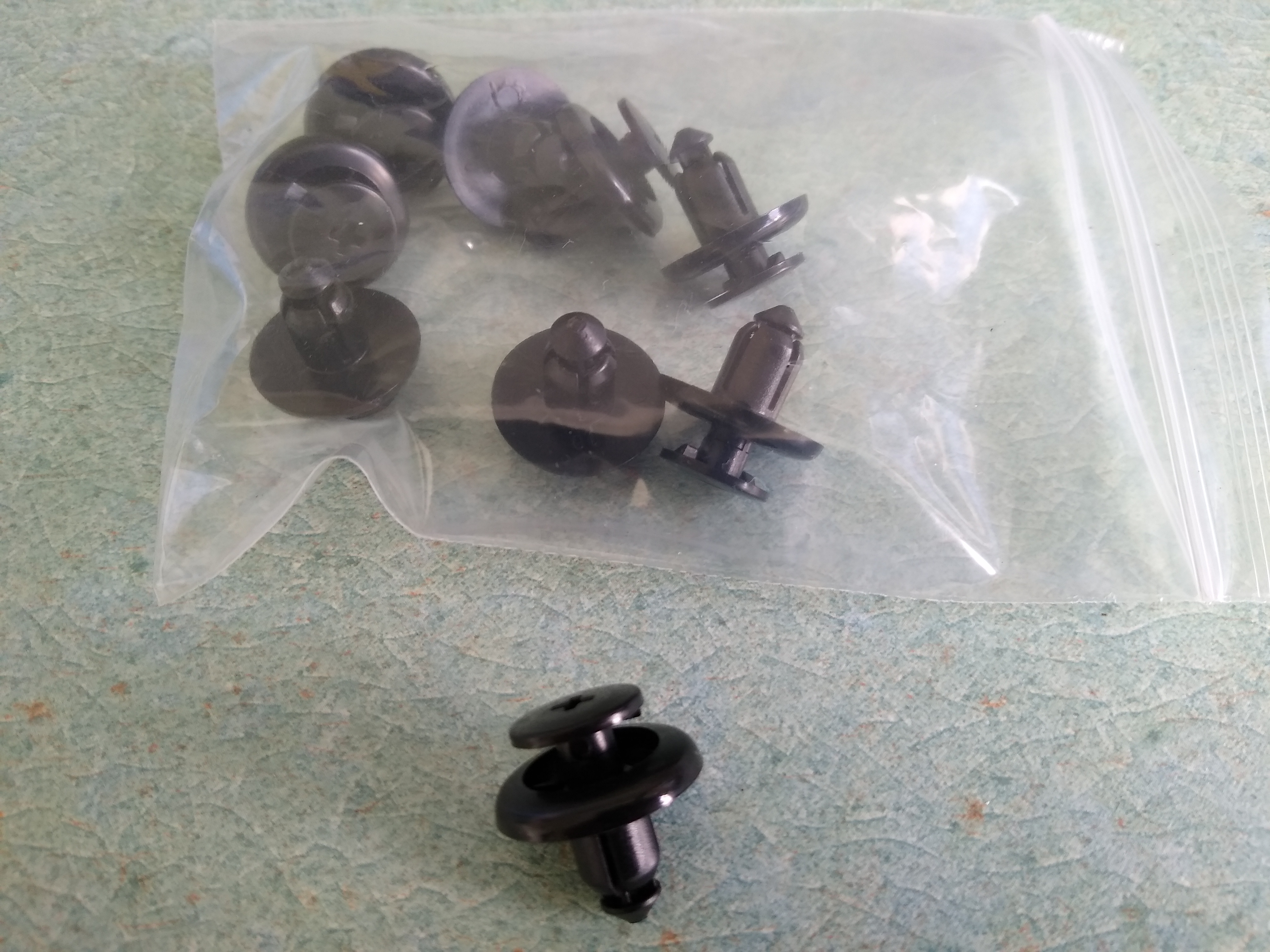

And if you need to replace any broken wheel arch rivets/clips these below are what you need, price shown delivered per pack of 10.
I’ve just had one break on me and I’ve a couple of loose ones, for the pack price versus a single clip from our favourite MX-5 parts place it’s a no brainer and they fit perfectly.
