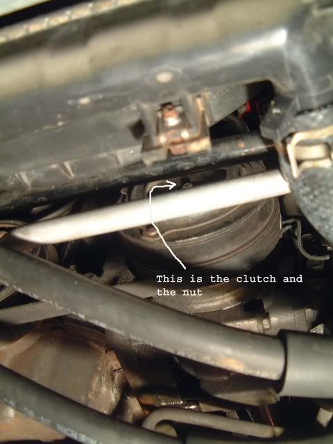

I didn’t realize you had a spare clutch. All you have to do is to remove the central nut holding the clutch on and then remove the clutch. You will need the bottom pan removing to be able to do this. There are also some very thin spacers behind the clutch so be careful you don’t loose them.  Here is a picture that should help you.   You will need two thin bladed screwdrivers or wood chisels at 180 deg apart to ease the clutch off.

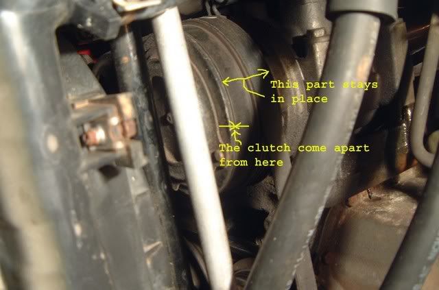

 These pictures may help you.  Unscrew the small nut that is holding the clutch on. In the second picture where it says “the clutch comes apart hear” place two sharp joiners wood chisels at 180 deg apart and you will be able to ease the clutch off.  Note: there are some very thin spacer washers behind the clutch so be careful not to loose these while removing the clutch.
