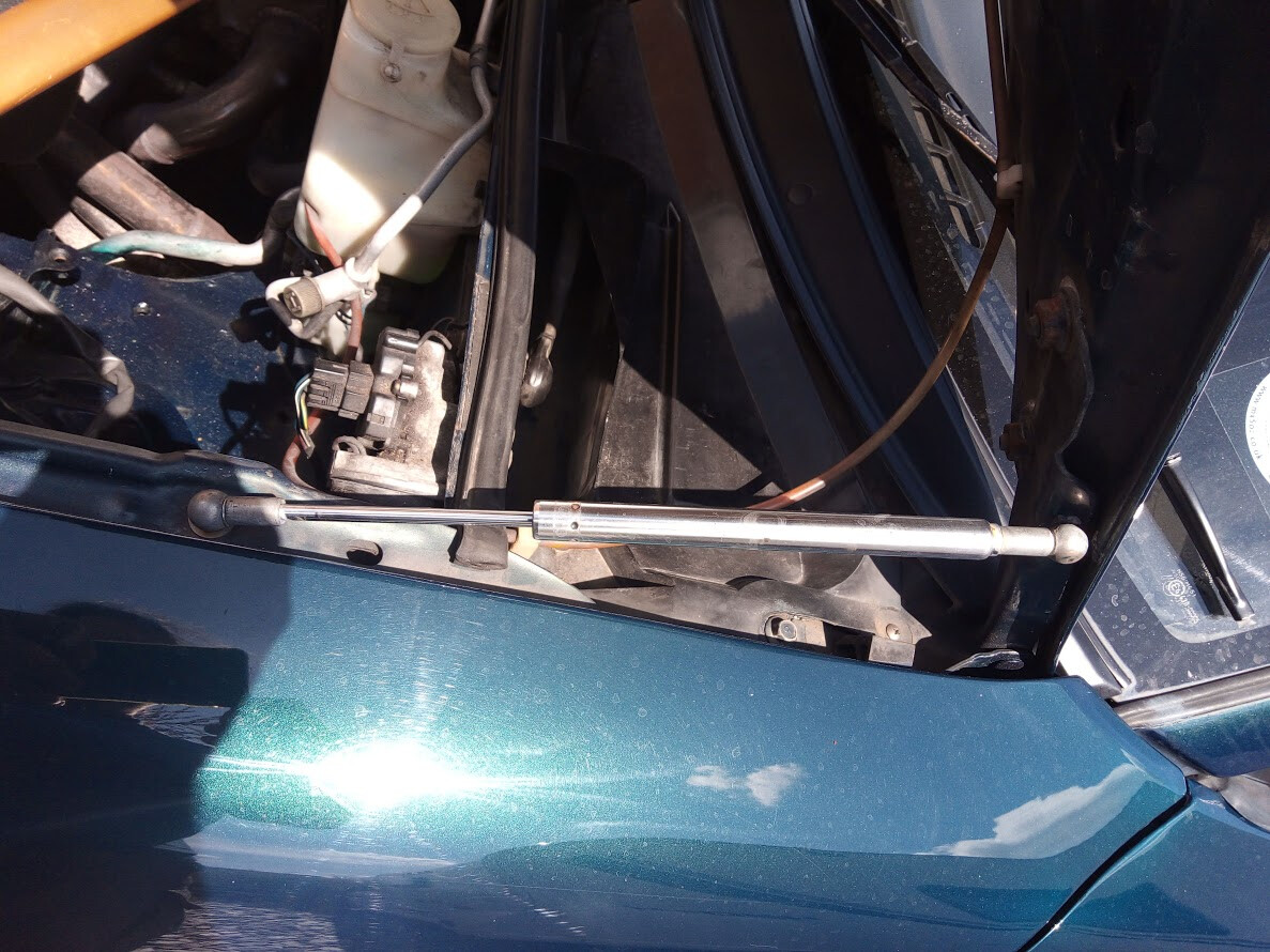

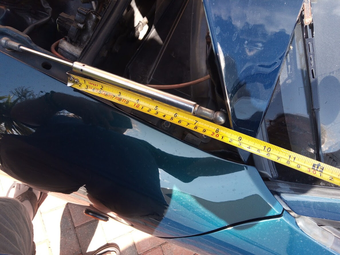

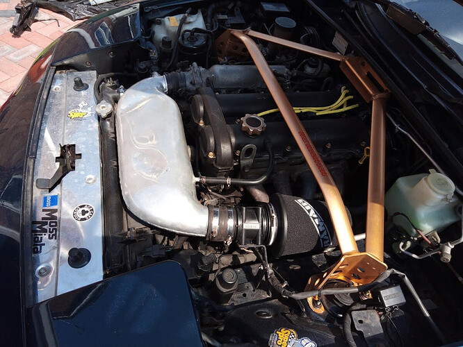

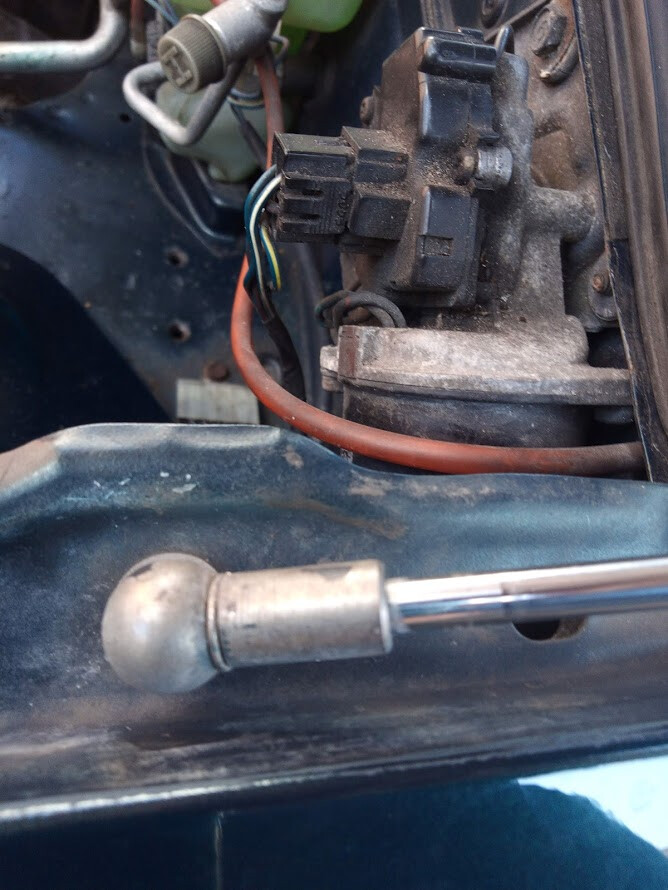

I’ve had the MX5parts (IL Motorsport) on my Mk1 now for 10+ years, and they’re not really able to support the bonnet anymore, even on the level (using a block of woould to support). Originally fitted because I have the 1.8 ARC Superintake, which prevents the standard bonnet prop from being stowed.
The present lifters being sold by MX5parts seem to be even cheaper than previous, so I suspect they have found an even cheaper source of struts.
I seems in the US you can walk into any parts store, with a random strut in hand, and they will generally find a replacement. Not sure motor factors in the UK will be like that. No markings on the struts I have; anyone any idea what I need to look for if scouting around for generic strut replacements?

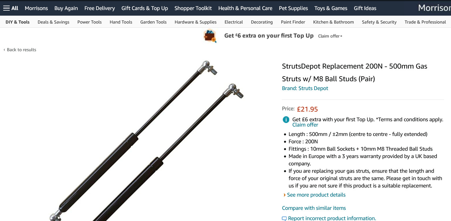

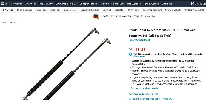

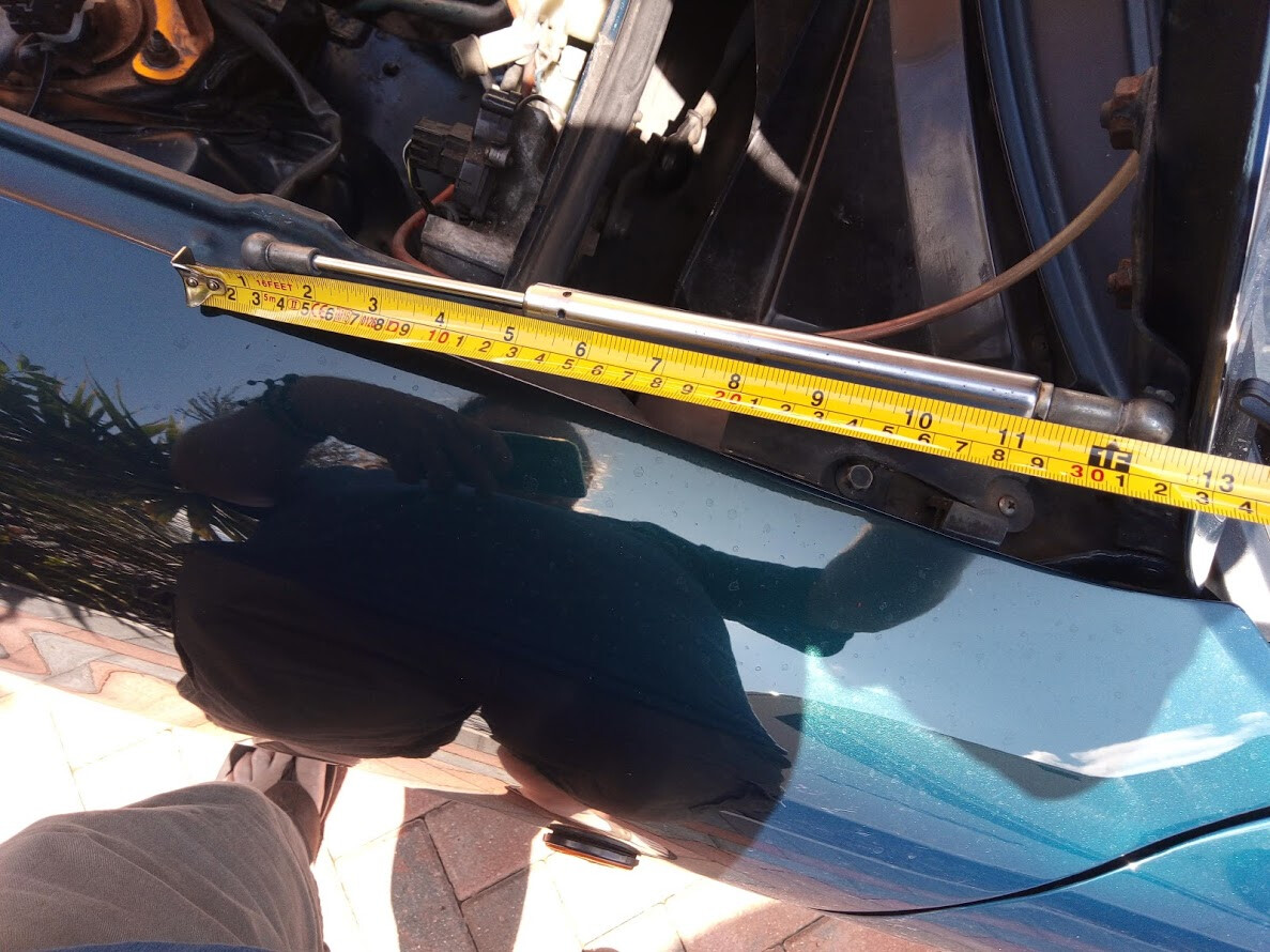

Thanks. SGS, StrutsDepot or Ridex will have a strut to fit I am sure, but need hunt down the correct equivalent part number. Some reference to 51lbs Strongarm D4247 lift support, but I don’t think I can get that in the UK. This seems to be a 50lb force strut, 500mm long.
Something like this is similar, a bit softer (45lbs)

The ARC Superintake prevents the standard prop to be stowed when not in use. So I used to just stash it behind the passenger seat before I got the lifters. Could go back to that, cost zero. I’ve had the bonnet struts for over 10 years; they have not distorted the bonnet. I think there are more problems with the kits that use just one strut.

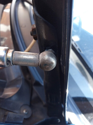

Don’t forget, if starting from scratch, the brackets for mounting to car and bonnet are still needed; strut suppliers like SGS will not have those custom brackets.
This is why my initial choice was the IL Motorsports kit from MX5Parts at one of the Nationals, it had everything even if not quite ideal.
However if merely replacing tired struts when the brackets are already in place, then SGS et al will be ideal.
THe MX5parts NA/NB lifter don’t have brackets; you drill the hinge.

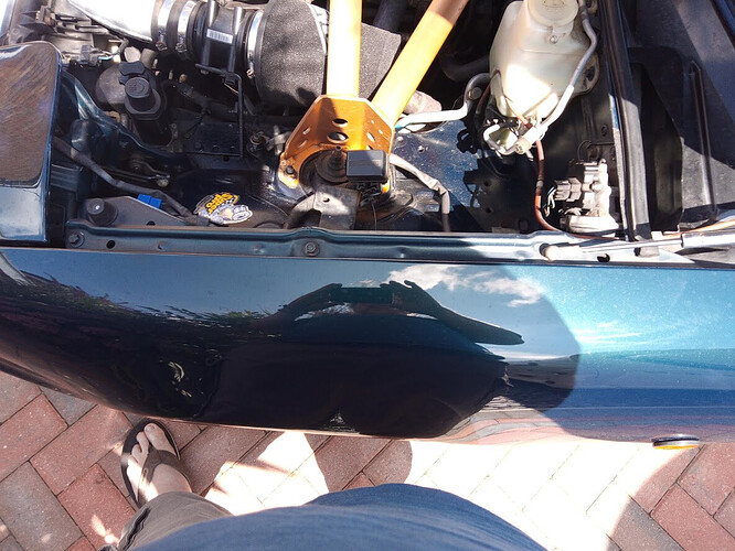

Ouch. I don’t like that at all. They must be heavy duty struts. I can see why there was comment about them distorting the hinges.
On my NC it is only slightly more sanitary, one just bends the bonnet if the struts are too strong!
