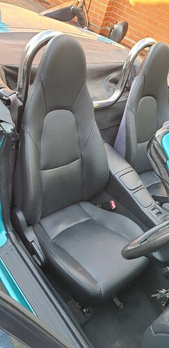

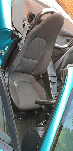

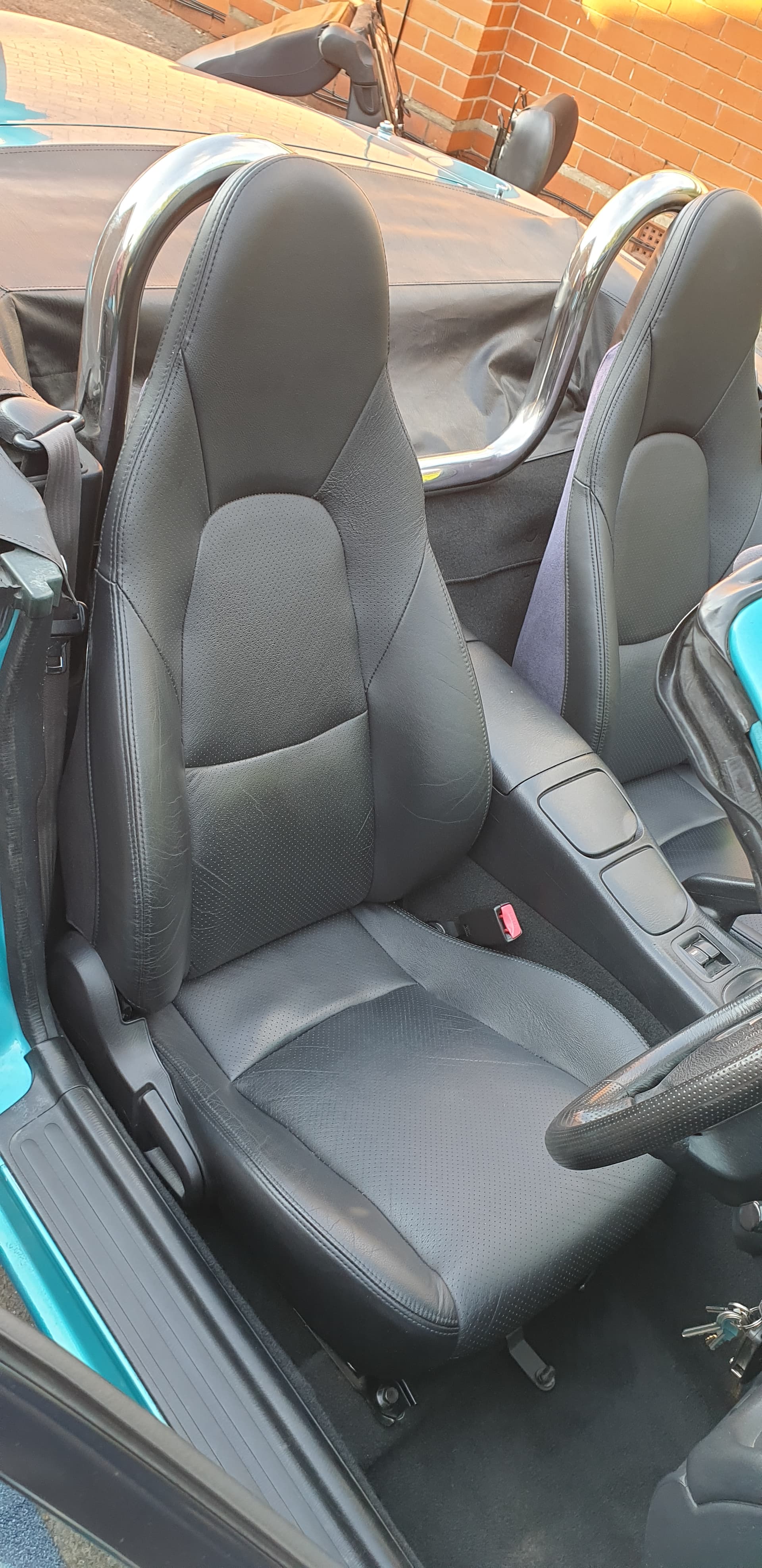

Here is a before and after of the cloth to leather seats in my Dad’s mkII MX-5.
Bought as a birthday present off eBay for £300 for the pair.
They were both immaculate.
