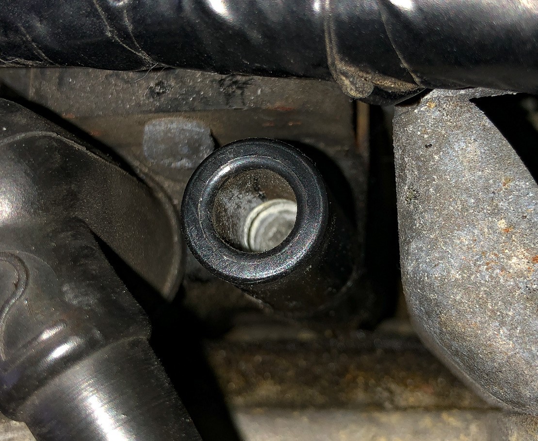

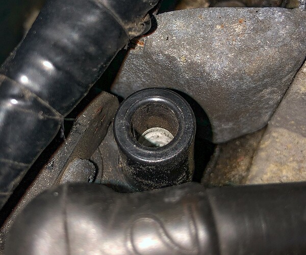

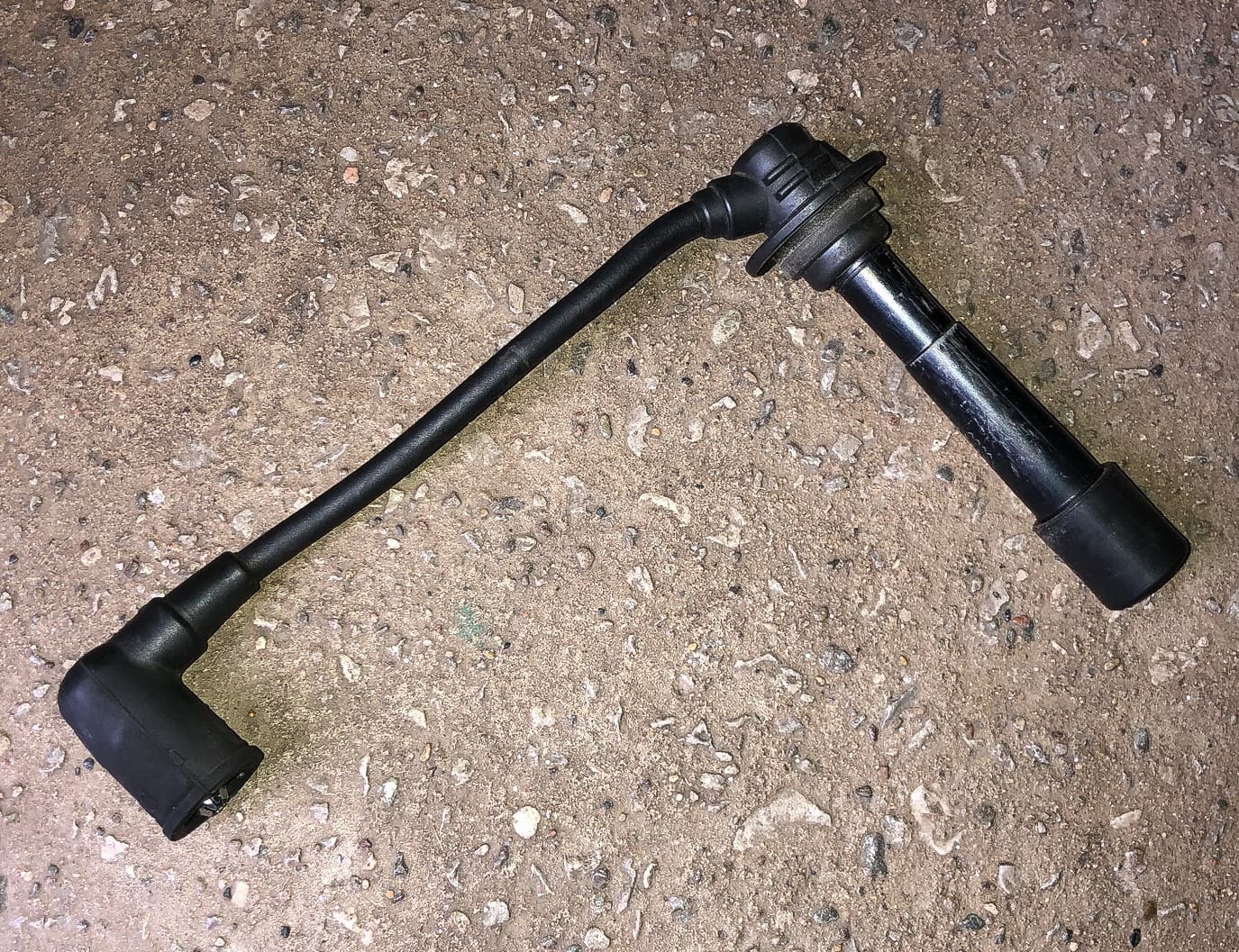

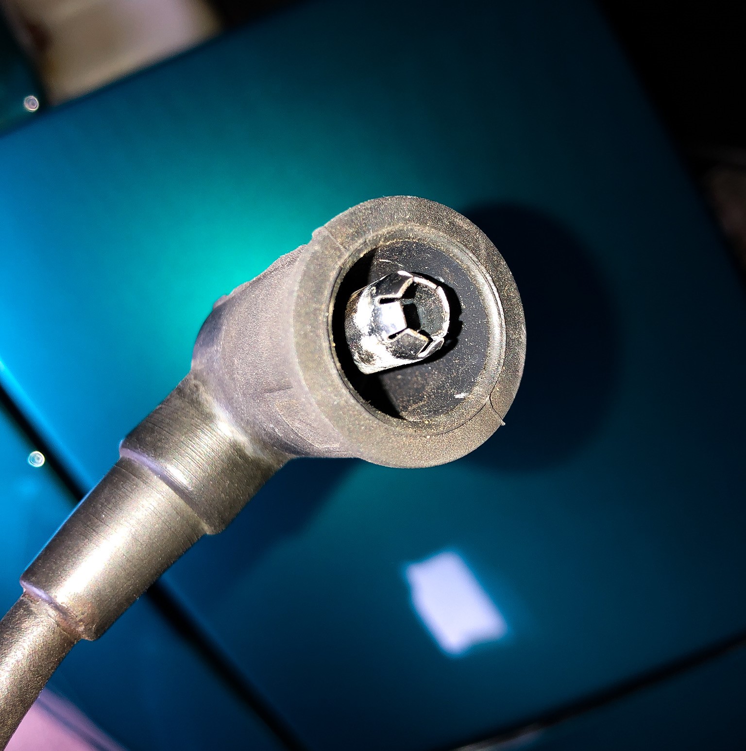

As suggested, here’s a couple of pics of the coil pack port (only got the one out at the moment). Also, the HT lead and end connector.
That looks like an original Mazda HT lead to me.
Good photos but the flash or reflected light has obscured corrosion detail from my eyes anyway. I think I see that the bottom part(aluminium) of the port in the coilpack is showing oxidation?
The HT lead also looks stained with corrosion. Both these should be clean looking shiny metal.
By the way for removal I usually twist the lead head slightly and pull at the same time.
If the ports have oxidised it will be much harder for the electricity to flow, as it has to jump past the non-conductive oxidation to get to the conductive metal below. This will result in higher voltages, weaker spark and heat/light generation.
I suggest this will have stressed both the HT leads and the coilpack over time and created your running issues.
You could try cleaning everything up for a short term test but as already suggested, the best way forward once this is confirmed as the cause is replacement of the coilpack and HT leads.

Further update. Managed to get remaining connectors off coil pack to inspect other ports and leads. Took a bit of prising at the bottom of the rubber boots to free them as they were stuck tight to ports, before pulling off from top. Other than the first lead I removed (sparky one pictured above) all other ports are perfectly clean and shiny.
Having removed all leads, I was also able to test and compare all four with multimeter. Sparky one faulty (must have a break), but other three checked out fine.
The core of the coil pack that was cruddy seems to have cleaned up well with Dremel tool (as recommended by Rhino666).
