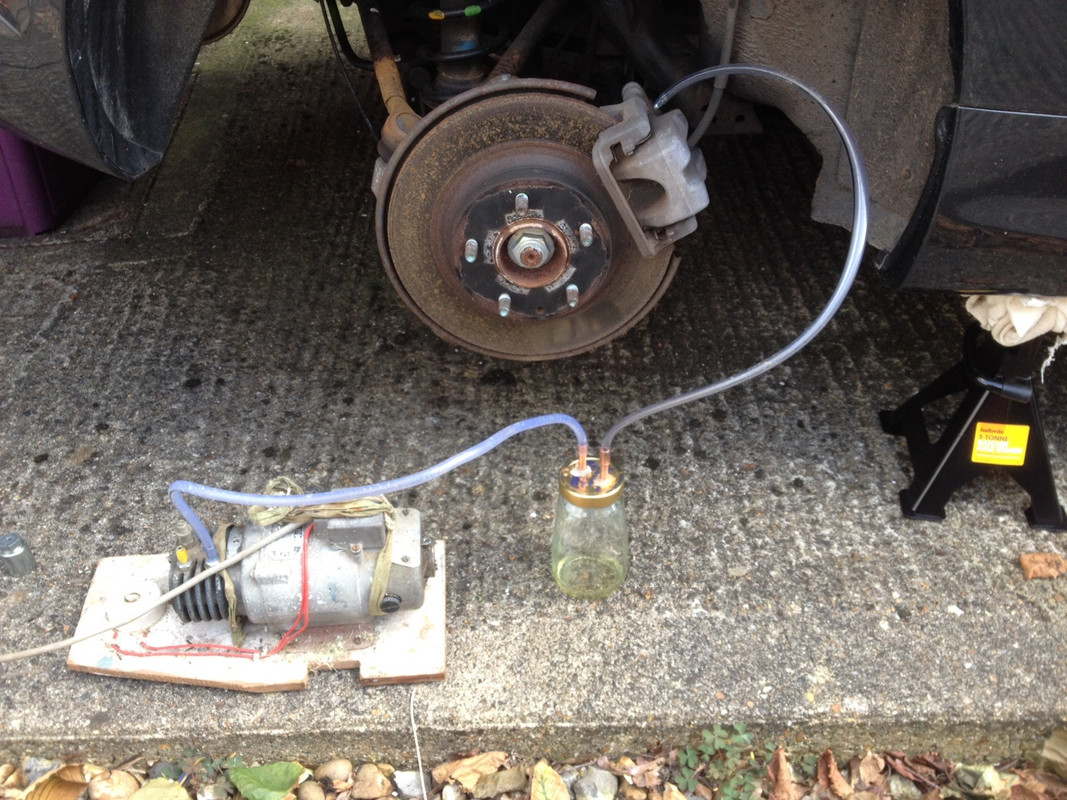

The vacuum system mentioned by Drumtochty has sown a seed in my mind though. I have an old vacuum pump in a cupboard in the garage somewhere, and was thinking of maybe having a go with this, using some pipe and a catchment jar arrangement, and a bypass valve to control the amount of vacuum. I wonder how much of a vacuum is required? I might see what I can knock up over the next few weeks.

If I can get my vacuum pump idea going I’m guessing that even if the pump isn’t powerful enough to pull the fluid through on its own if I gently operate the brake peddle it would still work. Any thoughts?

Maybe I just like a challenge. Being a retired engineer I like problem solving hence the vacuum pump idea. It may not work but I’ll have fun building the kit and if it works all the better.

Just a quick update.
I found that old vacuum pump I was talking about, and with a bit of tubing I found in the garage and an old Branston Pickle jar ( other jars are available ) I knocked up the below bit of kit. Works a treat. Turned pump on and controlled the flow with the bleed nipple. So easy.
Thanks again for the replies, these sowed the seed to use a vacuum to pull the fluid through. These forums are great.
