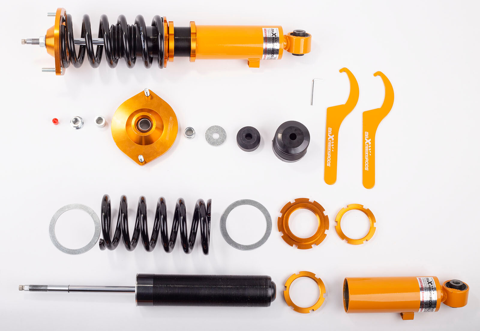

You can get sets for £200-250, that look like this:
Under brands such as MaxspeedingRods. They look great, with a nice anodized finish, and adjustable bits. But it doesn’t take long to find some very detailed reviews showing them to be utter junk.
These shocks are two piece shocks, or double spring perch coilovers. Essentially there is a generic threaded insert, with a internally threaded tube specific to the car its being fitted to. The Japanese came up with this idea; small tuning shops, such as Corns, could come up with the own branded coilovers for not a lot of money. Its how BC, Meister etc do it…

So steer away from the £200 double perch shocks, and look for fairly conservative 1 piece designs. The Vmaxx sold by MX5parts seems to be a good buy for less than £400.
