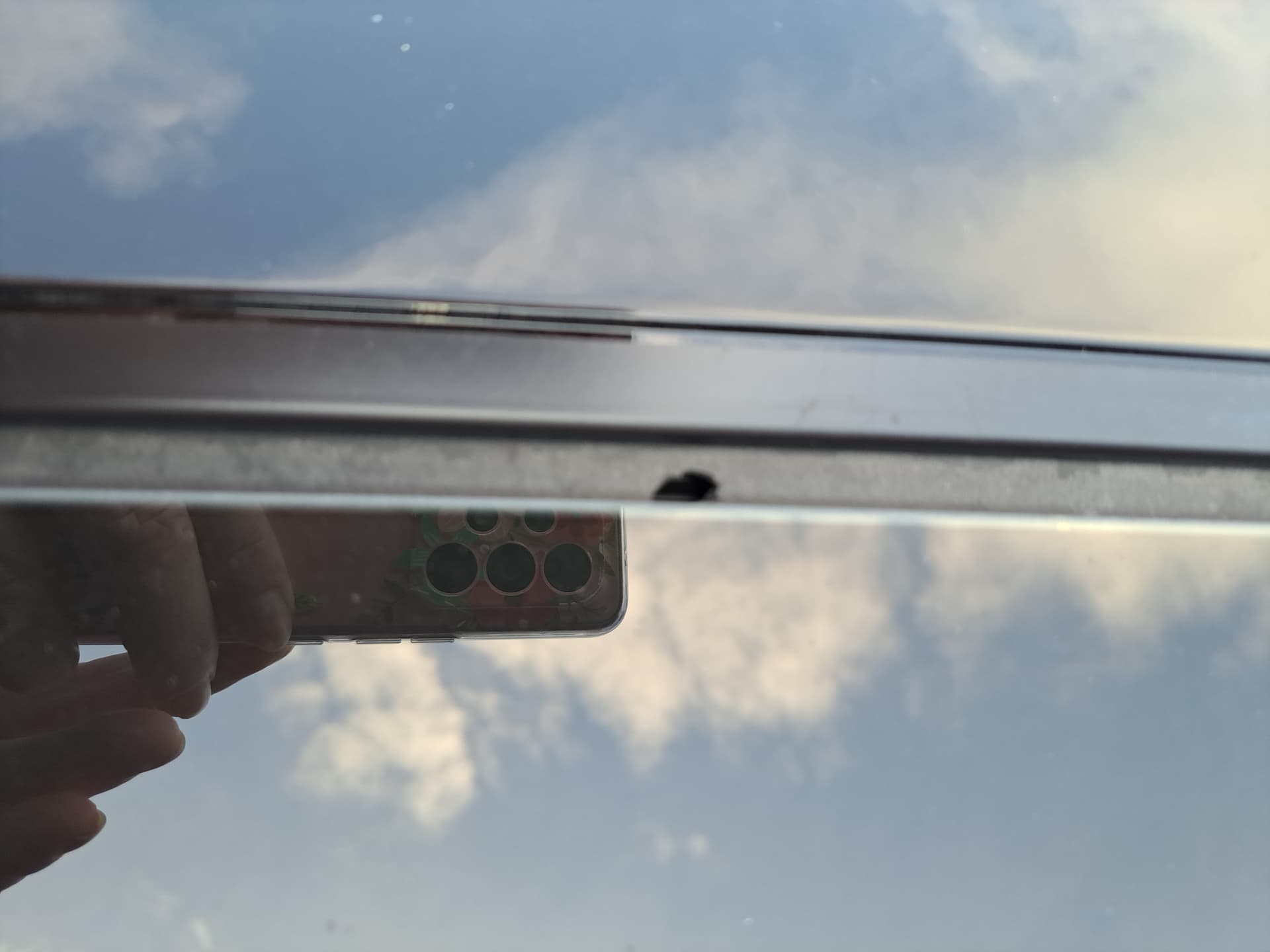

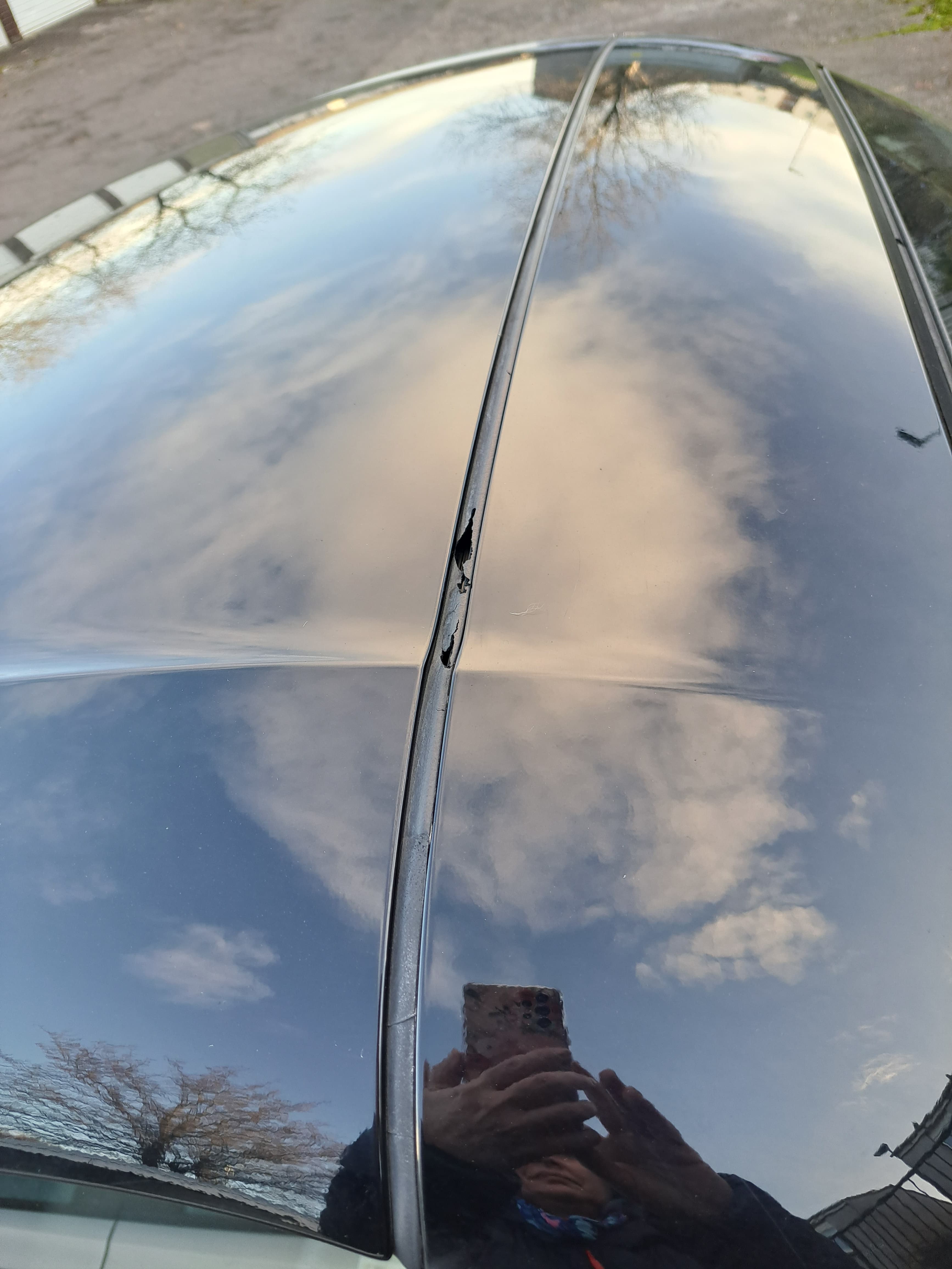

  3. I’m looking for technical help or recommendations on: __ replacing the retractable hard top as the seal across the top and above the rear windscreen have perished (holes).
I can get a full good quality 2nd hand retractable top from a reputable seller. It’s £90 less than just the top seal costs from mx5parts. I’m struggling to find someone to fit it though. Any recommendations, preferably near FK10 area (central Scotland)?

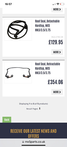

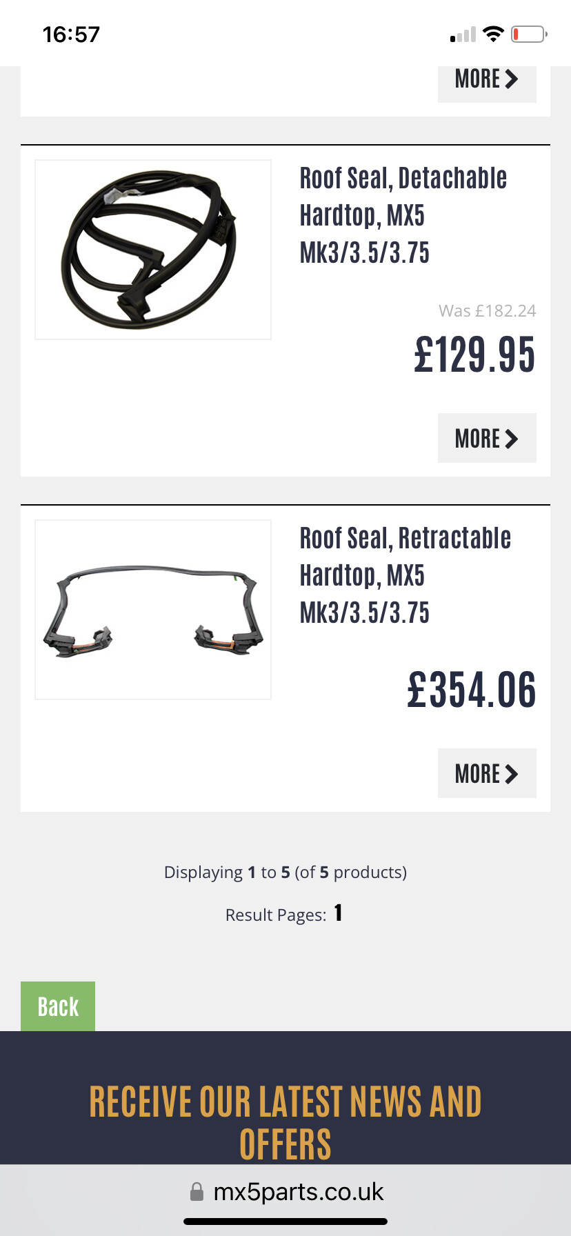

Thanks for doing that. I’ll have a think. It’s potentially £1500ish for the rear window and roof seal new, never mind fitting. The 2nd hand roof is £265 and the guy has really good reviews. I also spoke to him this morning and he’s going to send more images and check it. A local garage has said they’ll take a quick look to see if they’ll consider it. I’d rather have an MX5 specialist though.
I have a 2009 NC2 Roadster with the retractable roof. I think it would be a nightmare to replace. What is the condition of the replacement roof and what colour is it. The new seals from MX5 parts will be about £500
Hi Dave. The roof itself is perfect, but there are gaps in the seal (the one that’s £354) so that’s irreparable and needs replaced. There’s also a very small hole above the rear windscreen. Mx5parts said that would be “at least” £1000 as the seal and window are one unit :pensive: That’s why I thought replacing the whole thing would be better. It’s not looking like an option unfortunately. 3 garages have said no .
I would try and repair that small hole ideally with the same material. Get yourself down to Trimline Systems, 23 Coxithill Rd, Stirling. They do

Earlier I was going to suggest similar, maybe try and inject some suitable and obviously flexible black silicone type filler in there. Could it then be (if required) trimmed to suit the existing seal?
I’ve got the same retractable hard top, I’d give it a go first before shelling out on a new seal.
I’m with MickAP on this, regarding black flexible sealant.
