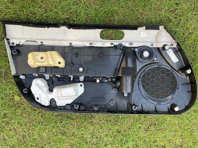

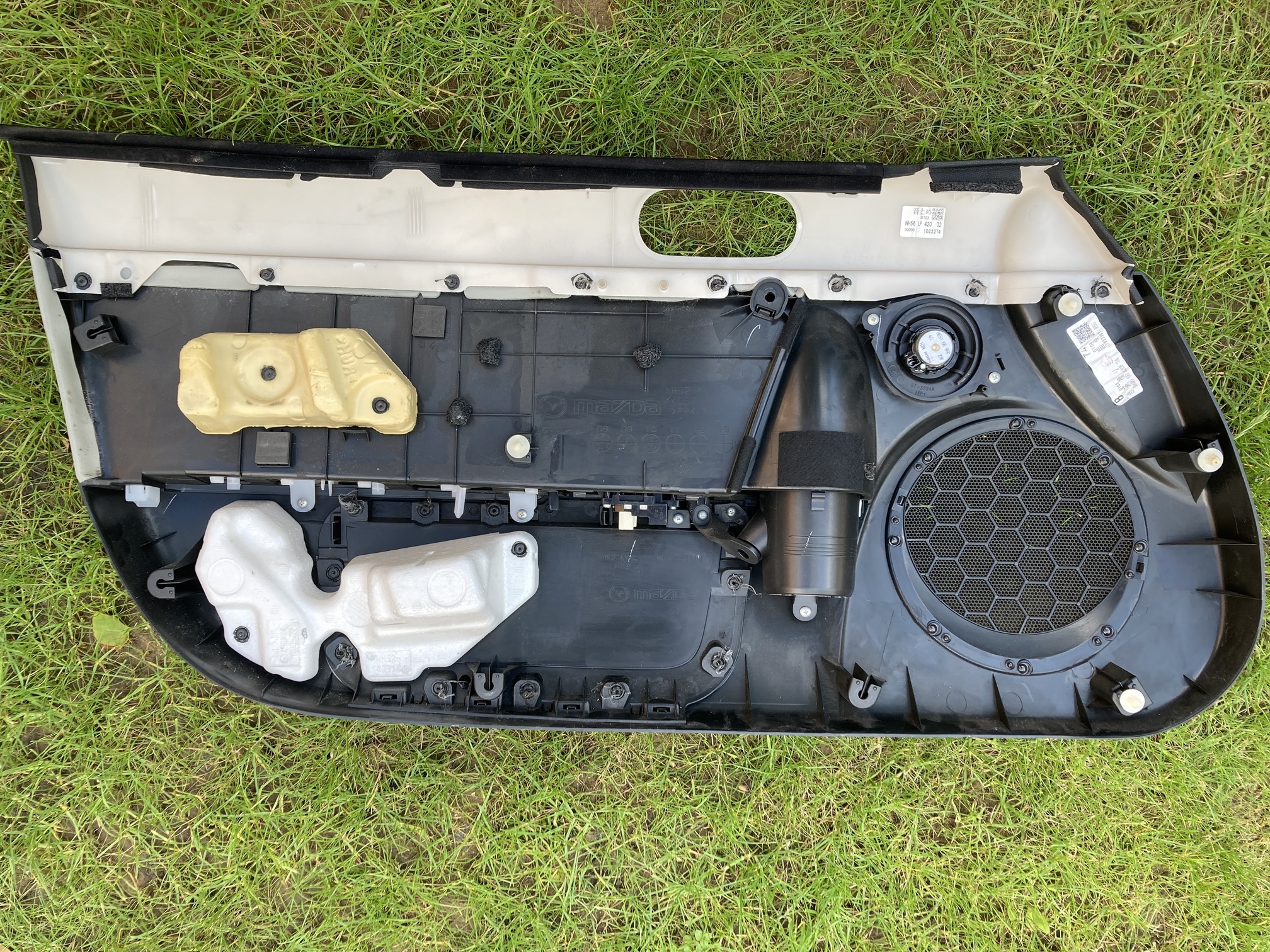

I’m a tad confused now. This is what I have (they look better now after some tlc). I’ve not taken the old ones off the car as yet. Is there something else that should be on the back of these?
Any way to tell is these are from a 3.5?
For entertainment purposes, I’m going to the local Mazda dealer tomorrow to see how much they want for the missing handle piece as shown. I suspect it’s too much to hope that the NC1 handle will fit.
Yes they are NC2/NC3 door cards. The bottle holder is flush and you have the doc wallet under the arm rest.
If you look at what is fitted in your NC1 you will see the bottle holder sticks out from the door card.
I understand the difference between NC1 cards and these, but scorpes in his post above referred specifically to 3.5 door card - hence my question.
I think scorps was referring to the mk3.5 inner door cards to save you having to modify the mk3 inner door cards to make those new door cards fit.

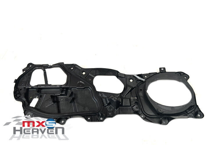

yeh thats it the inner door cards otherwise you would have to cut them for the cupholder to fit and the screw in theca recess won’t line up
Just an update with some supplementary questions thrown in:
From your last comment, can I just check you are saying that if I docut the back card to allow for the cup holder, the screw holes will not line up?
The inner door card you posted details at at MX5 Heaven are the NC1 type. I foolishly thought the NC2/3 versions would be around the same money. This was my first mistake.
I rang a local MX5 breaker today. They had one in stock - asking £125 for it!
I rang the local Mazda dealer - £158 each - none in stock across UK - would have to be ordered in from Europe.
I asked about the plastic half of the pull handles- as marked in the earlier photo. Only £68 each - none in stock in UK - would have to be ordered in from Europe.
Based on these prices, unless modifying the existing card is viable, I will have to stick with the originals.
Pleased with the seats though
These say 3.5 ( NC2 )
Just make sure your front speakers are OVAL ( Std system ) rather than ROUND ( Bose system )
