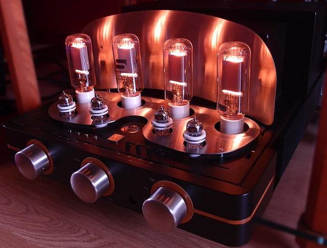

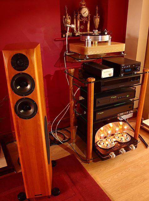

Some pics of my old kit
My current kit is different again, but I don’t have good pics to hand.  The speakers are now huge (Heco Dreiklangs) and I have a choice of amps - solid state and valves, plus of course I still use a nice turntable.
I’ll get my coat then, ultraviolet68  beautiful looking set up you had there! Puts my humble set up well into the shade  thank you for posting the pics.

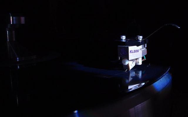

I loved that turntable - a Palmer 2.5 with SME arm and Lyra Kleos cartridge. Sold when I moved house. But I do now have a really nice Project Xtension 10 which is super and gorgeous looking too.
The old kit was Unison Research S9 integrated amp, Graaf phono stage, Naim CDX with CDS power supply, and Audio Physic Avanti IV speakers.

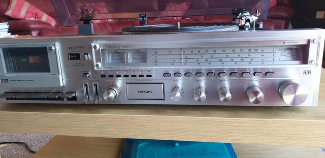

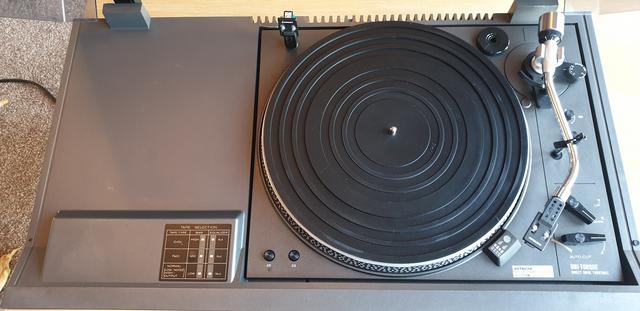

Rewind to Monday if you will. My budget is very modest indeed insomuch as I have so many things that demand my attention  So, I’m always trawling through for sale ads etc for bargains in the hifi department, on various Online selling places. My latest acquisition is certainly retro and music related, I purchased this, it’s a HITACHI STD 7785 music centre, straight out of the 70’s!
OK, it’s not everyone’s cuppa as they say, but I wanted to try one out. £140 exchanged hands and off I scurried home to inspect it. Came with a pair of not contemporary HITACHI bookshelf speakers, handbooks, a spare original headshell and DM cartridge which needs a new stylus. I bought it knowing that the cassette drive didn’t work, so set to this morning to have a look.

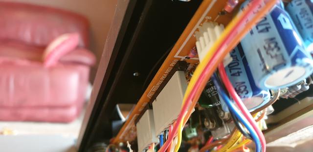

Lifting the platter off revealed two screws in nylon bushes, holding the main turntable in position, unscrewed them and lifted the complete turntable base out. I think this turntable was available as a stand alone, it’s HITACHI’s UNITORQUE direct drive, two speed with pitch control, strobe etc. The model is HITACHI TP-1000. Three electrical connectors to unplug and it was free!

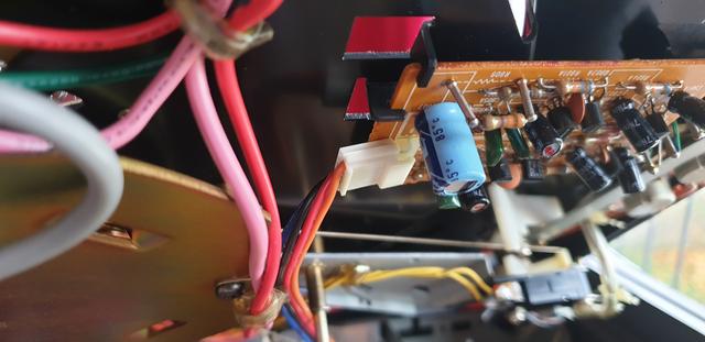

Working on the principle that it screwed together so it must be able to be unscrewed, I continued. Taking the turntable off revealed two plastic “stands” screwed from underneath plus four more screws (two on either side), this allowed me to remove the complete upper casing, revealing the main chassis in all its glory, and access to the cassette mech.
Top left of the last pic shows the large flywheel and motor with, guess what? a perfectly serviceable main belt. All that had happened, probably due to over eager use of the various cassette drive controls, the belt had run off the flywheel. Now I’m not 100% sure but this deck is a ‘power assisted’ one and I don’t think anything works without the flywheel spinning? All the keys were solid and would not depress. I reseated the belt carefully and tested it, everything now works perfectly  a great result! Well happy with my handiwork! Next post (as these get quite lengthy) is another great result.

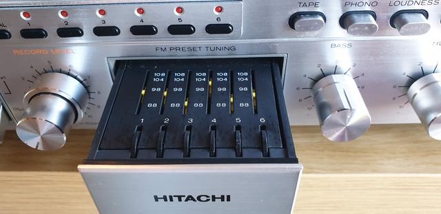

Last of pics for now, a very nice fine tuning drawer for the 6 presets on the tuner. Very sensitive and functions perfectly.
Just gently press and it opens, gently press again and it clicks back in, very tactile. All the control knobs are nice aluminium, not plastic, the other buttons and thumb wheels are but still have a nice feel. All illumination works perfectly too, al in all, a very nice, excellent condition system. The tinted Perspex lid is great too, covering the whole unit, no cracks, hinges hold the lid up nicely, just a few very light swirl marks which TBH, are barely noticeable.
