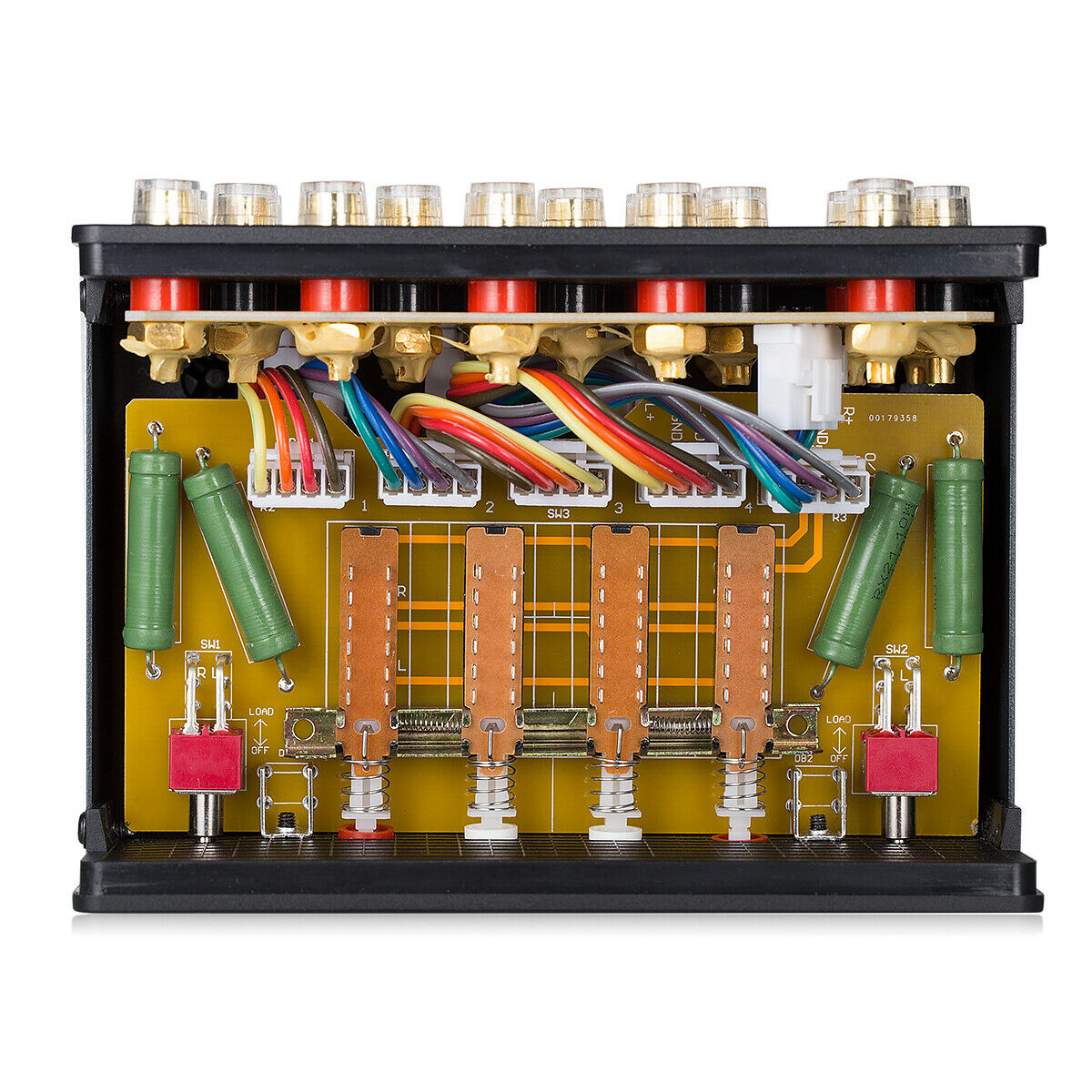

A picture of the rear of the new speaker switch box which has not yet arrived (library pics).
One of the inside too!

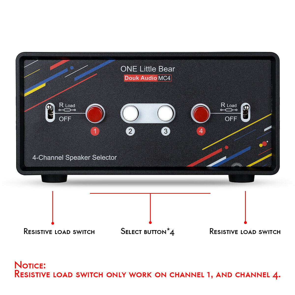

Front view, don’t think much of the name of this unit ‘One little Bear’ but could be worse, Dourk Audio also market a brand known as Nobsound! :shushing_face:
That is very neat. Each switch is a 4 pole change-over.
I’ve used those types of switch for many years, generally very reliable for higher level signals as they benefit from a tiny bit of current to keep the contacts clean.
Beware of one small point, if you push two simultaneously, and they are wired simply as just “make” (normally open) contacts, they will both make contact! Also, if fiddly careful, you can have no switches making contact, ie all out. (I had to cater for these possibilities with Hon No1 daughter when I built her the hi-fi for her bedroom. Hmm, another retro pic at some time)
However, if they have been wired sensibly, a bit like the two or three switches for a landing light, using the change-over contacts, then if all pushed in together only the one nearest to the end of the chain (no 4 in your picture) will connect, but in normal use the no 1 nearest the beginning goes through a lot more contacts (normally closed 2,3,4).

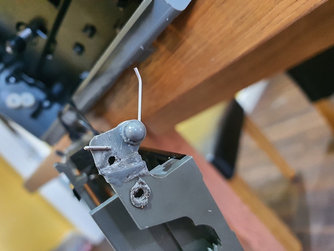

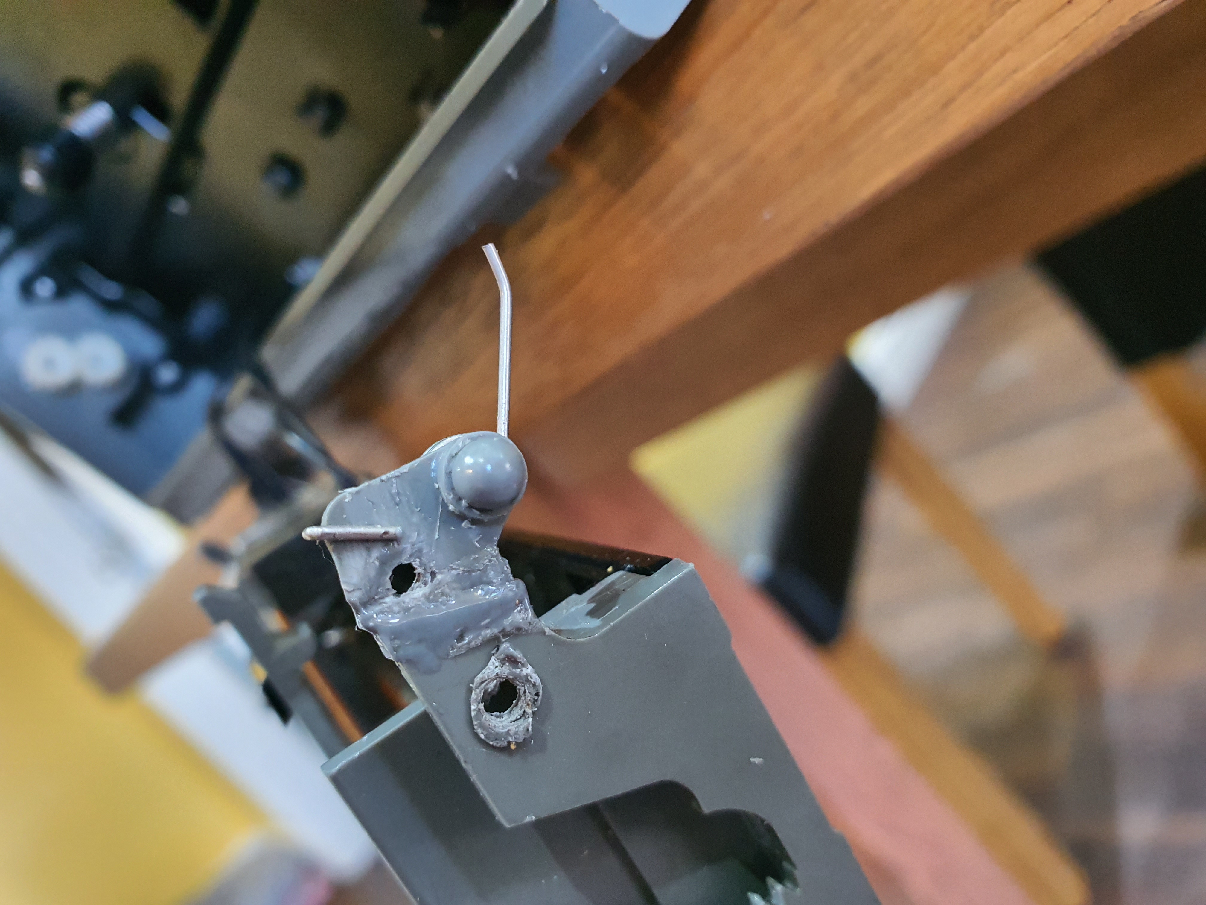

Hi Richard, thankyou for casting your eye over it! :+1: Its just arrived, very well packaged and there is not much in the way of a manual :rofl: From what I gather, a “half” press of button one, followed by full press of 2,3 and 4, gives output to all speakers? Not sure but won’t be meddling with it. Don’t want it where all 4 amps output simultaneously :woozy_face: I’ve enough on at the moment with the last casseiver I bought. Decided to have another go at it. Bought some JBWeld to try and fix the door hinge, not pretty but hopefully it will bring the door back into alignment :nerd_face:

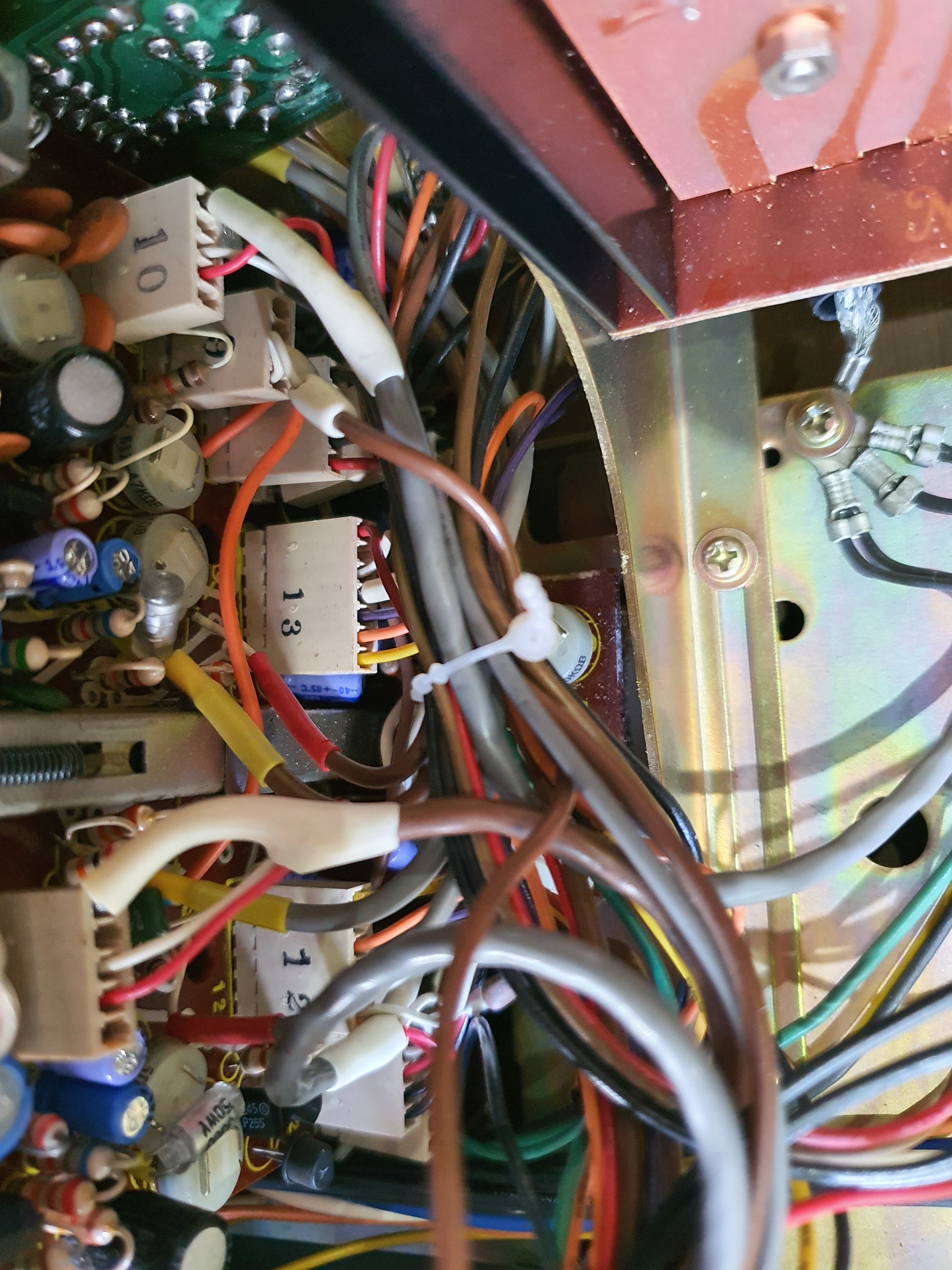

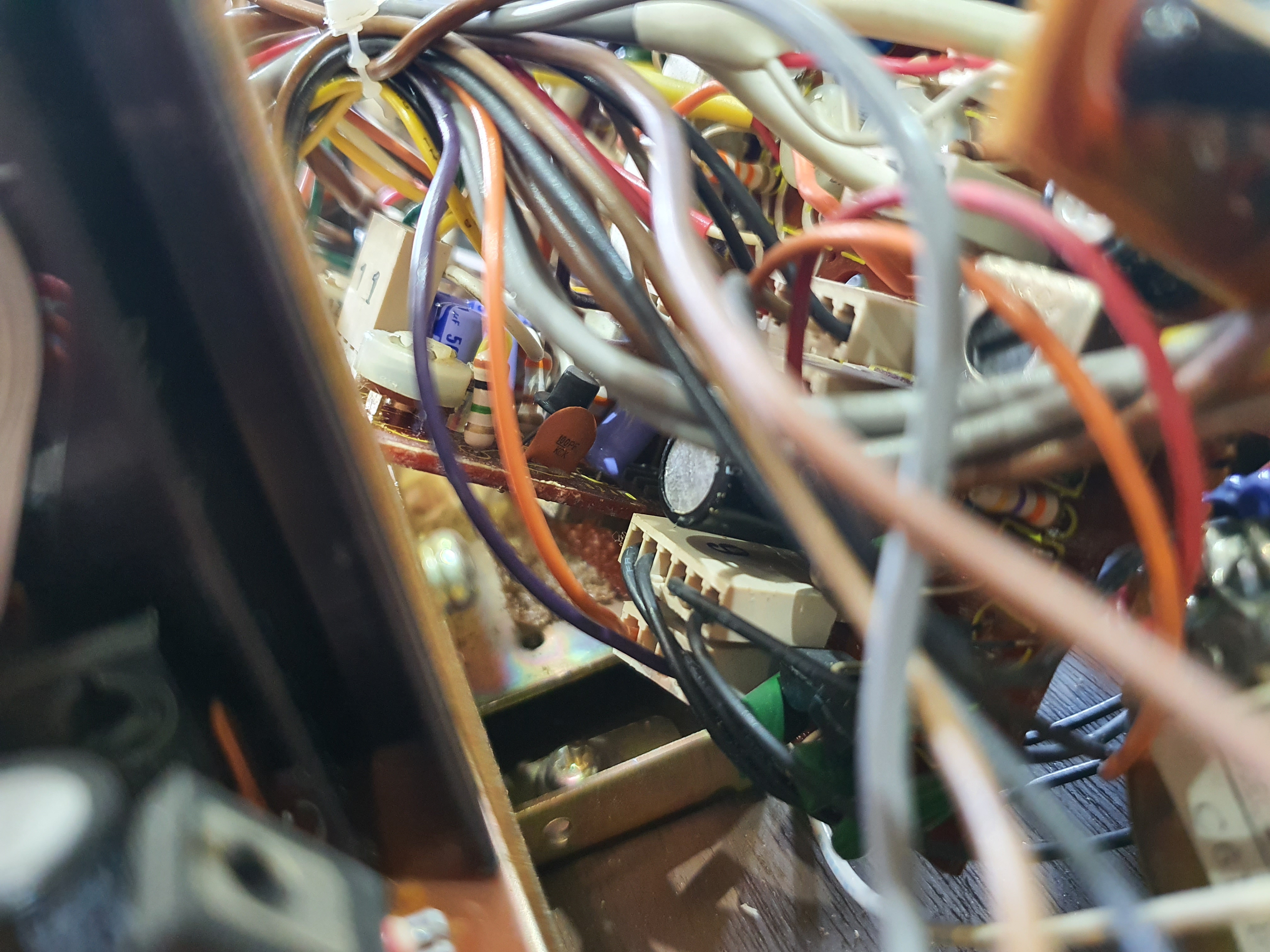

Interestingly, while doing this,

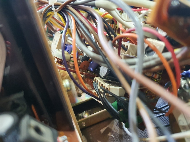

I discovered an unconnected 3 pin connector on one of the boards? Took a while to find its location in the nest of wires, it goes here (the lower plug with the orange wire showing)
Fingers crossed it has some bearing on the non functionality of the unit. I can but hope :crossed_fingers::crossed_fingers:
No less than 13 multi pin plugs on the one board at the back of the cassette mech!

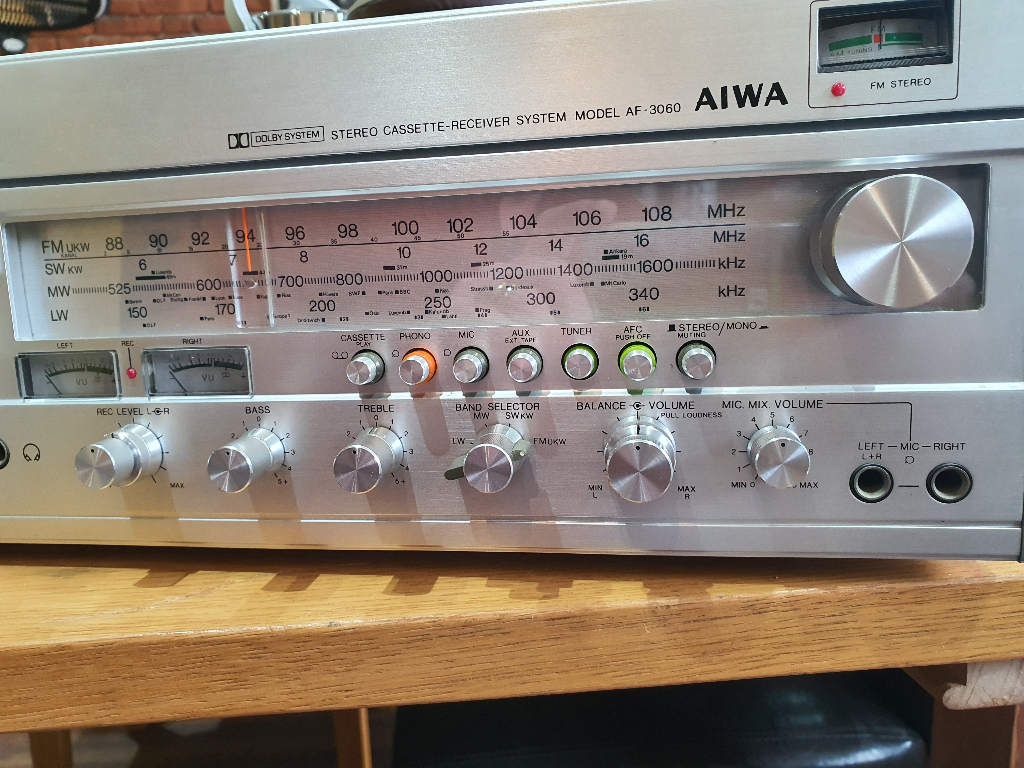

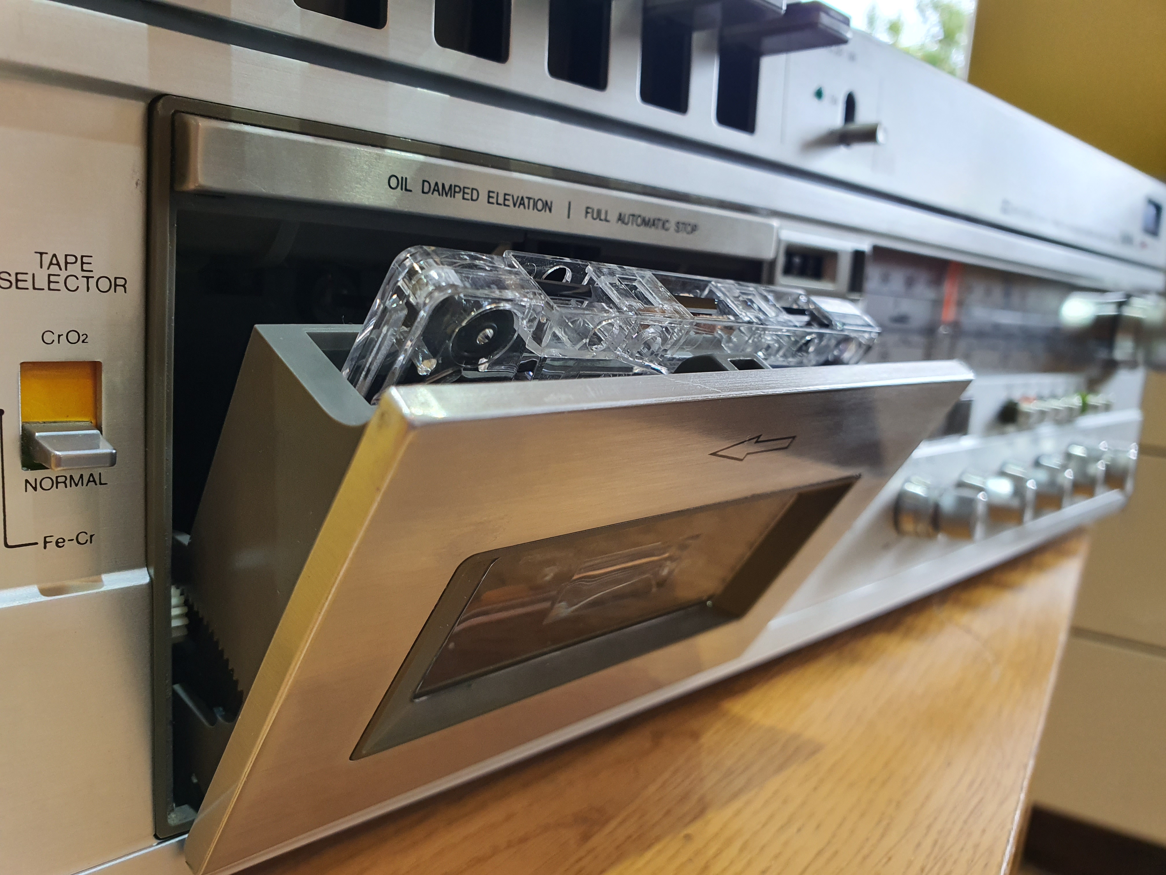

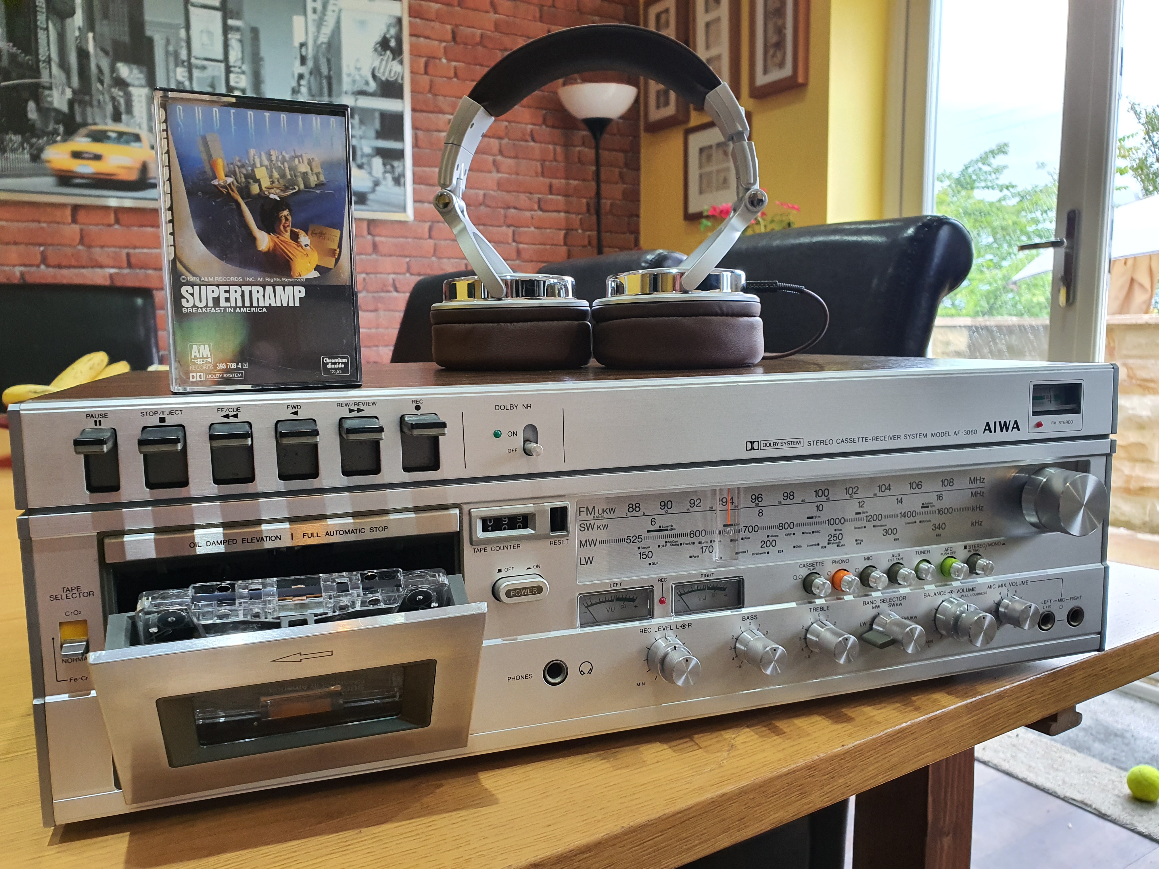

Cassette mech still out on the table but I just thought I’d try and see if there was any life in it after reconnecting the loose plug and while waiting for the JBWeld to do its thing. No speakers available so connected my headphones via the front 1/4” socket. Plugged in, switched on and now there is a hum! Massive step forward compared with my previous sound of silence! :+1: not much else happening though, with FM selected on the tuner, even without an aerial, I would have expected to hear some output. Scratchy pots/switches abound now that I can hear something though :rofl: will get the contact cleaner involved shortly.
All back together but no success :worried: listening to the hum, bass, treble, balance, loudness all work (listening on head phones) when first powering up, the VU Meters flicker, same when switching off. Pause and eject buttons work but the others are solid. No change when moving radio bands and tuning meter doesnt move. Front panel lights up, dolby indicator light works, stereo light doesn’t. It’s a shame as cosmetically it’s very nice! Anyway, to cheer myself up I’ve bought another AIWA AD-6600 cassette deck ( same as the one I recently purchased and an AIWA AX-7600 tuner amp, model up from the AX-7400 I already have! :sweat_smile::sweat_smile::sweat_smile::sweat_smile:

Sounds like a power supply problem. I would guess that the high load stuff like the power amp and panel lighting are powered by an unregulated supply while the preamp and tuner sections are on an unregulated supply which isn’t working.

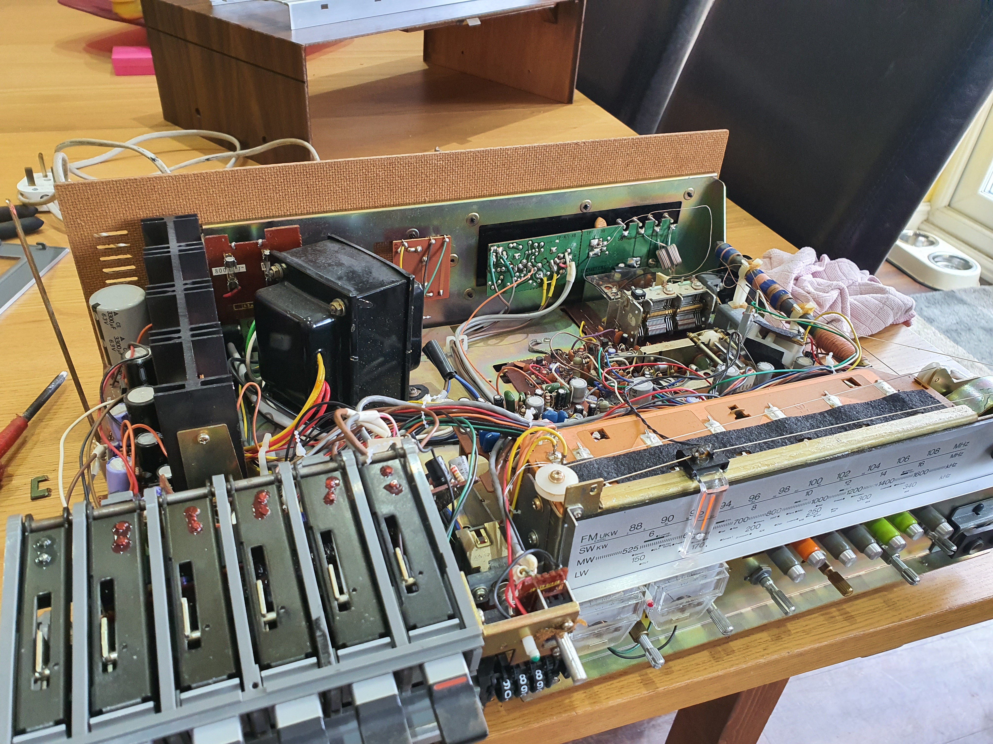

Thanks for that Paul, TBH, its beyond my pay grade! Heres a couple of pics of it on the workbench, sorry dining table :nerd_face:
Back to being a prop methinks.

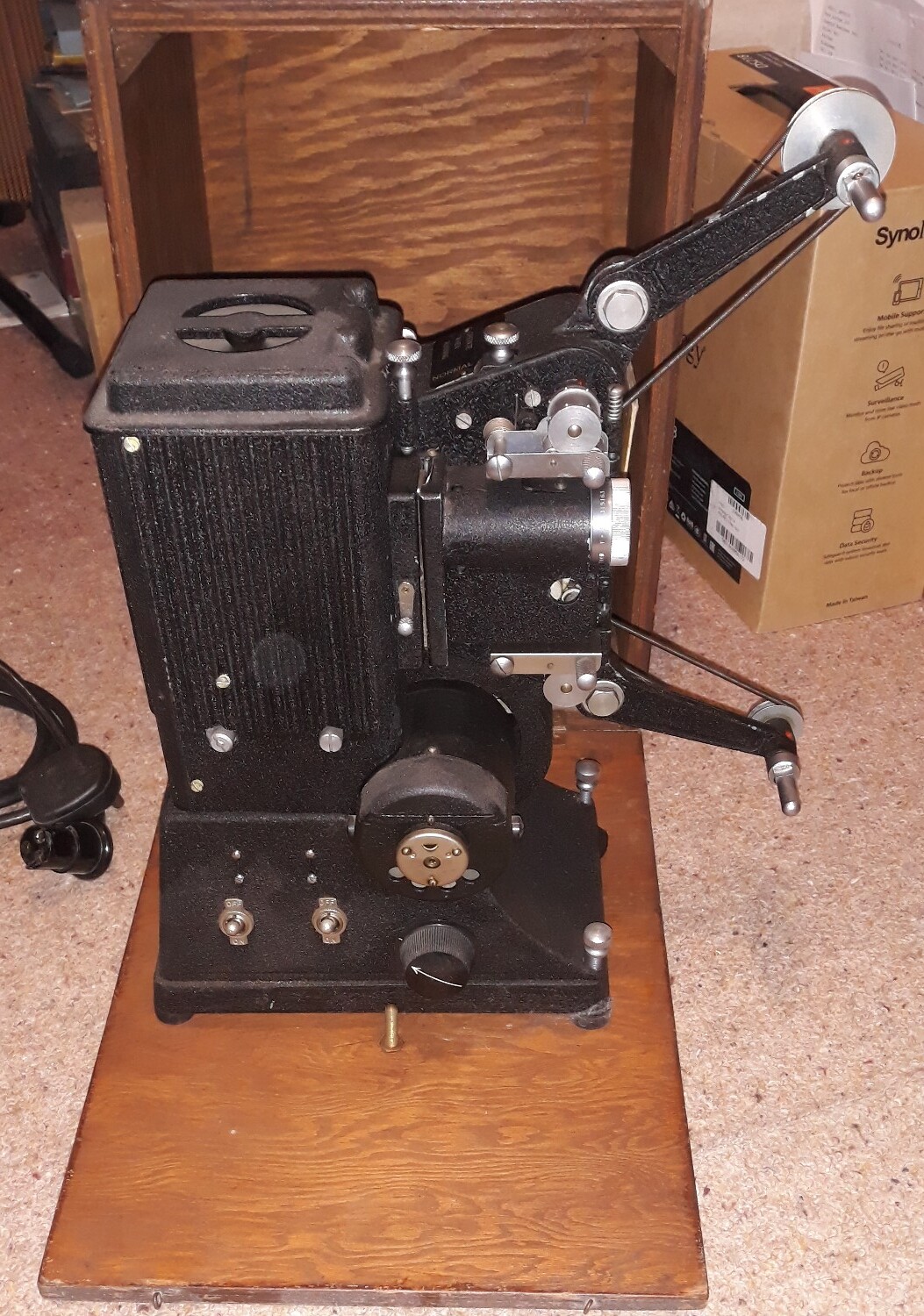

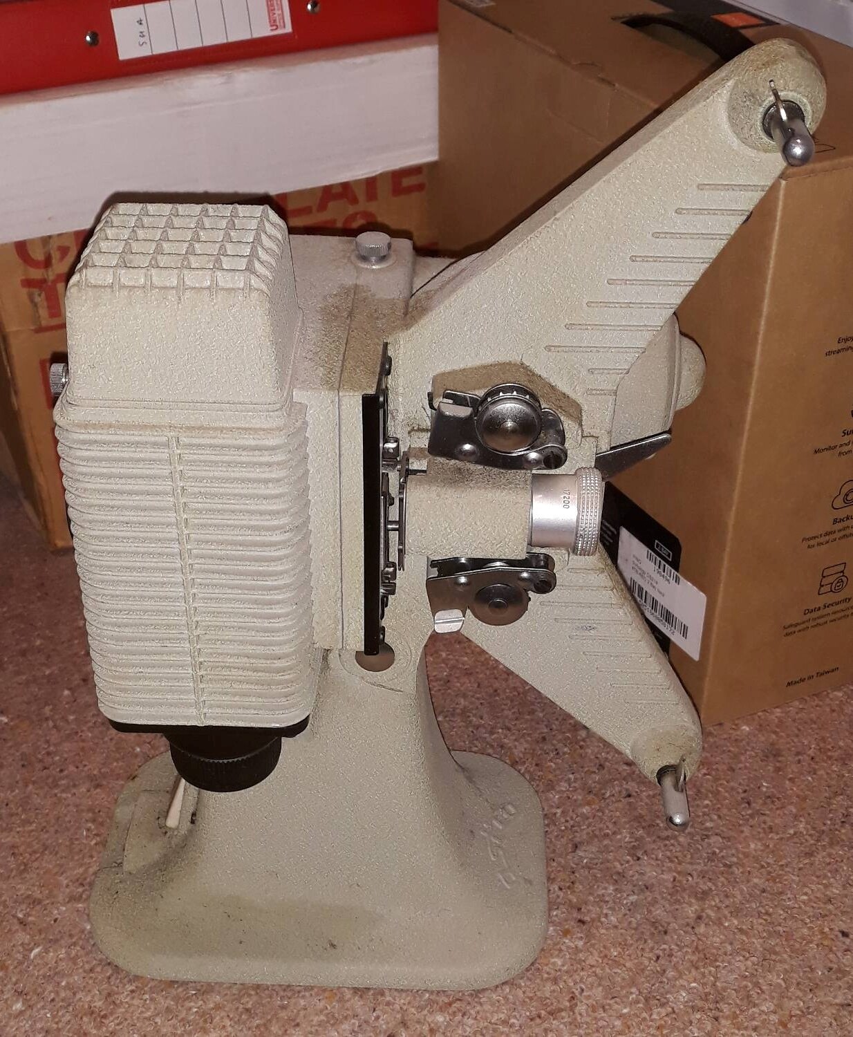

Back in the old days of home movies, Dixons sold this Astro 8mm projector, I even have its original faux leather zip-up carry bag, handles are OK not so the zip… It still worked forty years ago, and I rarely turn down a gift I can use.
For better quality people upgraded to 9.5mm, but it did not take off in the same way as the 8mm, and this Specto was one of the better projectors, even has a proper box, but I was not given a take-up spool and I don’t know if it works, it came with the free 8mm.

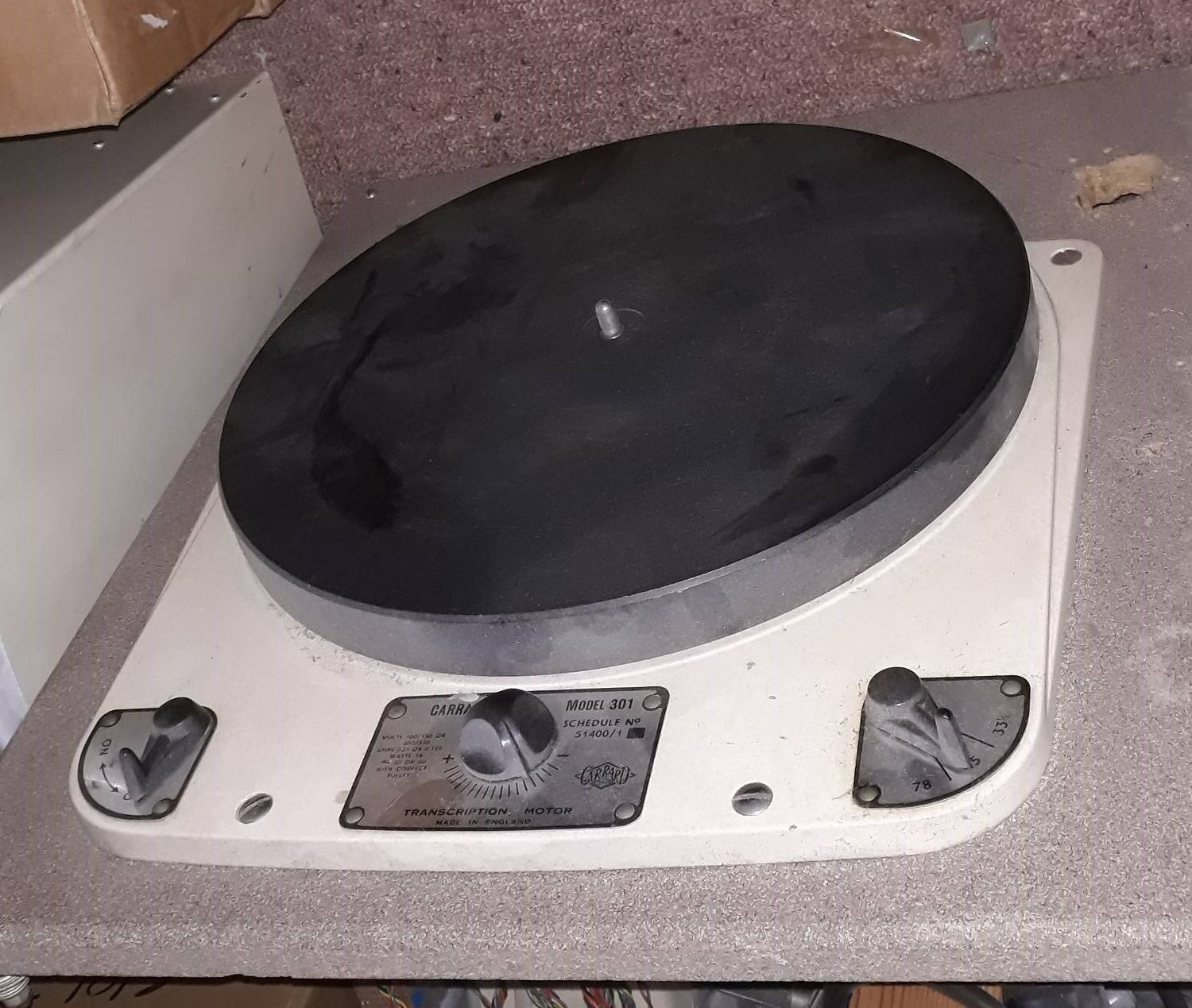

Contemporary with these was my first 301 deck, note the basic plain turntable, no milled edging, and the layer of dust.

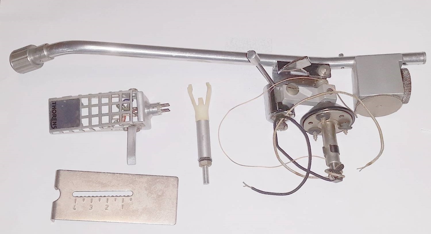

With my other 301 I was given an arm supposedly by Thorens, but no markings on it and no non-standard head-shell, and I’ve never used it. Update. another memory failure; I’ve found another little box with Thorens head-shell, armrest and tracking gauge, and the user instructions for a TD150.

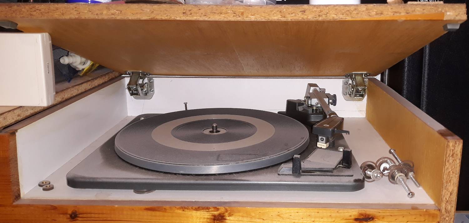

So Hon No1 Daughter’s hifi used one of my Garrard SP25 decks with a Goldring CS91E cartridge, now very dusty. I notice I ‘temporarily’ (twenty+ years ago) put the suspension springs there from the second 301 when I redid the living room and solid mounted it instead.

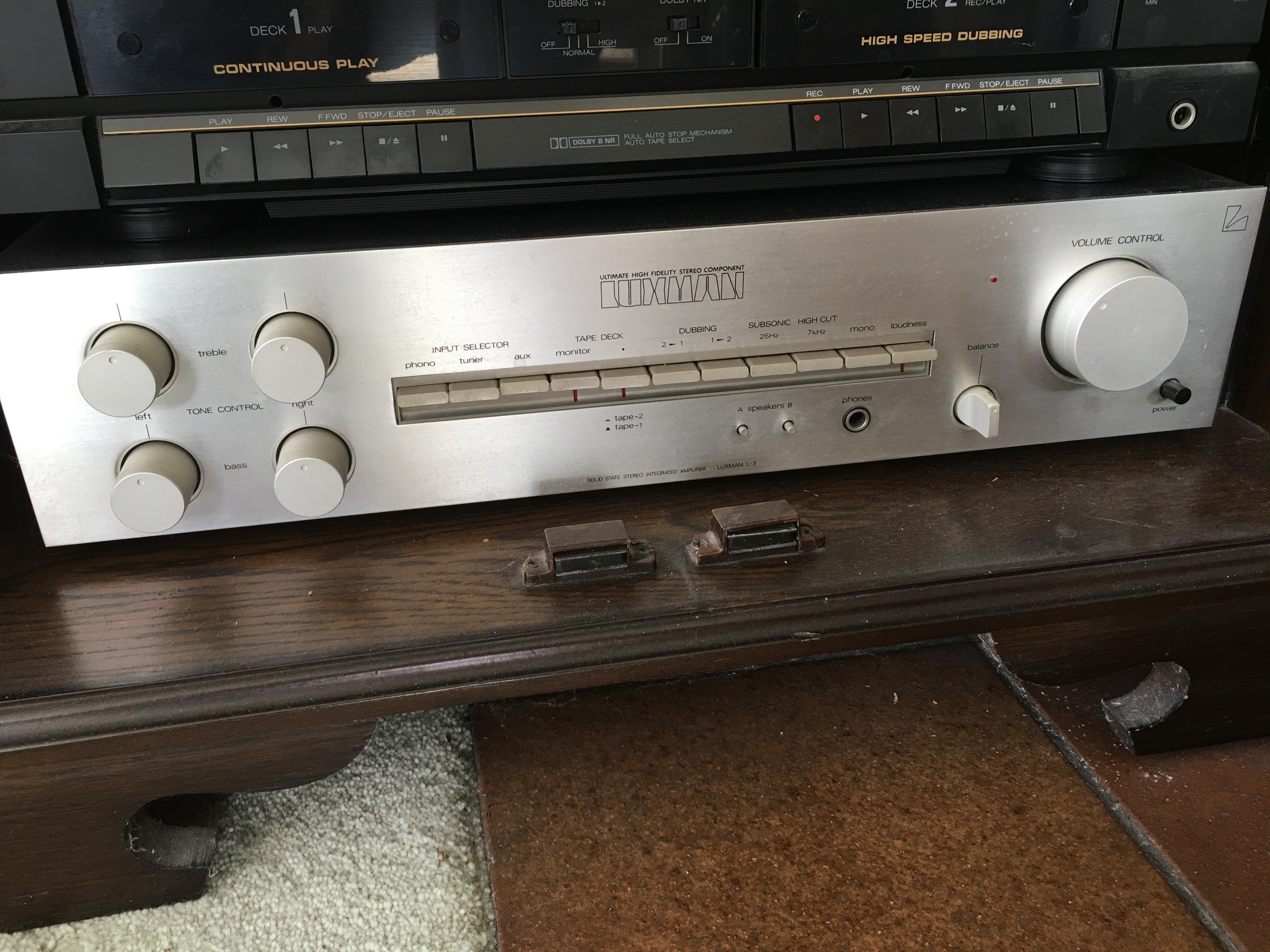

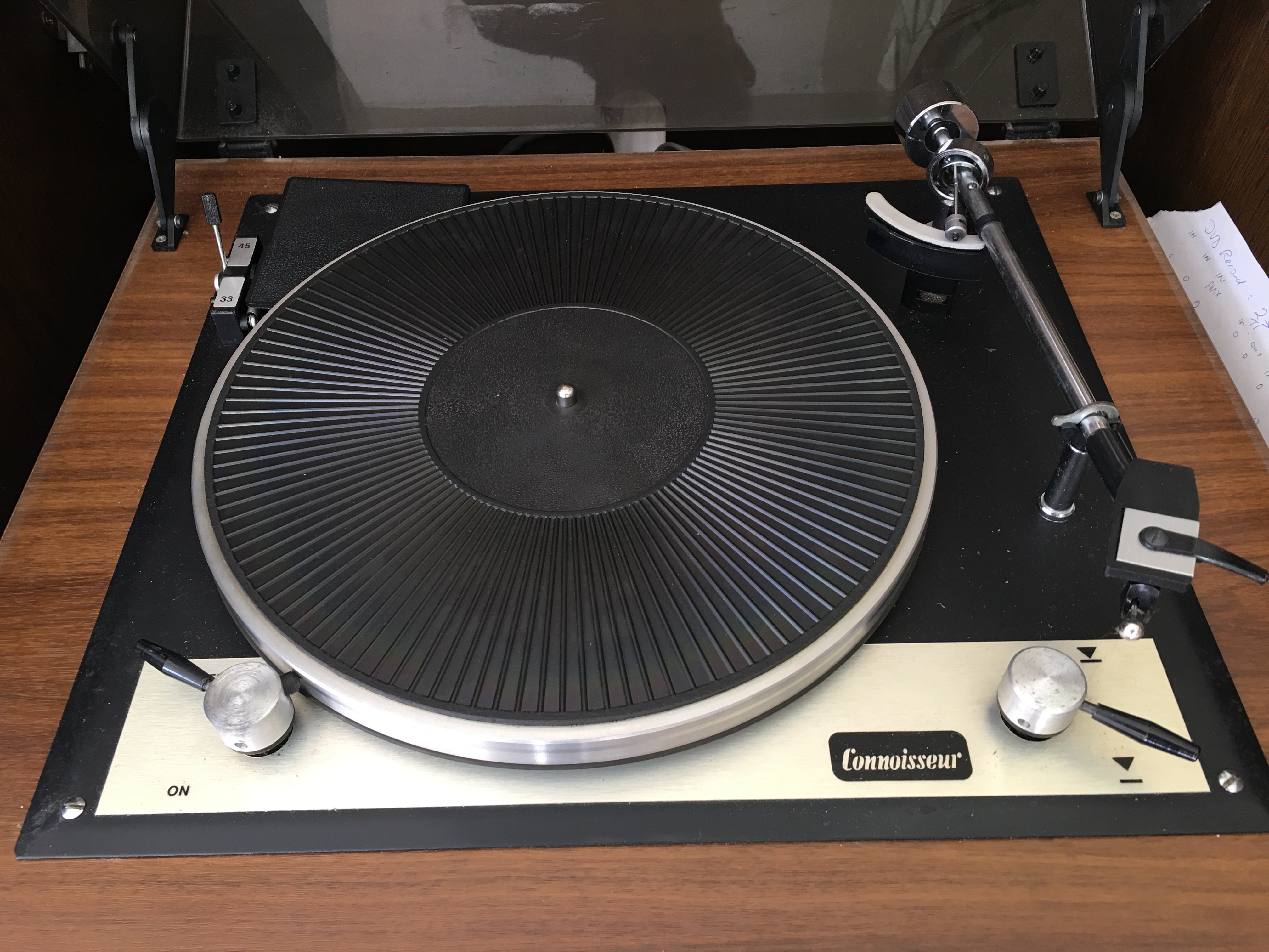

I don’t actually collect Hi Fi equipment now but used to be an enthusiast and thought I’d share a couple of photos of my Luxman L3 amplifier and Connoisseur turntable. Both bought in the early - mid seventies and both still working perfectly.

Excellent! Looks lovely! Personally, I just accumulate stuff, not really a collector, although LEAK and AIWA are my main passions. :nerd_face::nerd_face::+1:
Really like the separate tone controls for L/R channels, very nice indeed.

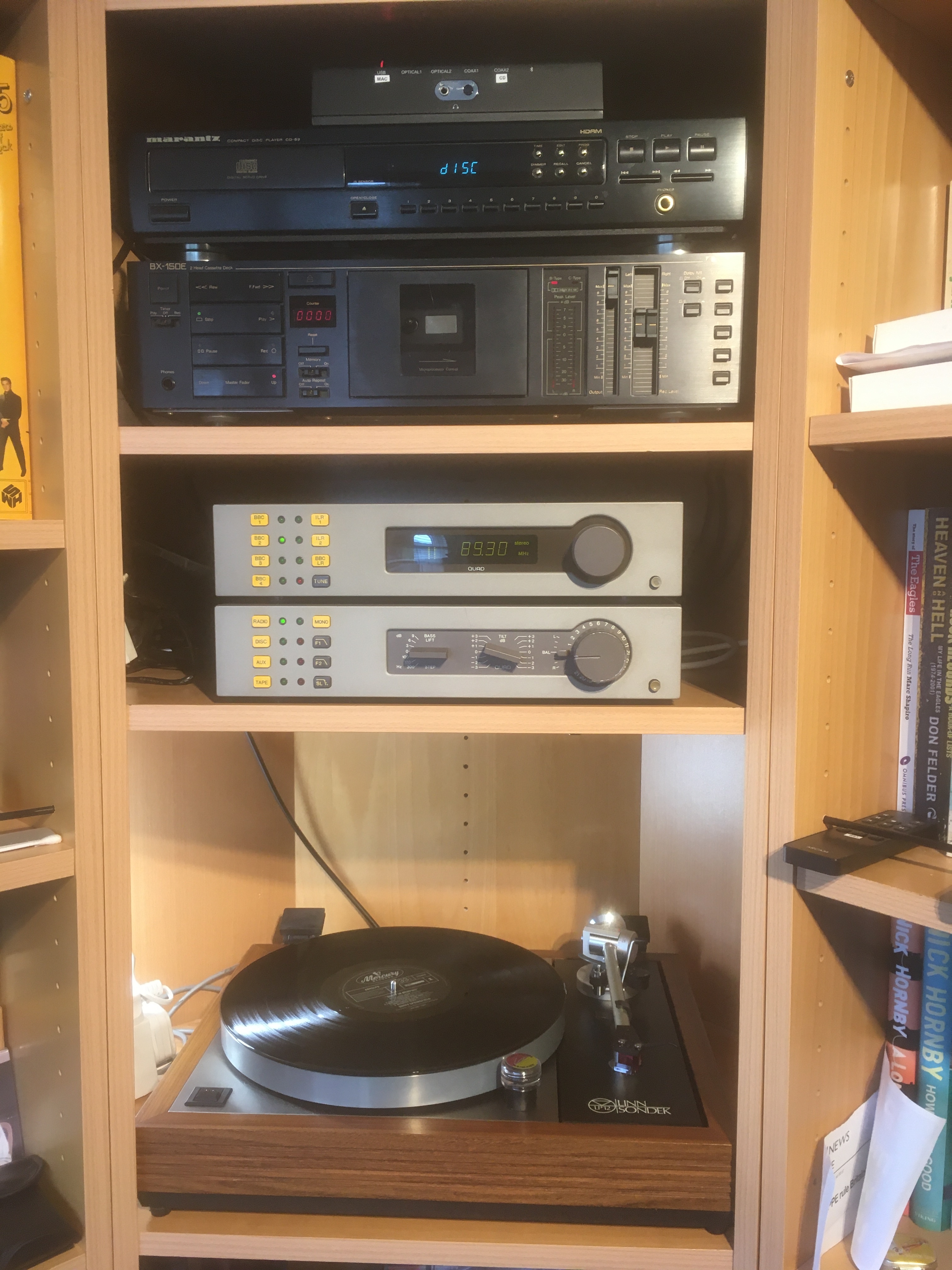

Just thought I’d share my 1980s kit still in daily use.
I’ve just completed a service rebuild on most of the items.
The Marantz CD player has a new laser assy fitted, the Nakamichi cassette deck new belts and relubed, the Quad pre-amp & FM tuner had most of their capacitors changed (they leak and eat away the PCB tracks!) plus op-amps.
The Linn LP12 I completely rebuilt with new suspension, Cirkus bearing, sub-chassis and S/hand Ittok arm.
Not shown in the photo are the Meridian M3 active speakers which also had their electrolytic capacitors changed. If it all works for another 30/40 years it will outlive me!
The only modern kit is the Arcam rDAC on top which gets a usb feed from my iMac for digitised stuff!
