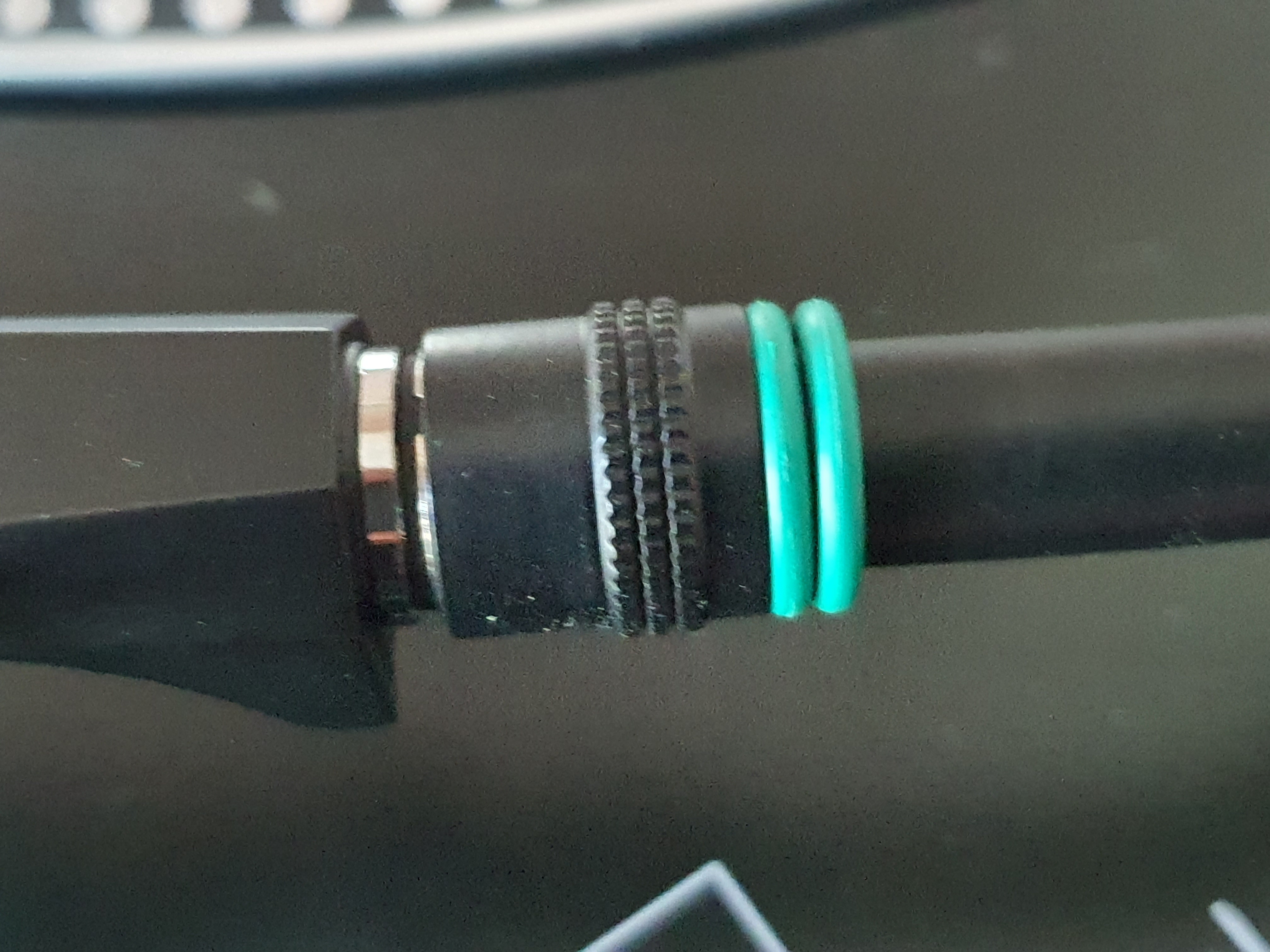

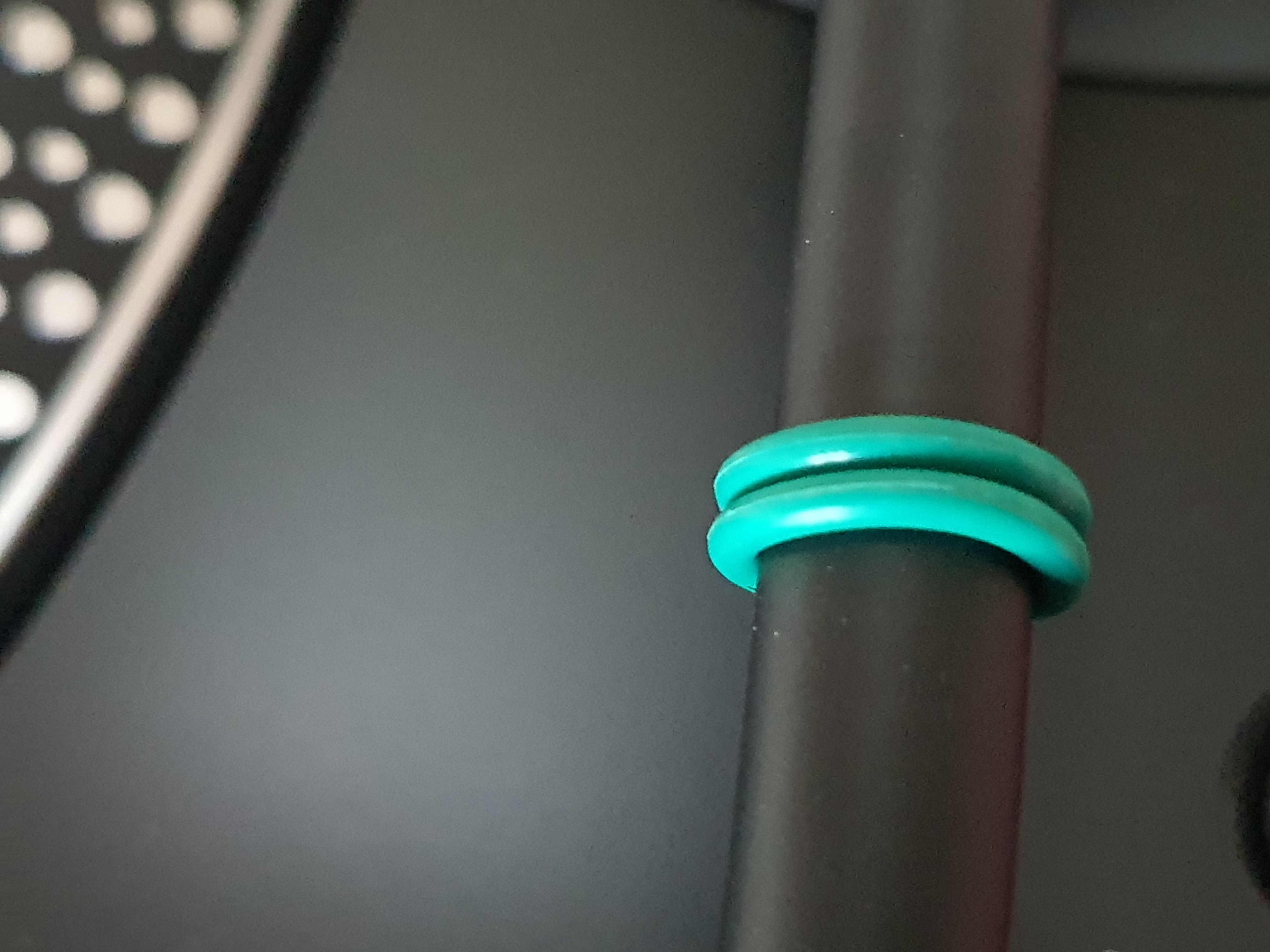

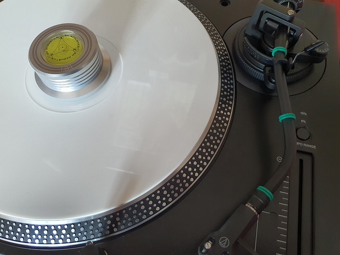

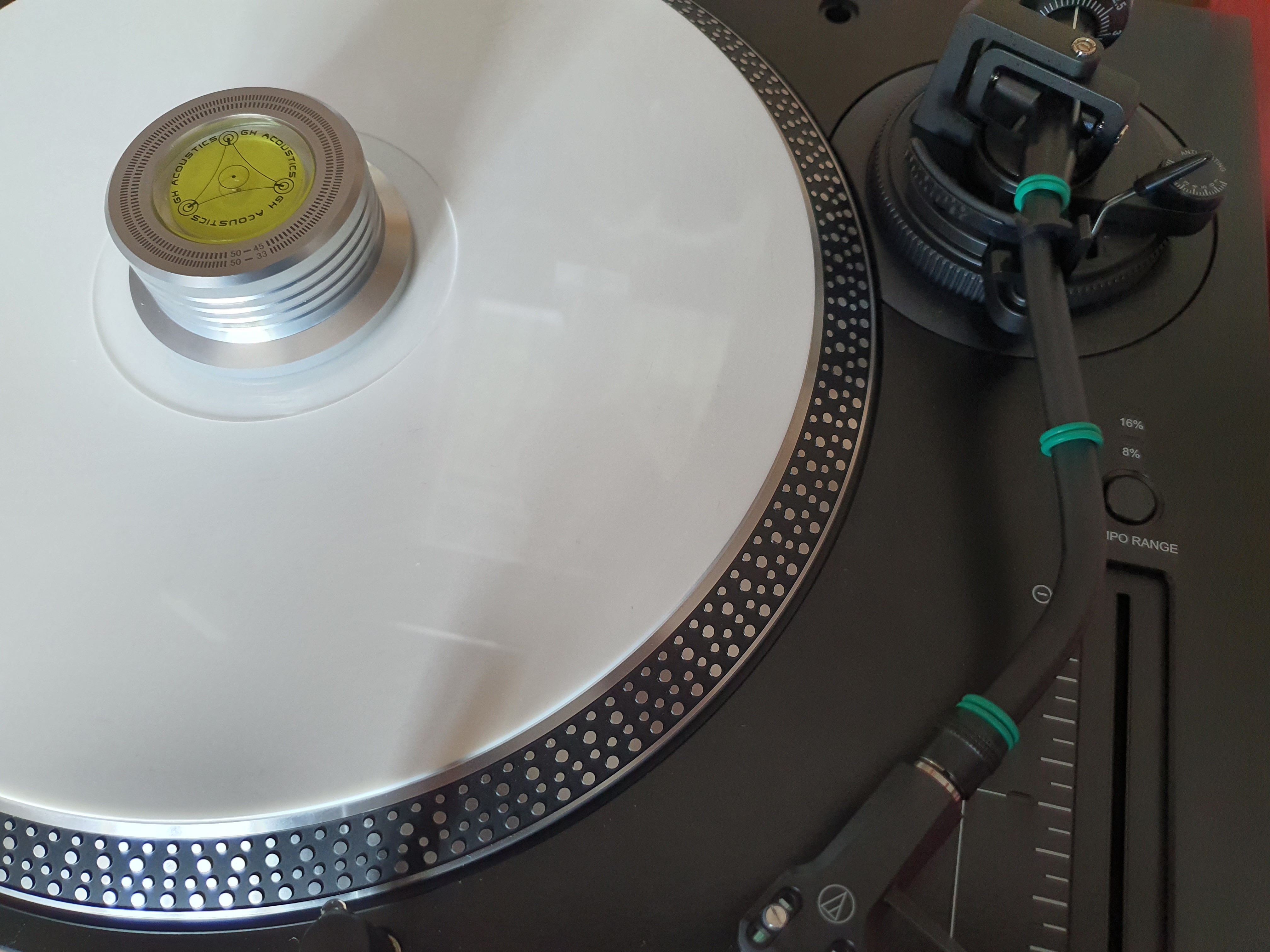

I recently posted about resonance being picked up (possibly) from the new AT-120 TT. I bought new speakers on stands, relocated their position. Placed some foam sound deadening material under the platter. Set up the TT properly and bought an acrylic platter mat too. All sounding great now so it could have been any one or all of those things that have improved and eliminated the resonance detected previously. I mentioned about fitting some 0 rings to the tone arm too? So I’ve just done that but not had chance to test yet. Heres pic’s of what I’ve done.
Thought it easier to illustrate them in a green colour, might swap for black colour.
If you are worried about tone arm resonance, there is a simple test, the Tap Test. (Think of a guitar string.)
Raise the arm with the lifter as usual so nothing is touching it or the stylus, then tap it very gently with the shaft of a small light screwdriver while listening to the output from the speakers. If you can hear anything it is the arm resonating enough that the inertia of the stylus tip produces an output. I would expect nothing though.
A lot more careful now, rest the stylus on your tracking gauge or similar and again very, very gently tap the arm at different places along its length. If it is loudest in one spot (not nearest the pickup), that is the place to put a damper band or two. If no difference along its length other than steadily getting louder closer to the pickup, then the arm is not resonating.
But I would not expect the arm to resonate.
However, the turntable platter itself is another matter. Think of a saucepan lid, how much that can ring-ting-ting if it is a stainless one, and how much less an aluminium one does. The Tap test works here too, no stylus needed just the plastic handle of the small screwdriver! It should be dead, if you can hear a consistent ping or rumble it is probably those frequencies coming through the stylus as well.
The chassis is the other place, if it can flex or ring enough to introduce vibration between arm and turntable platter. Again it should sound dead, which is why high-density chipboard was so popular in the past when an SME arm (etc) was separate to the turntable system.
A mechanics stethoscope (long thin pointed Phirips screwdriver, handle in the ear) on the moving turntable and chassis can also pick up a lot of clues depending on where it is touching.
On my ancient 301 + SME system I used 1" engineered-wood board with cross bracing underneath. This board then sits on three battens bolted to the walls of the bay in a U shape, with a draft-excluder foam cushion between board and battens. It is very dead, only the biggest HGVs hitting a pothole at speed in the road outside come through, but then they shake the whole house as well.
Have fun!

My findings are;
Tone arm lifted, an even sound just getting slightly louder, the nearer to the cartridge end. Tapping the counterweight produced a much deeper tone though not part of this test.
I could hear the tap on the tone arm through the speakers when stylus resting.
Metallic sound from platter when tapped but very short lived. Not 'tinging’as such.
Haven’t tried the chassis but TBH, it appears, to my ears anyway, that resonance is now a distant Memory! I followed recommended positioning for the 0 rings on my tone arm from a couple of sites and it seems to be working

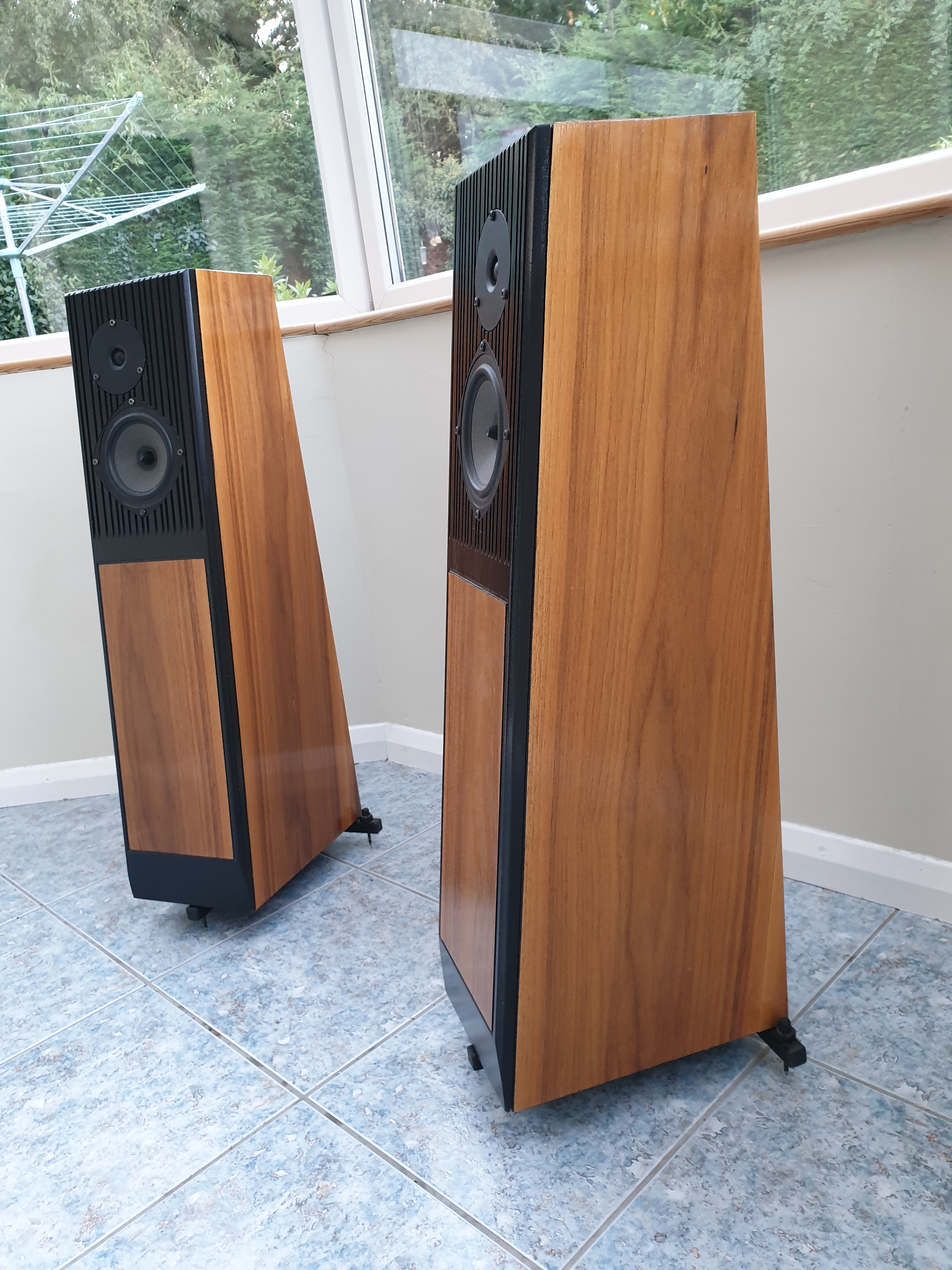

I sold my old trusty Rega ELA speakers yesterday, probably late 80’s or early 90’s vintage. Surprising how much tight, tuneful bass can be generated from a single 5" woofer coupled to a transmission line enclosure, I hadn’t used them for about 7 years, however on hooking them up so that i could demonstrate them working to the prospective buyer, I was in two minds whether I should actually let them go.
They came from the factory in a black vinyl wrap finish, however a few years ago i had my first and only experiment at doing some real wood veneering, i don’t think i did too bad even if i say so myself…
Got a pair of Rega Kytes in another box in the garage, I wonder how they sound these days…
If your garage is anything like mine, no heating or insulation, they’re probably deceased! Pity, Rega models are nice speakers.
This tells me there are no resonances in the tone arm.
I gave you the clue with “Think guitar string” but carefully resisted the temptation to tell you to listen for harmonics, this as a “blind test”. If the arm had any resonances, then tapping it gently in the acoustic middle (likely also the physical middle) would have given you second harmonic on the fundamental resonance, a third of the way along, third harmonic, etc, just like on a guitar string.
But since the only different tone you heard was on the weight, it showed you were aware of different tones, and since there were none there from the arm it is a “Good Result.”
An S shaped arm has a slightly longer mechanical length than the distance from stylus to pivot, so is effectively tuned slightly off-resonance.
My old SP25 arms were straight, and Garrard made great play in the advert for the balance weight being rubber mounted with elasticity carefully tuned to damp out resonances. I never noticed one way or the other, but the rumble was truly awful, and I fixed them with grade 5 precision caged thrust bearings instead of the rough old things they were supplied with.

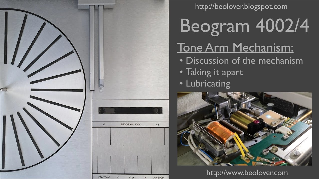

Now have a look at someone repairing that tone arm mech (4002/4 but still the same in essence)
