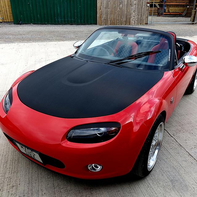

Many thanks for all the helpful replies and photo. Will folloup asap. best wishes, Gerald.
Sorry Barrie, couldn’t resist…

All you need now is the chrome trim rims to finish them off !
