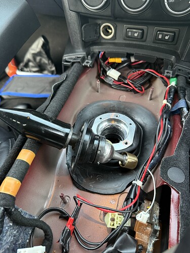

I found that my recently purchased NC was having trouble shifting into 1st and 2nd gear.
I replaced the reverse lockout plate, and upgraded the plastic gear bushing to a brass one, and that’s made a noticeable difference.
May change the transmission oil for good measure, but this an easy low cost mod that works.

Does the lockout plate issue only effect the 6 speed box ?
My NC is 5 speed
Yes - because reverse is towards the driver and back on the 5 speed so it is no where near the 1st/2nd shift.
Don’t know, sorry, as I’ve only ever had 6 speed ones. You’d notice if the change into 1st and then into 2nd became a little fiddly.
DOH how daft have I just made myself look :rofl:
No such thing as a daft question.
Coming from a training background - I would rather someone asked what they wanted to know rather than assume something.
I believe even us 5 gear guys can still do the brass bush swap though…so I’m sort of half involved with the topic :rofl:
