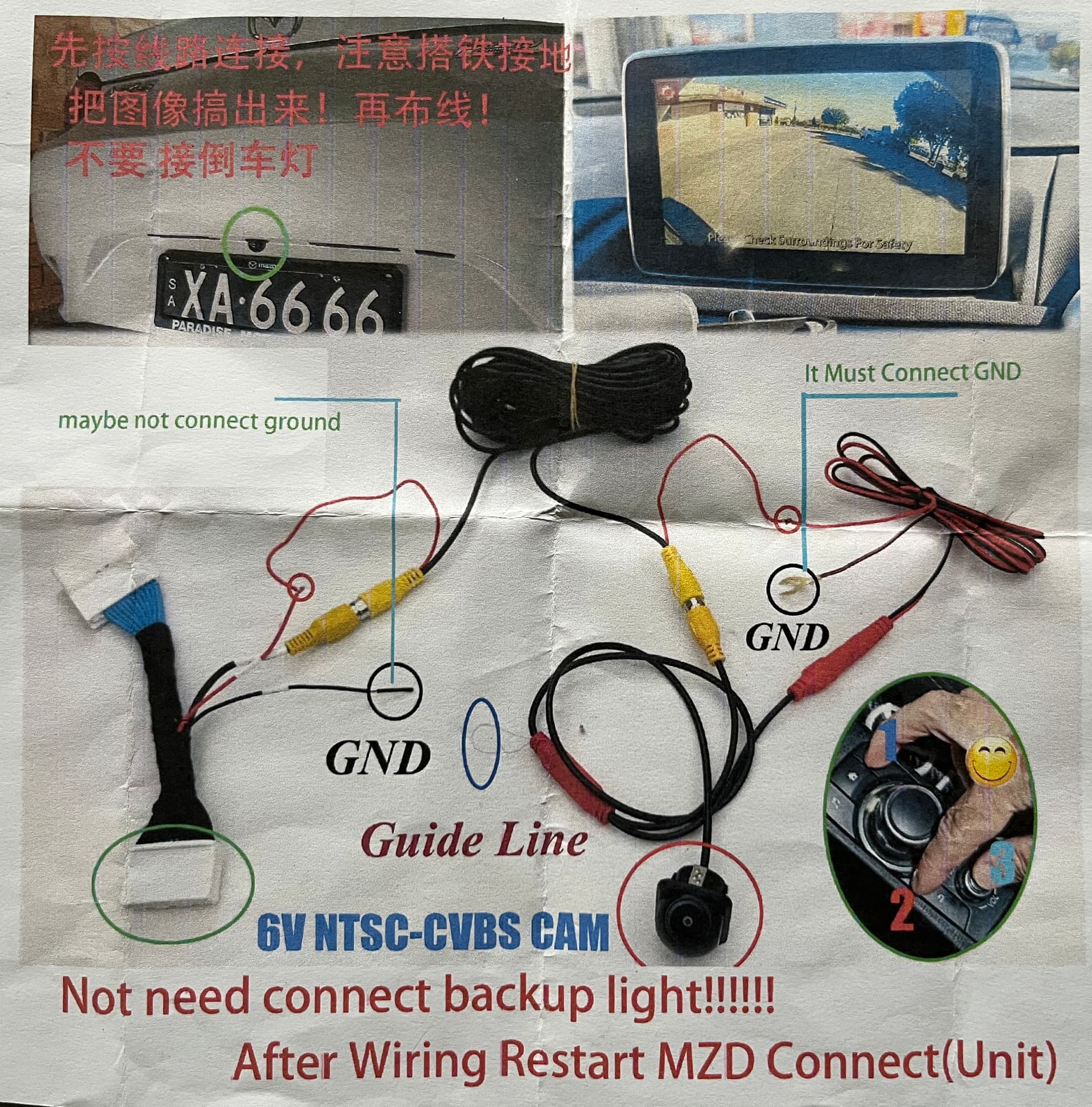

The kit needs to connect with a multi-pin adapter on the back of the MZD head unit.
I haven’t seen any kits on AliExpress that do this. A universal type kit that shows a connection to the reversing light won’t work.
If you add a link to the AliExpress kit I can tell you if it will work or not.

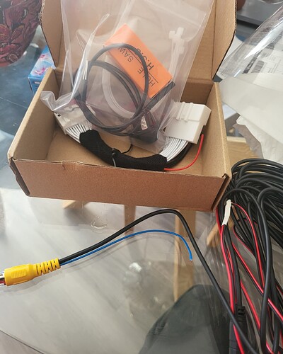

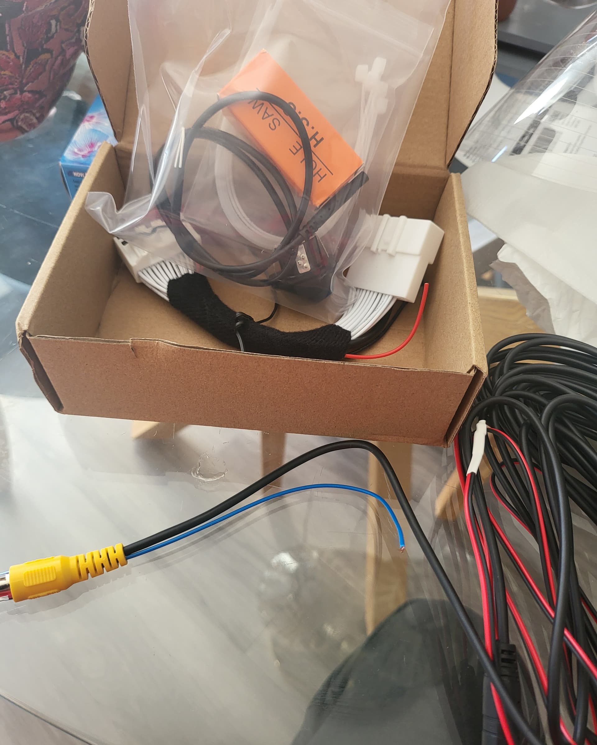

Hi there, so the kit has arrived, all looks good apart from there is a short blue un terminated wire coming from the yellow video plug, doesn’t seem to be any reference to this in the photos, any ideas? My guess is that the cable can be used with different kits and it’s not used, but only a guess, any help appreciated
Just spotted this post. I bought an Aliexpress one some time ago but only fitted it recently - I did a brief post about it. Good value for money, easy instal and works perfectly. On mine the wire you refer to was red and connected to the red wire of the twin core cable.
The extra wire is indeed used as a power wire in some kits. As your kit already has red and black leads on the adapter and the front to back cable just connect these together. Ignore the wire on the video plugs. No need to connect anything to ground (chassis).
If the system doesn’t recognise the camera after installation reboot the MZD. With the ignition on hold down the mute, nav and back arrow buttons on the centre console for around ten seconds until the screen goes blank. Wait for it to reboot and then select reverse. Image should then come up. No need to have the engine running for this, just ignition on.

Not 100% sure what you mean by the harness having opposite plugs. Comparing your adapter with the ones I used everything looks the same, just looks like the pictures of the plug and sockets are the other way up.
The camera connector is different from the ones I used.
Either it’s a faulty lead or faulty camera.
The output from the MZD is 6 volt so should be a 6 volt NTSC camera. Not very common, I used 12 volt cameras and built a step up converter into the adapter.
