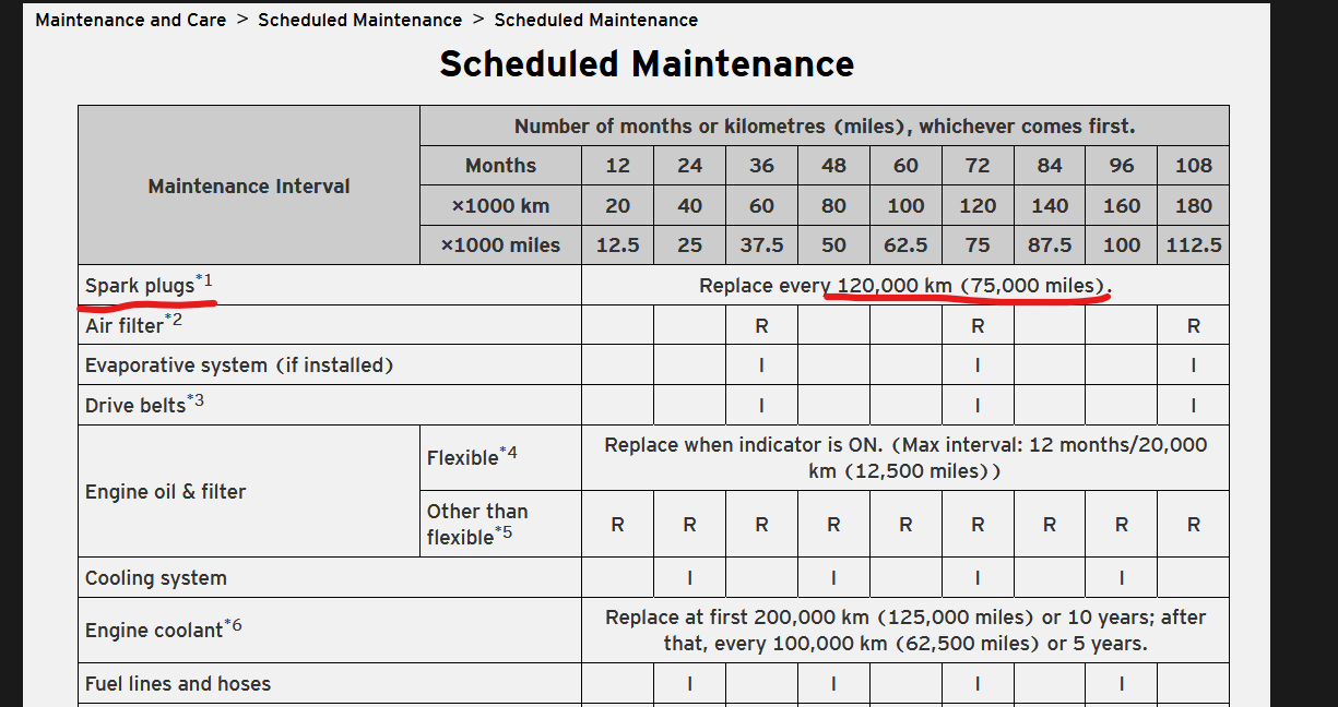

Some dealers seem to be trying this on: Spark plugs on the ND are not time related, but 75K miles replace. SO unless your car is on 75K miles, or expect to do so soon?
Europe MX-5 ND schedule:
Maybe ask you dealer to read the manual, if it isn’t anywhere near 75K

And, as @ND12 said, certain aspects are not age dependent but mileage however dealers just lump everything in together. The 6th service, if also doing the estimated annual of 12.5k, would require spark plugs but as you are not close to that I don’t see the requirement.
I did have previously shared this screenshot of a price breakdown for services on NDs:
Prices may be marginally out of date
I am curious how they have reached £625 when, even with spark plugs and a £100/hour labour rate it should only be ~£410!

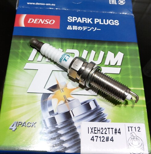

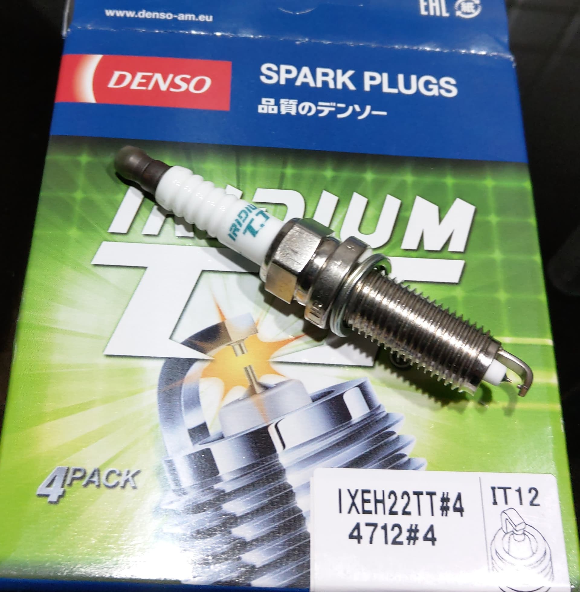

£95 for spark plugs!!
These are far cheaper
